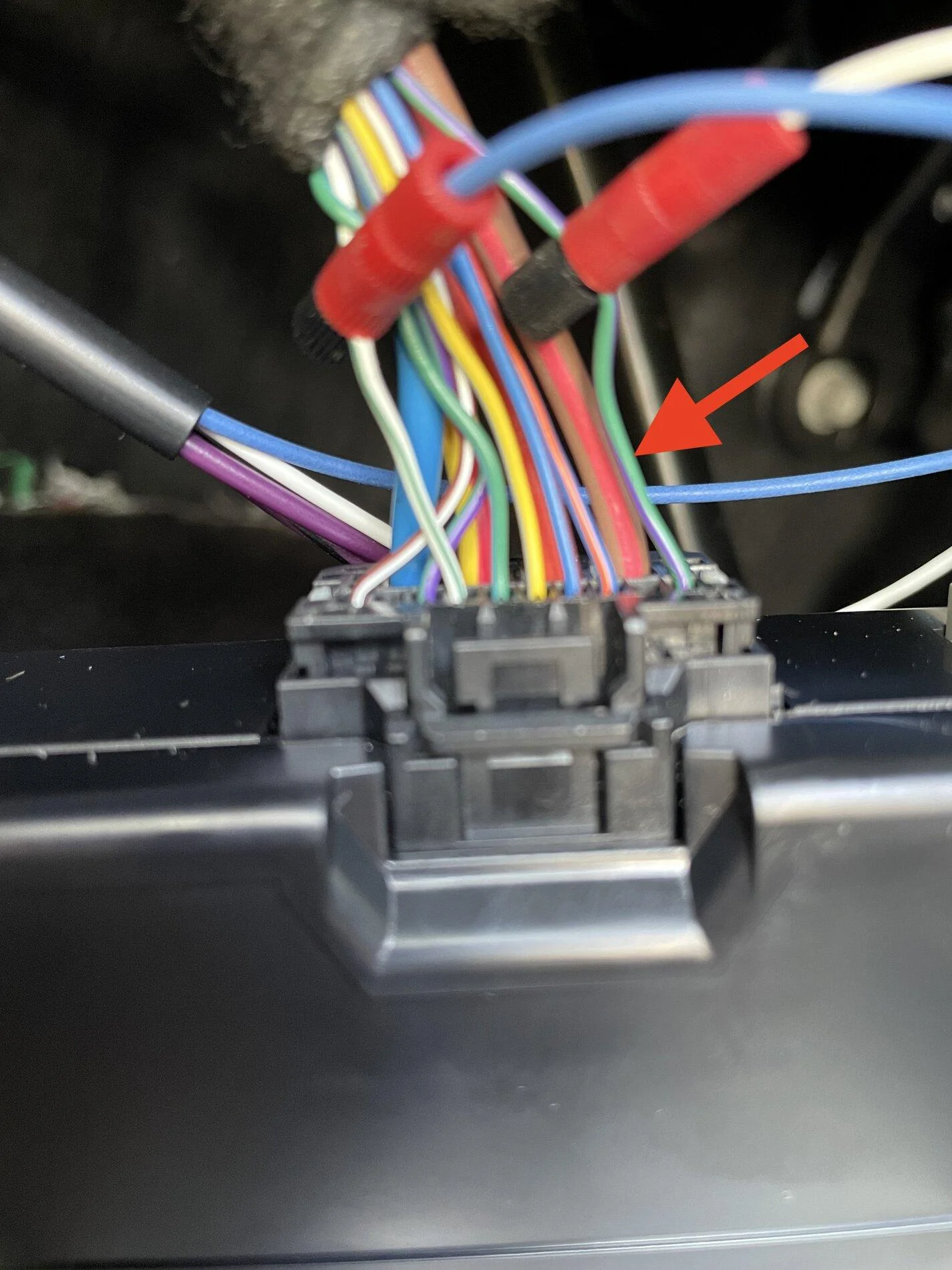

OK I installed the AMP ‘XTREME’ power steps today. They seem to be back ordered at most places, but P3 Performance Products had one in stock for me, shipped it quickly and it arrived within 3 days.
Install is pretty straightforward, except a few minor areas to watch for:

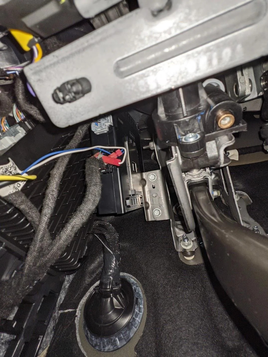

  1. Unlike previous year models, the 2021s require you to splice two wires into the factory canbus (previous year was OBD only no splicing was required). The difficulty is locating the darn wires to splice! There are about half dozen connectors in the driver’s footwell and they all have the blue/green and white/green wires that are referenced in the instructions. After trying two connectors and not working, I finally got the right wires in the third connector - it is one of two that plugs right into the ECU tucked near where the brake pedal exits the firewall - see pic below.
  2. You need 2 posi-tap connectors to splice into factory wires (see pic below) and they were missing in the package. I had a bunch in my garage so that saved me having to find them at a local store.

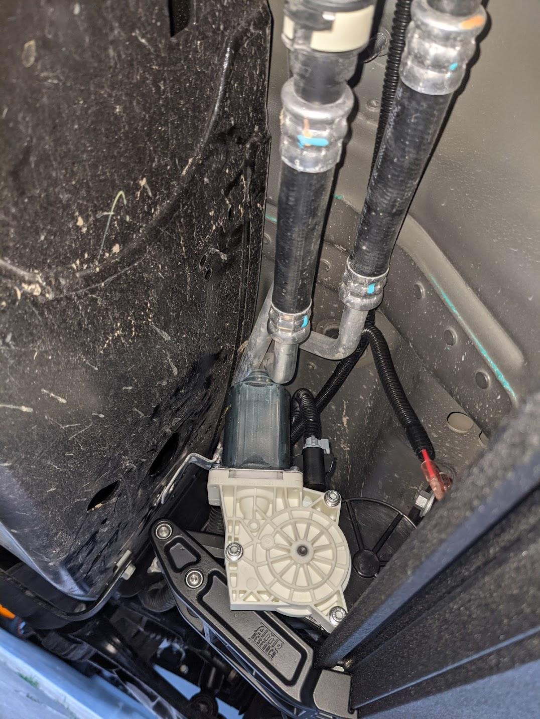

  3. The passenger side motor makes contact with the hoses/pipes that are routed adjacent to the frame In that area - see pic below. Not a big deal, I disconnected one mounting screw that held the hoses on the frame and just pushed the hoses up, but they do make contact with the motor FYI.

Thanks for the info! After time have you looked if there is any wear on the lines from rubbing on the motor? That would be my only concern

Sorry all the questions, it came up in another forum the motor might be able to be re-positioned to allow clearance. did you or anyone with powerboost try that?
No I have not tried that, why would I? My setup is working fine. If I remember correctly, that gentlemen drilled new holes in the step motor and patched old mounting holes etc. Too much work, though that is probably a more complete install if you didn't want to just push the coolant lines up a few inches. The lines you are pushing up are metal lines so I am not worried about wear. The step motor itself does not move up and down so there is no rubbing on the lines.
