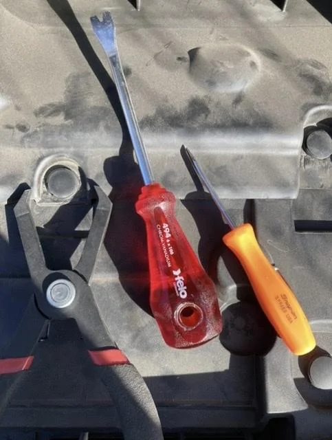

My headlight install was about 4 hours, half of that time though was finding my box of plastic snap connectors and tools (I never did break a snap connector), having to take the valance off a second time because I forgot to screw the lower pair of grill bolts and updating the Fordpass app to find the fuse box diagram for wiring the DRL box. If I had to do it a second time, it’s probably a 45min. job.

Be careful with those four small valance screws in the fender well. I was using a stubby driver and still popped the head off one. Luckily, there’s enough to grab with a vise grip when I get a replacement.
Also, the front camera connector clip was pretty brittle and I snapped that trying to gently wiggle it.
