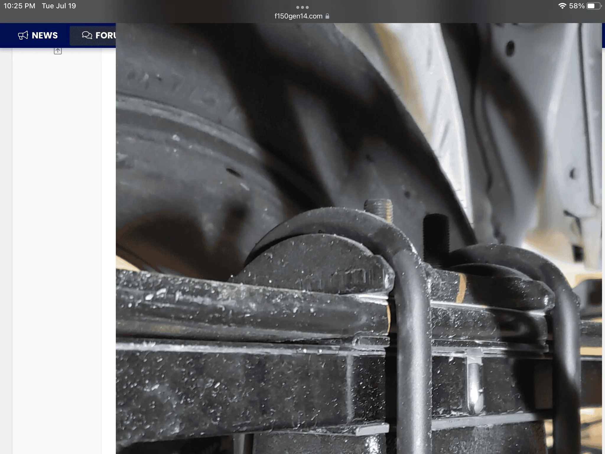

First off take a level and mark the spring studs level with the curved u bolts. Use your cutting tool of choice to trim them, do not cut the u bolts!!

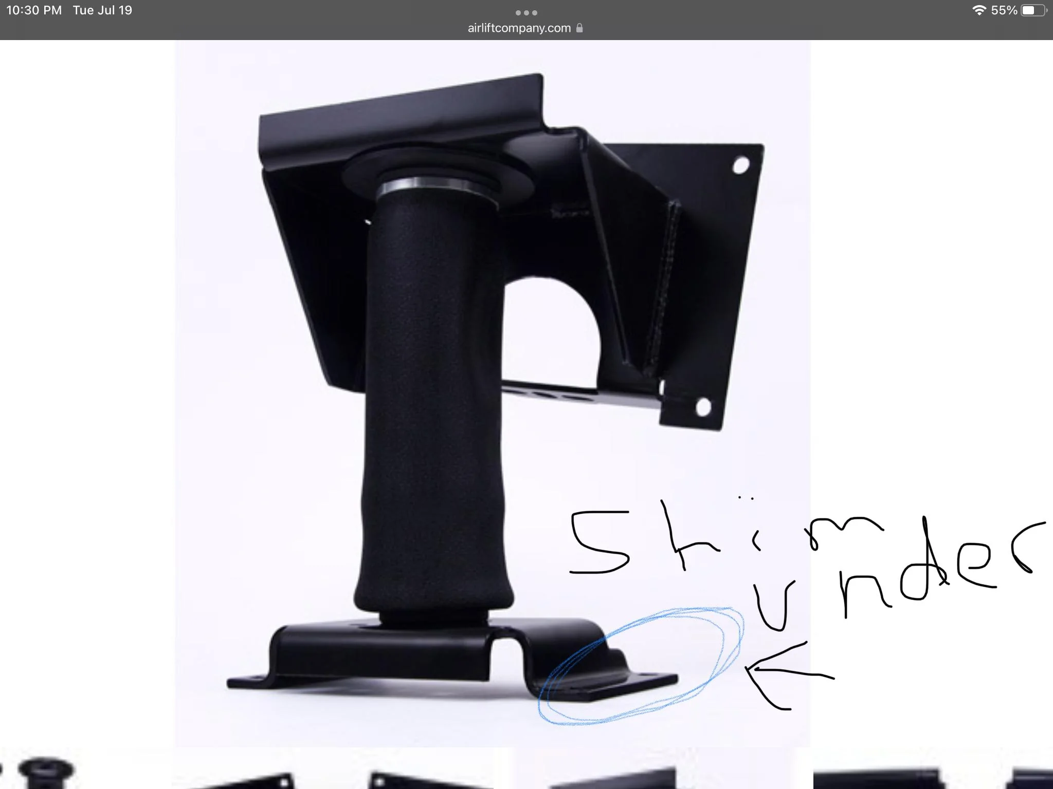

Next when putting the bottom plate on top of the springs you can make a shim to fit under the plate on 1 side.
I had some 1/8 flat bar in the shop so I measured and drilled for the u bolts but this part isn’t really needed unless you feel like it.

I didn’t get a chance to take pictures but I found a couple on the internet that shows the parts Hope this helps
First picture is the spring studs that you have to trim flush and the second is the bottom bracket and I circled where the shim would go if you wanted to do that too

Thanks, now I understand the 'spring stud cut flush with top of U-bolts' you referenced.
While I agree this looks do-able and 'safe' this helps me decide I'd personally rather not go with this approach.
Thanks for your post and the added pics, much appreciated.
