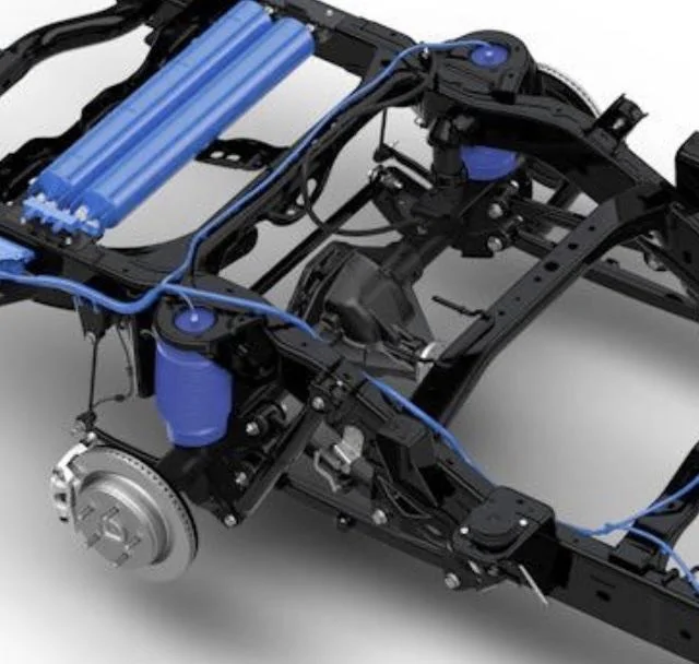

Much of the difference in ride quality between the Ram Limited and F-150 has more to do with the five link trailing arm/Panhard bar rear axle than the air bags.
Ford F-150 Air Suspension? 97F984CC-375E-4BAE-9DDB-A7C625B29AA3
Though you can get a similar coil spring setup now with the new Raptor.
Range Rovers had a trailing arm rear suspension in the 70’s, it’s nothing new and just about everything else has a better ride quality than the leaf spring located live axle setup that’s traditional for light trucks which is about the worst possible thing for comfort but the best option for cost.
