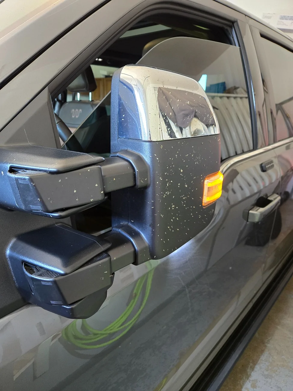

The problem with putting TT Mirrors on after the fact is you will also need the switch to expand the mirrors out, thos would involve changing not only a door switch panel but a harness. I tend to Buyer2021's comments, enjoy your error code festival.
Ford F-150 Adding tow mirrors 20250825_095654
Ford F-150 Adding tow mirrors 20250825_095644
