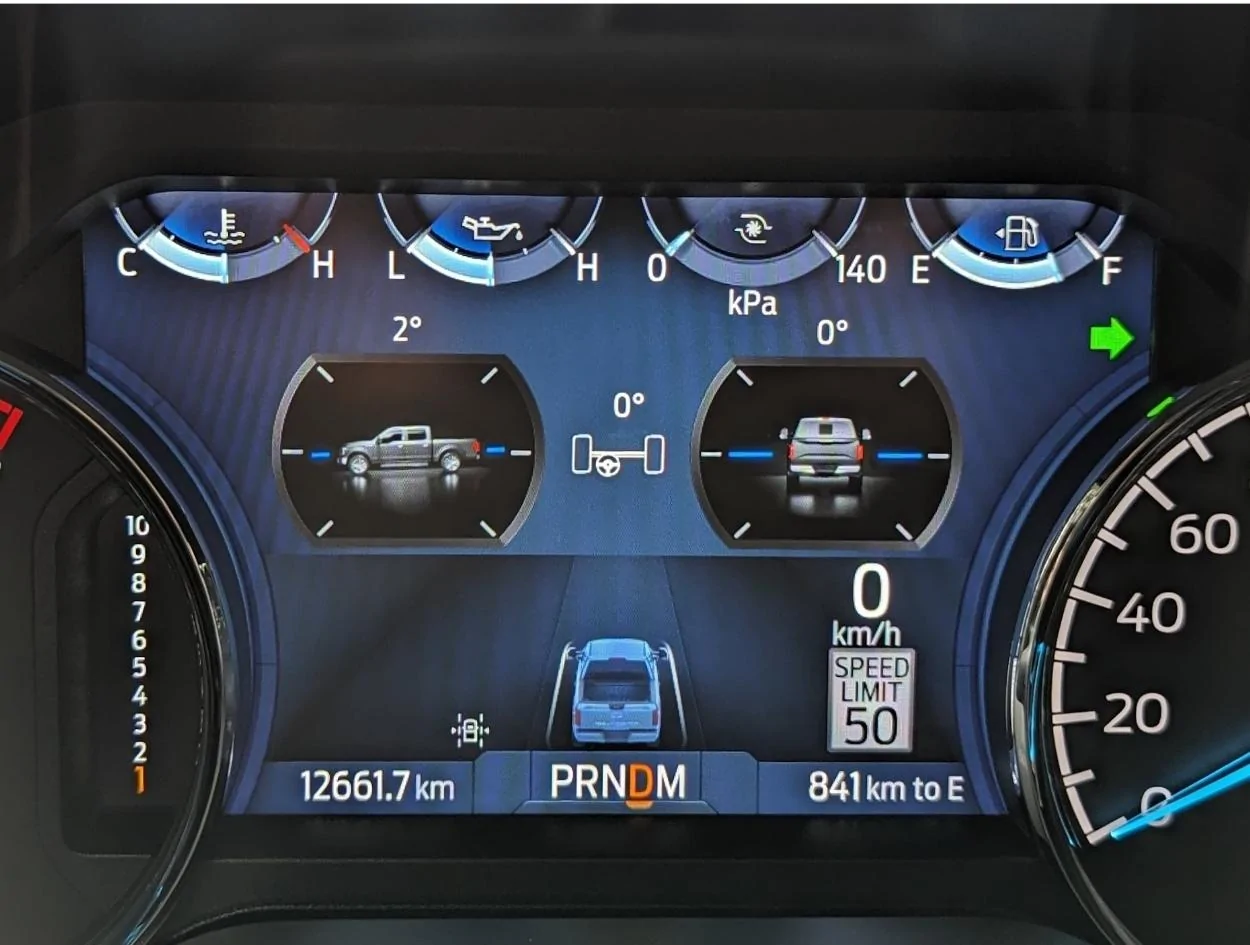

Wondering what's involved in adding speed sign recognition. The truck doesn't have Nav or front cameras if that's a concern. I'm looking to have a display like this

No worries. You may want to post in that thread to confirm you have the right values. I found out that for the IPC, the value you're supposed to change to an 8 should be a 9 to avoid disabling Forward Collision Warning (or one of its components)

Is there a way to get the speed sign to stay up longer than 90 seconds? I’m in a 22 XLT without NAV. 302a. I have everything working but it goes away after not seeing a sign after so long

The speed limit comes from the navigation and really depends on the quality of the maps.
Not that I know of. You'd need a navigation capable APIM to get it to persist.
