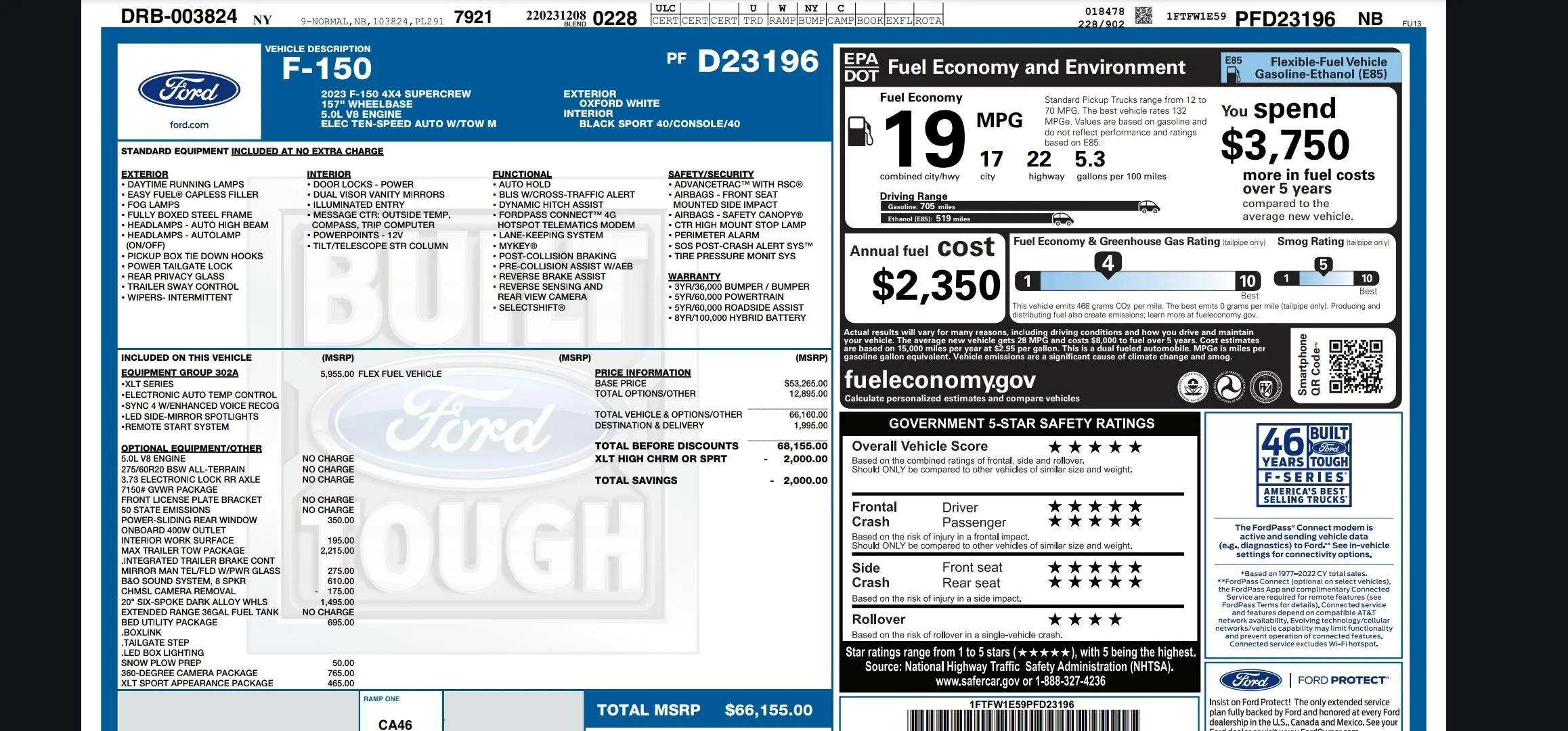

I've dug around the Internet trying to figure this out before making this post. Just can't seem to get a clear picture. I'm looking at a 2023 XLT 302A truck with the 360 camera package. It does not have the co pilot assist 360 2.0. I'm wanting to add the front sensors. To be able to activate the forward camera when I get close to something and also have adaptive cruise control. I know I wouldn't have and self driving features but I assume I could get the other options to work with software changes and a steering wheel switch. Has this been done before? If so where can I find part numbers and a write up on how to do it? I've attached the window sticker just in case it's needed or helps.

You will need a new IPMA

Yes as Jesse said I'm wondering if adding the front sensors is possible considering the truck has the 360 camera package. If it is possible what all is needed for parts and software. Also what functions are then made active once the sensors are installed everything is set up right.

You have to replace the IPMA IF the truck has 360 cam and no front sensors if you want to ADD front sensors. Starting in 22 FOrd has IPMA for each situation.

Jesse. Do you know if I need anything else other than a bumper, sensors and the impa? Also do you know if I would gain the adaptive cruise feature? Part numbers would be nice to know also. Thanks for taking your time to inform me.
