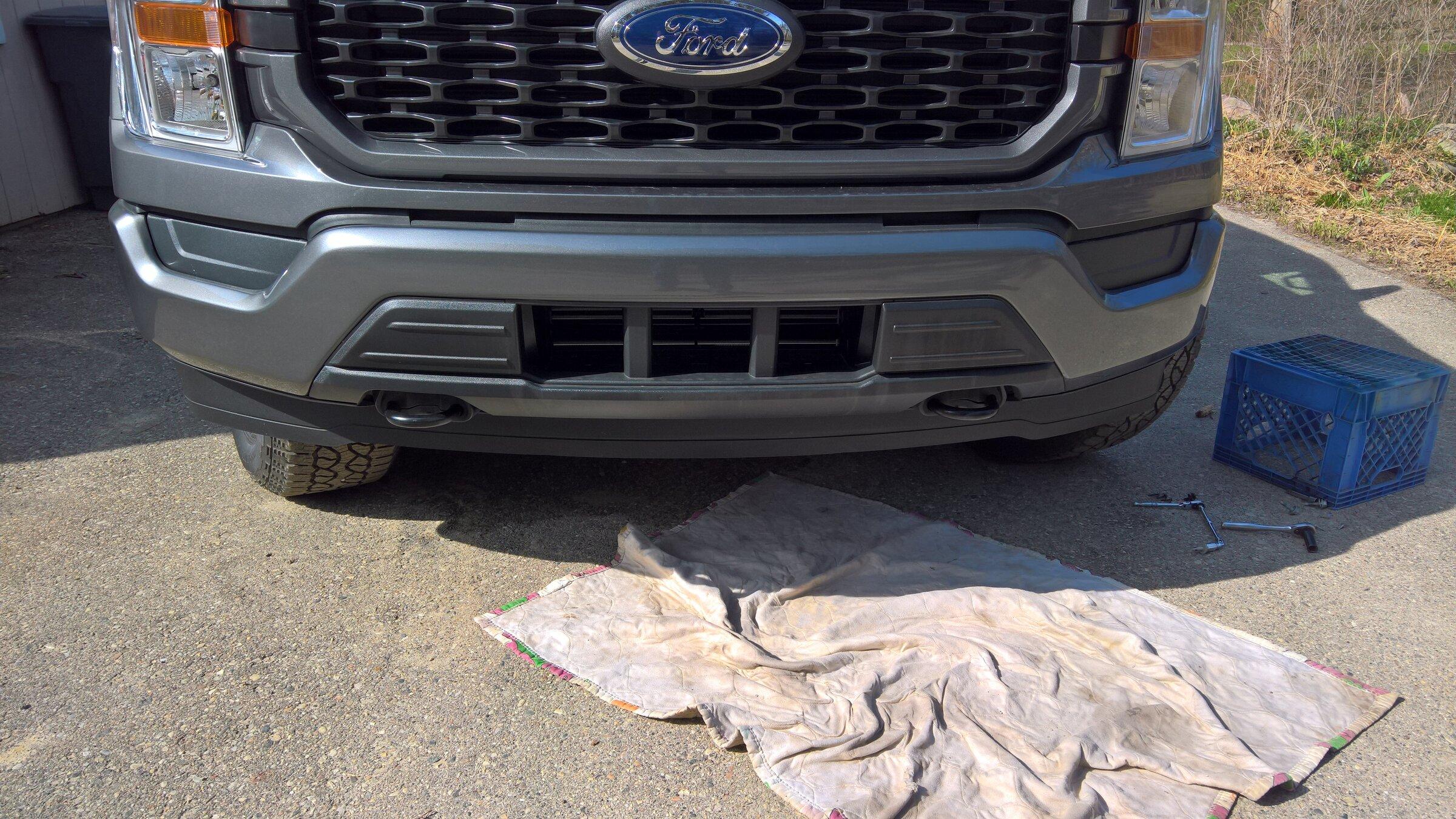

Just picked up my 22 STX and like most of you know you no longer get fog lights with the STX package unless you get 20" wheels. I hated the look so I searched around and found these on Amazon for $165 and they bolt right in! There led with drl, seen same ones on eBay for over $300. Put them in yesterday you have to remove active air dam and motors and almost remove bumper to get them in but well worth it!

How was the wiring, were you able to use anything that was already there?

Nope nothing there to use. Bought a fog light harness on Amazon and tapped into the running lights so when they come on so does the fog lights. Also I wired the fog and drl together.

How about a picture of when they are On!!

they look pretty bright but if you already have fog lights I would just put the bulbs in yours. It's a PINA to replace the whole thing!
