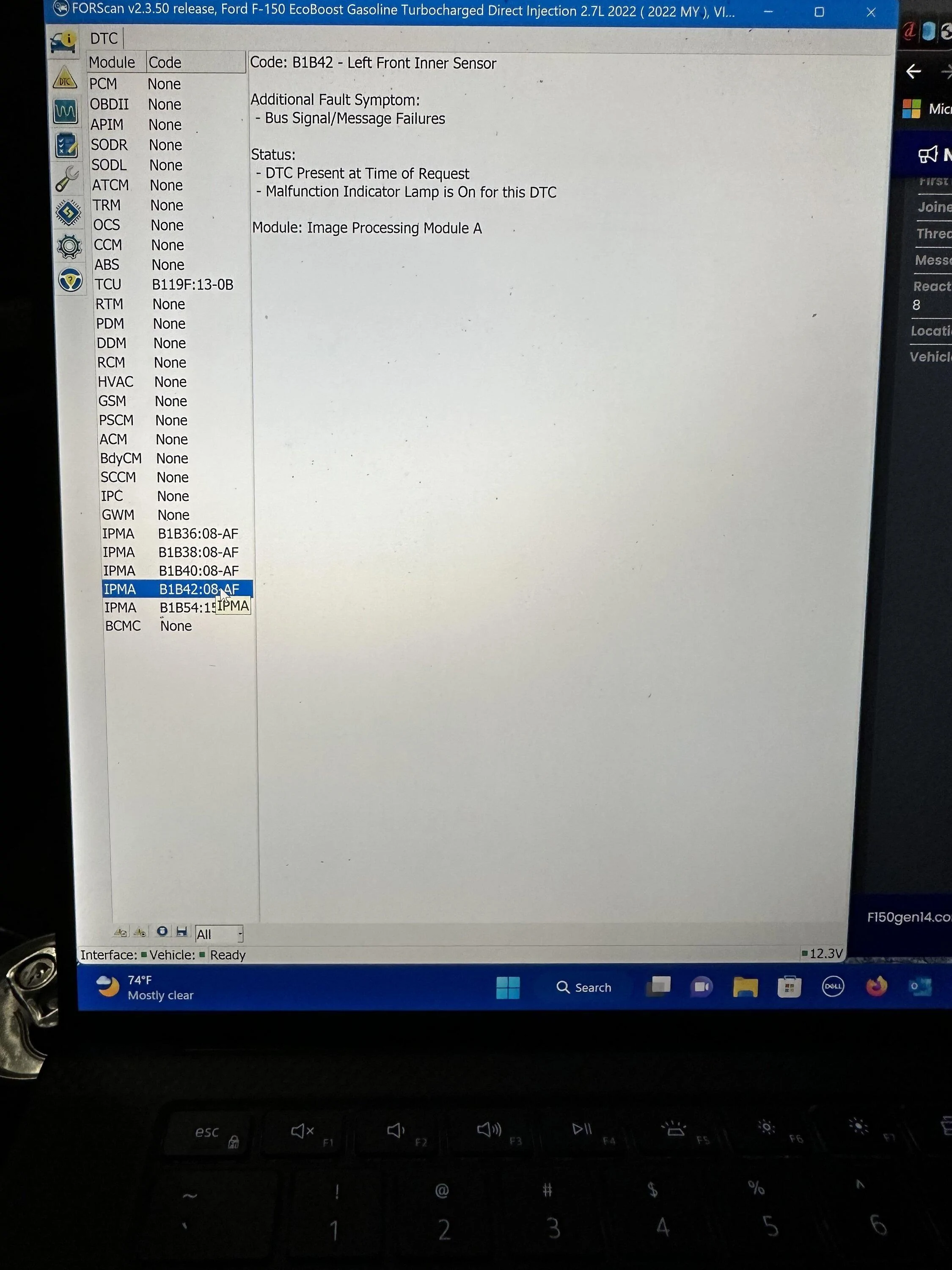

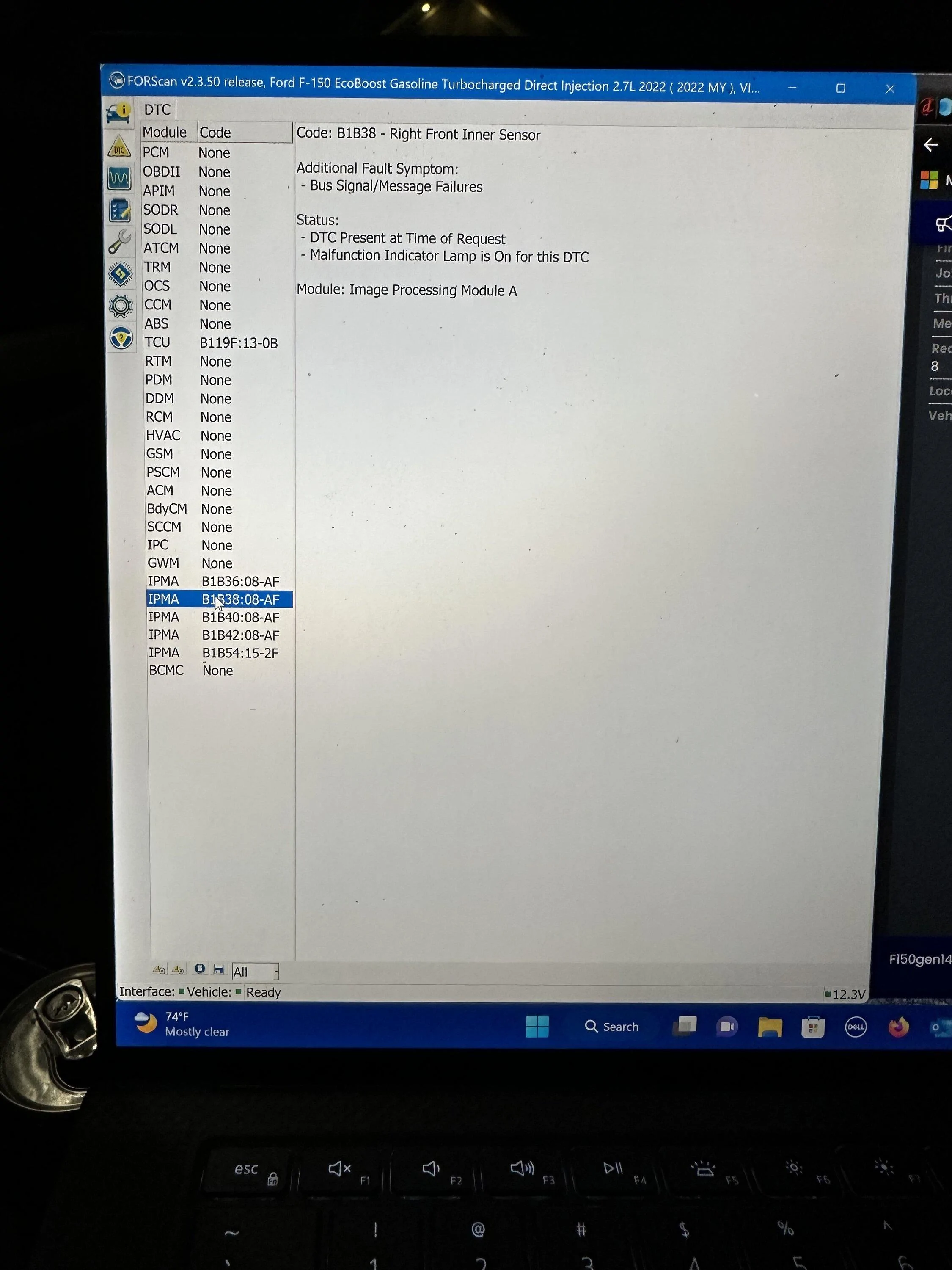

Im helping someone add a few things remotely. CCM works fine but getting a bus DTC for the front sensors same as the guys were when trying to enable APA
I started looking into it and found that every truck with now front sensors has one part number while the ones with Front sensors has another.
So while Im not 100% Im feeling it may be. So Ill wait to say for know. We are going to get an IPMA ready and swap it out and see if that resolves his issue. If it does then that will answer that.
I wanted to mention it. If anything contradictory comes up Im open to hear it.
I have double and triple quadruple checked the programming. Doesnt mean I cant have something missed but I don't see programming causing the bus DTC

If you unplug a sensor, are you getting a DTC for a open circuit or does it not detect the sensors at all?
It detects but no Lin bus. Same as the APA side sensors.
So you can get an open circuit and then the bud dtc . Since they are linbus. We are getting the bus dtc

Having trouble finding the forscan changes for front park now.
Mind sharing the changes?
Yeah there are quite a few.. The IPC.. the APIM and the IPMA>
The IPMA
706-02-01736BFFCC41B6
706-12-0119C464000031
IPC
720-09-02200D217C
720-10-0200005881
APIM
7D0-08-01C000000200A1
I think thats it.. Maybe Im missing a couple.. this is off the top of my Head..

I do not have a buss error.

I dotn think without the sensors being plugged in you can really know.
Ill know for sure in a few days. Imm sending an IPMA out tomorrow
