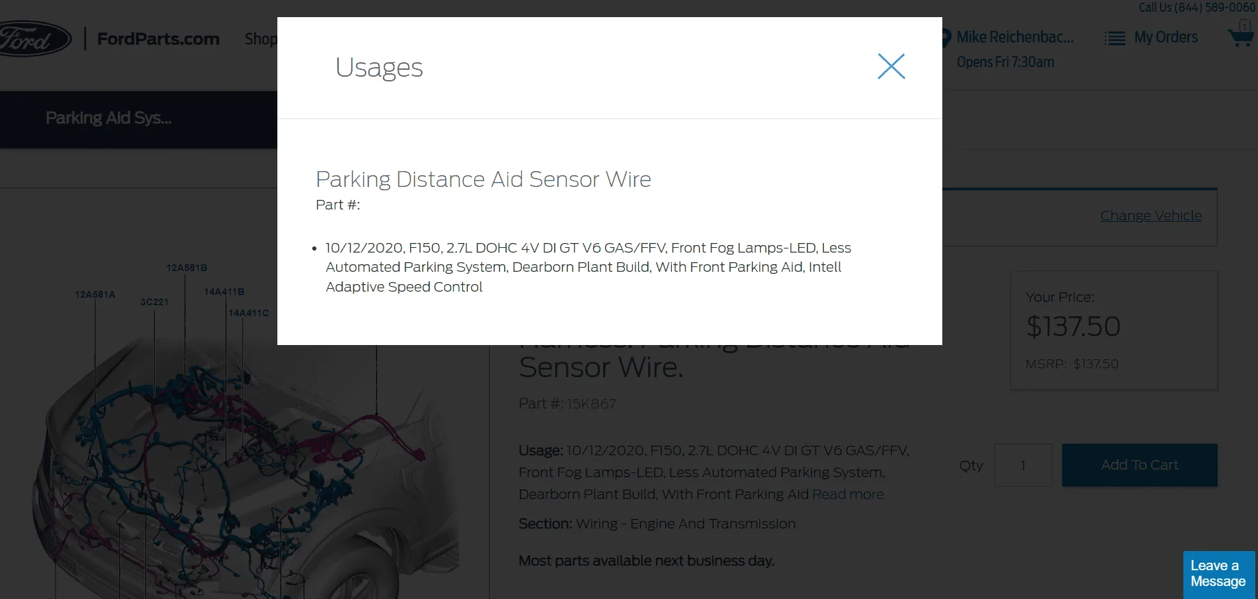

So what’s up with the part description for the -MA harness referencing “without fog lights”? Since I’ve already ordered I’ll see what the -JA looks like when it comes in.

Here is all the different harnesses, so your -JA isn't going to work at all. You need one labeled with adaptive speed control. From what I can tell, the harness are the same between a ecoboost and powerboost, so no difference there, which makes sense as that would be just one more different harness(es) for Ford to produce if they were different.

Thanks for the info. The VIN I'm using is 1FTEW1EP9MFB48277. The photos definitely show the adaptive cruise buttons on the steering wheel. Local Ford parts department is insistent that -JA is the right part so if it's wrong I'll have them order the -MA.

That VIN should be good, it has the front parking sensors though so not sure if you need those or not. You have to be careful though when the Ford folks look it up, sometimes the VIN they use is right and sometimes not so much, so you'll have to see. I'm pretty sure the -JA still isn't the right harness you need but you'll find out.
