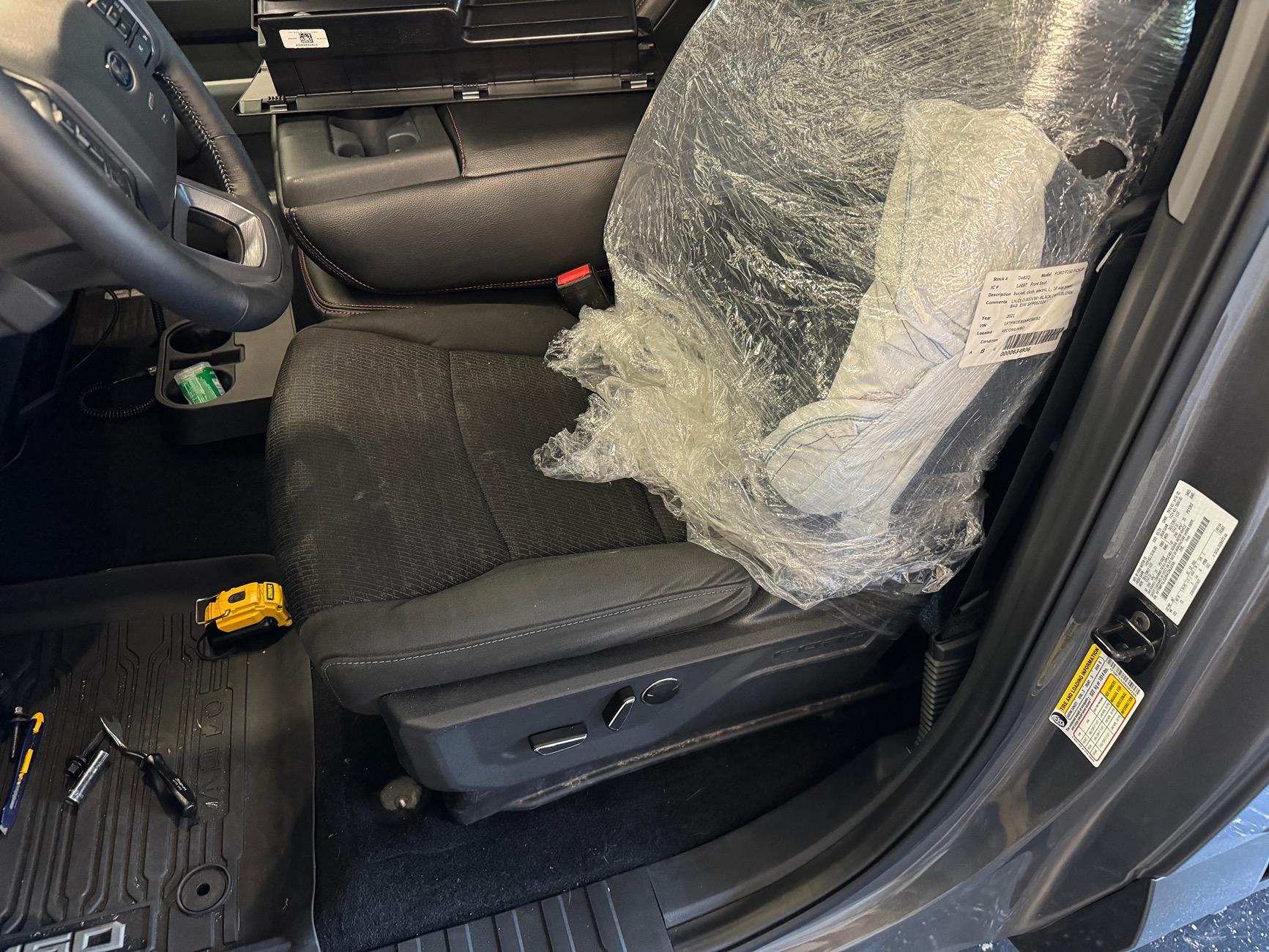

I Have some news on the 2024 F150 XL seat swaps. My new to me 2021 power driver and passenger seats arrived after a couple of day through shipping.
I pulled the drivers seat last night and all the wiring looked to match in the pins on both seats, so I dropped the 10way power seat in the truck and plugged it up. I'll be damed, it worked like a champ. All of the switches worked correctly including the lumbar.
I will try the passenger tonight and then move my seat foam and leather seat covers over to the power bases.
I hope this helps you guys that are on the fence about the swap. I will add, my 2021 seats were not memory seats, I had the recking yard confirm this.

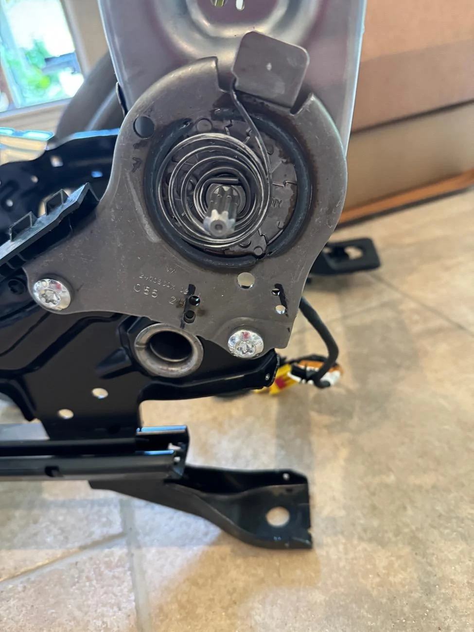

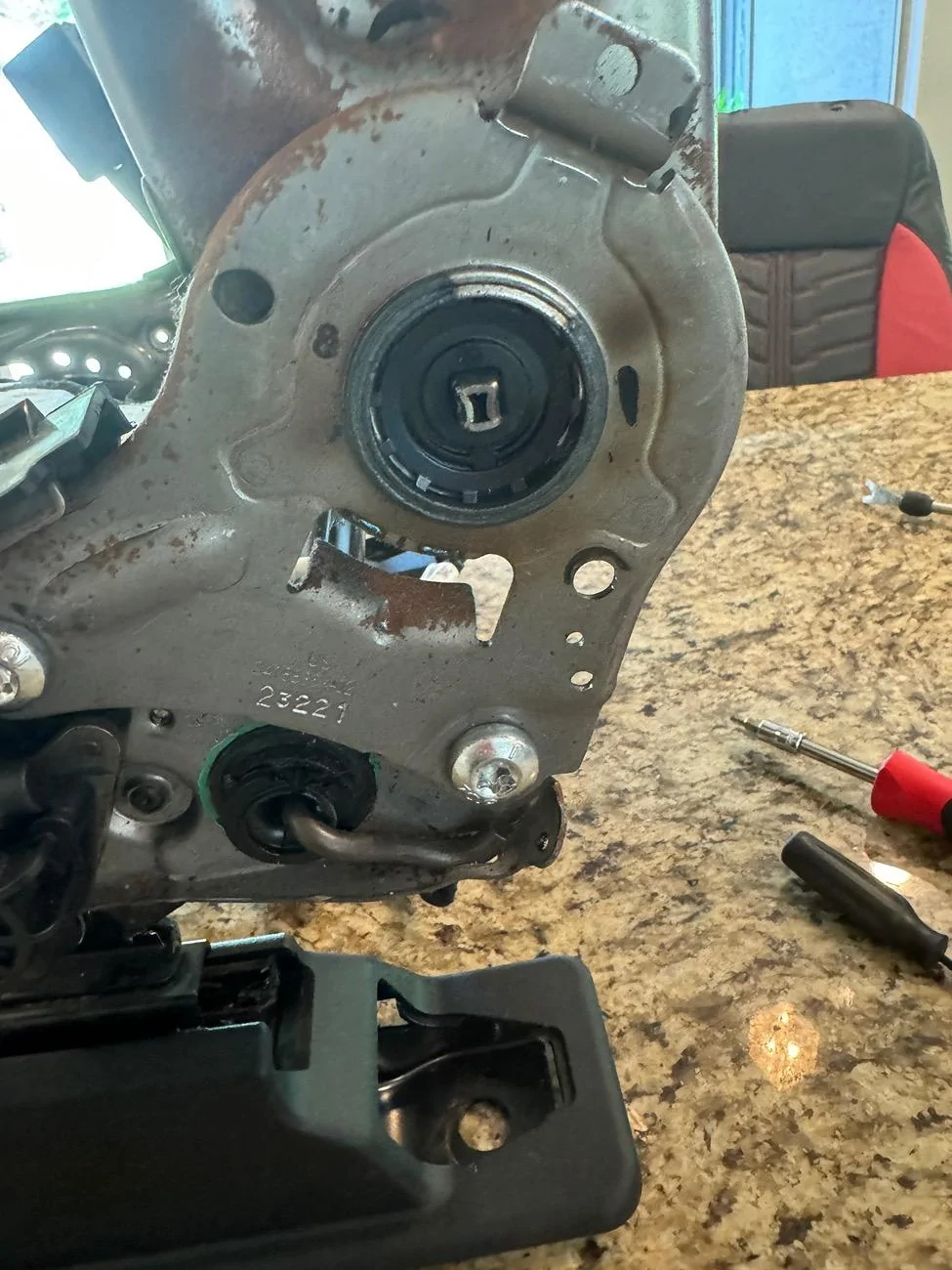

I also took pictures of the side of the powered and non powered seats. You could use the power bottom, but the upper has the motor mounted to it, so you would need an upper powered base as well.
