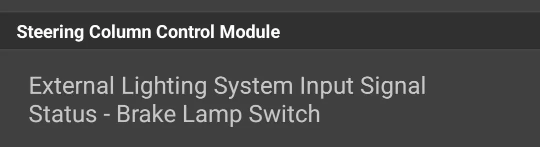

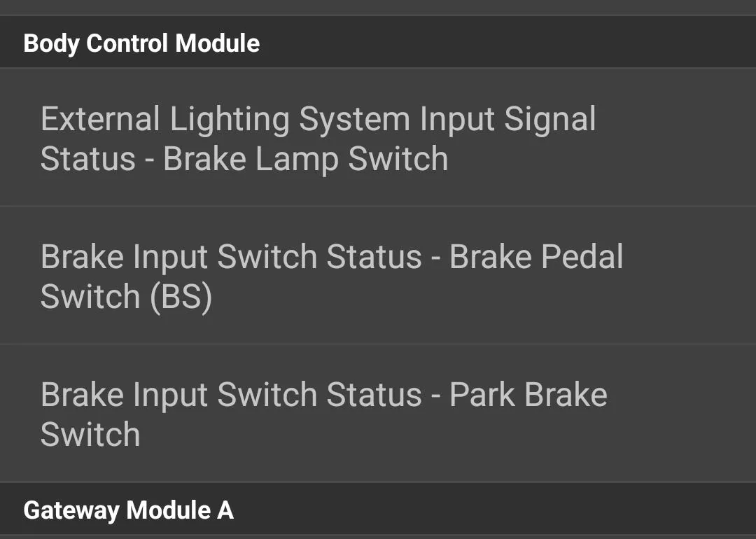

Try it at night and you should be able to discern?
Come to think about it there could be a PID?
I've not seen a PID, but you can see the brake light signal on the canbus. The real-time acceleration signal is very noisy, it looks like it's using the planned acceleration being less than -0.5m/s2 to actuate the brake lights.
Ford F-150 Adaptive Cruise Control behavior Screenshot 2024-04-06 at 9.39.49 AM
Just a quick search in the PID library and at least there's a few of interest.
I'll load them up and see if any of them indicate/reflect when the brake lights are illuminated.

My vote is the first one to be indicating brake lights without using the pedal. :)
