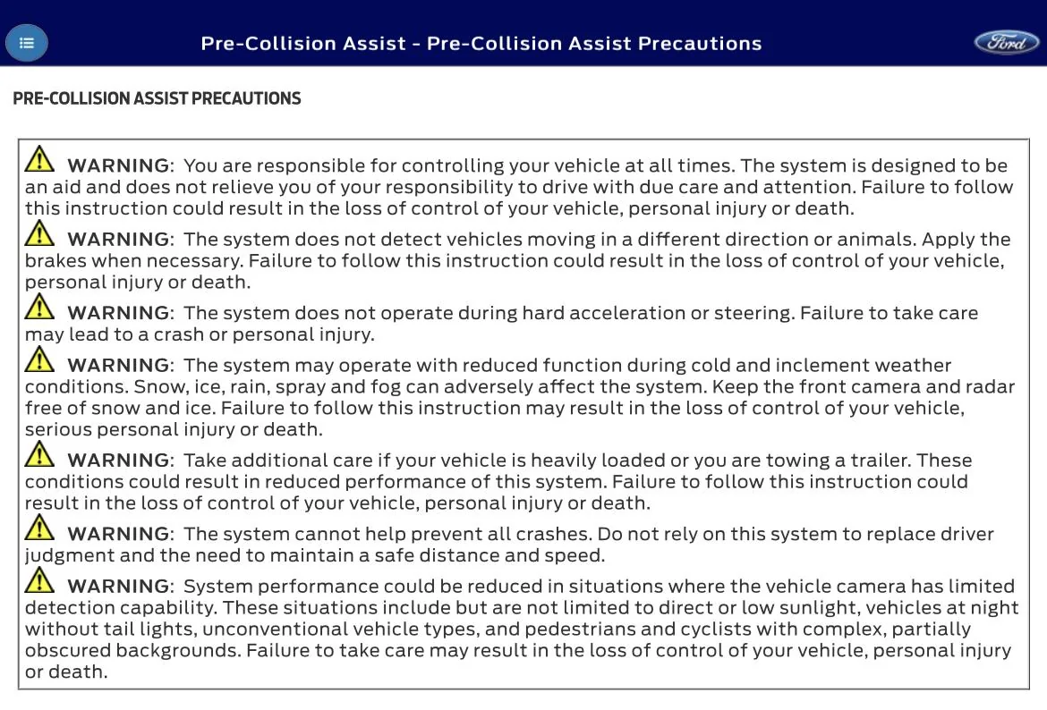

In general, no.
Ford F-150 adaptive cruise and WILDLIFE 74A2C92D-AB59-443E-B386-1BDC33B94176
Ford F-150 adaptive cruise and WILDLIFE 9E60E343-D29B-46BF-A790-76022E1A5E2B
Neither Adaptive Cruise or Pre Collision Assist are designed to detect animals.
That doesn't mean that it couldn't have seen the deer and "thought" it was something else and hit the brakes. It does mean that you shouldn't expect it to behave the same for the next deer.
