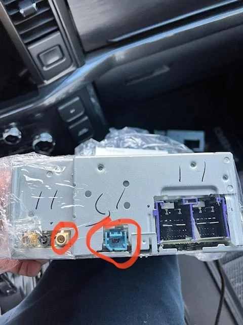

I think the muted chimes is related to that blue usb digital audio connector that Jesse-Infotainment mentioned early on. I wonder if usb digital audio could be disabled with a Forscan change. @Jesse-Infotainment do you know if this is possible?

I installed the FDK ACM using the settings below and it doesn’t work. It tunes into HD radio stations but there is no sound coming from the speakers and the volume level is stuck at 6. It also is very laggy.
I reinstalled my original ACM and everything works as normal.
ACM: 727-01-01
X0XX-XXXX-XXXX
Leave the rest the same and make that a 0
I actually didn’t change anything on the FDK ACM because the 2nd digit is already 0.
APIM: 7D0-01-01
XX8X-XXXX-XXXX
Leave the rest the same and make that an 8
I did change the 3rd digit to 8

I keep getting DTC U0554-00 (Invalid Data Received from APIM). I assume this has to do with the A2B USB connector not being used?

yes it is. It only happens with the new ACM.
Also the ACM is from a Canadian truck so I not sure is another possible cause
