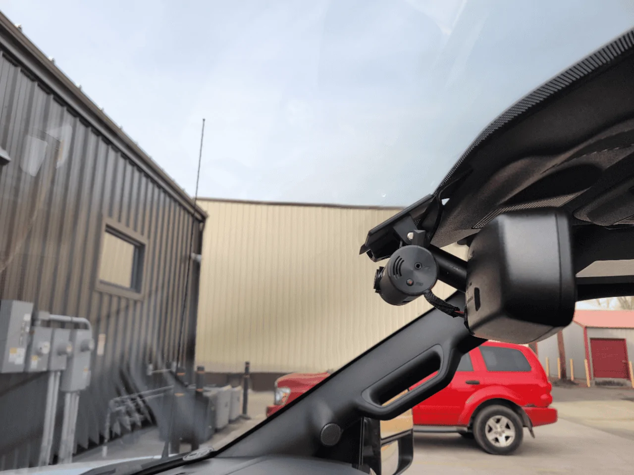

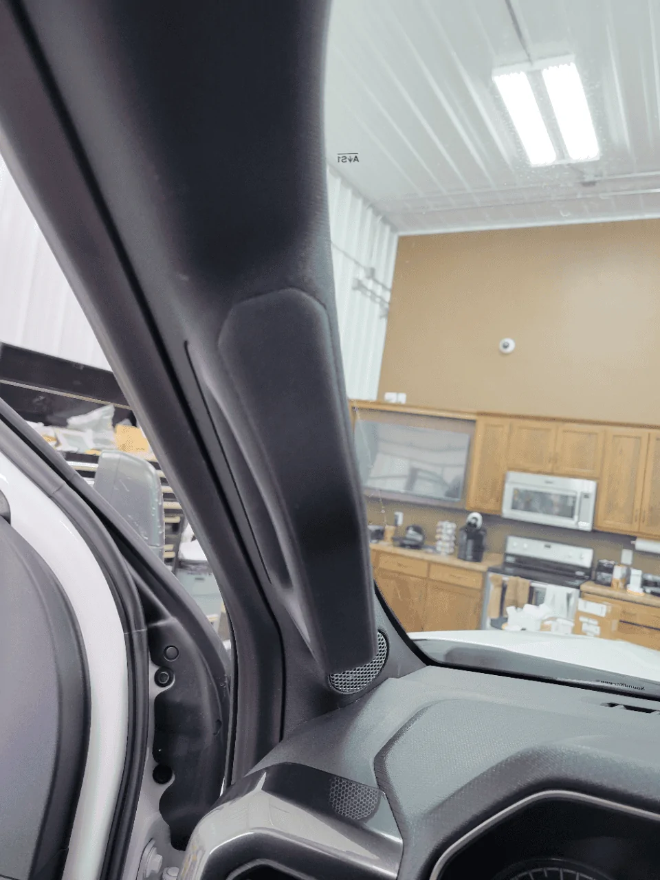

Here are installed photos. Not visible from the drivers seat. Does not have wifi or app, must remove card and put into PC to view videos. A no thrills camera, but seems to be recording just fine.
Install was plug and play and took about 10 minutes. I ended up not removing the A pillar cover, and just tucked cable behind the weather seal.

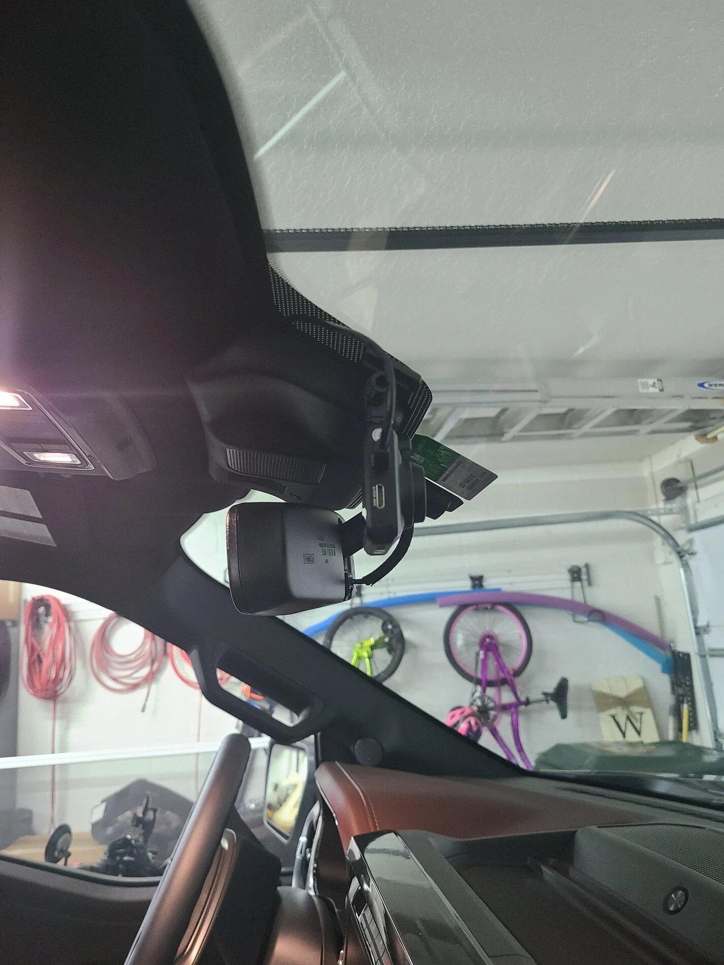

I installed my aftermarket camera and was able to get power cable across the top/front headliner into the A piller and tucked behind the rubber weather stripping then under the dash. I used an OBD power cable so I didn't need to hardwire it.

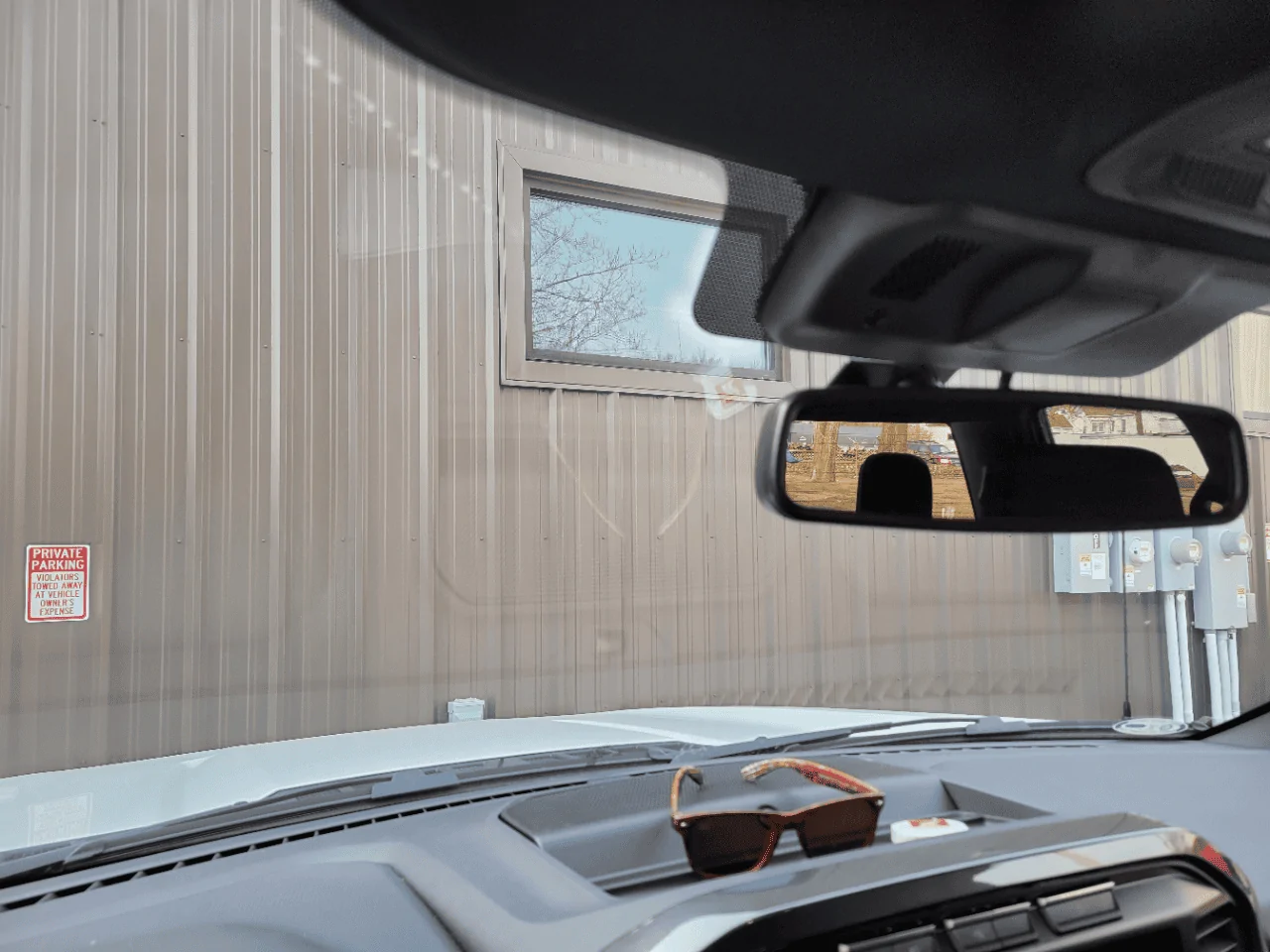

I was going to put mine behind the mirror but was worried it would interfere with the camera in the rear view Mirror so I mounted it to the right side out of the driver view.
