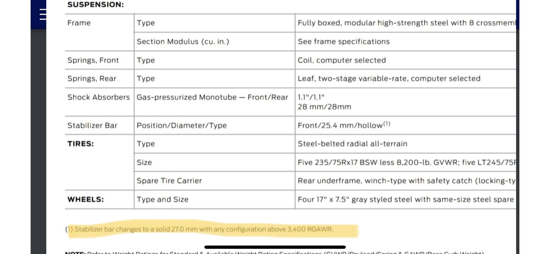

Pixie
Sep 23, 2021
2021 F150 Lariat 502a PB
It’s a very frustrating thing to find. I had the same issue, but it was more for capability than need so I still took my truck. I did a lot of research on it an I’m pretty confident the only difference when it comes to the Powerboost is your sticker says 7000 not 11000.
I’m thinking the same! My build has the solid stabilizer based on GAWR, cooling is the same on standard vs tow in regards to the PB, and rear axle is also heavier from what I have found…
