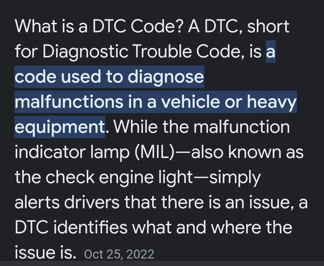

Have you looked to see if you have any DTCs?
What are DTCs? I have not looked.
