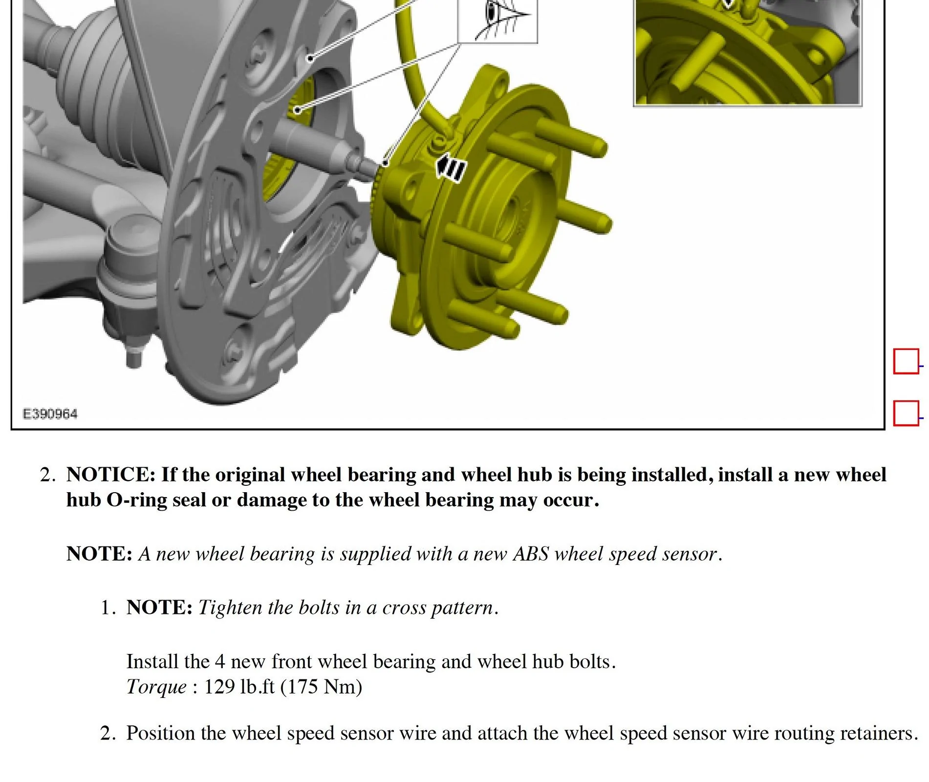

On a 2021 4WD PB, any idea what the torque spec is for the front wheel hub assembly?
Looking for the spec on the 4 bolts that connect to the knuckle. I've searched high and low and can't find anything. I can find older values, say for 2014s, but nothing on the newer trucks. Also, Google's generative AI will lie hardcore about this one.
Appreciate any help, having to replace the wheel hub b/c someone used an impact on the little 30 ft. lbs axle nut, (wasn't me) when they installed spacers before I owned the truck.

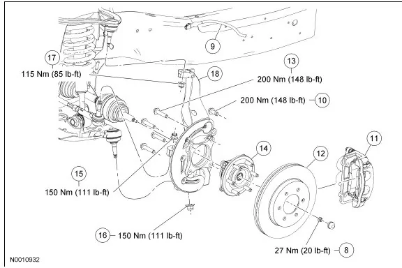

Edit: Looking for figure #13 from this older guide, but for the 2021.
Ford F-150 4WD Wheel Bearing and Hub Assembly Torque Spec 4x4knuckl
Edit 2: Bit the bullet on the manual. JIC anyone else needs it.
Ford F-150 4WD Wheel Bearing and Hub Assembly Torque Spec Wheel Hu

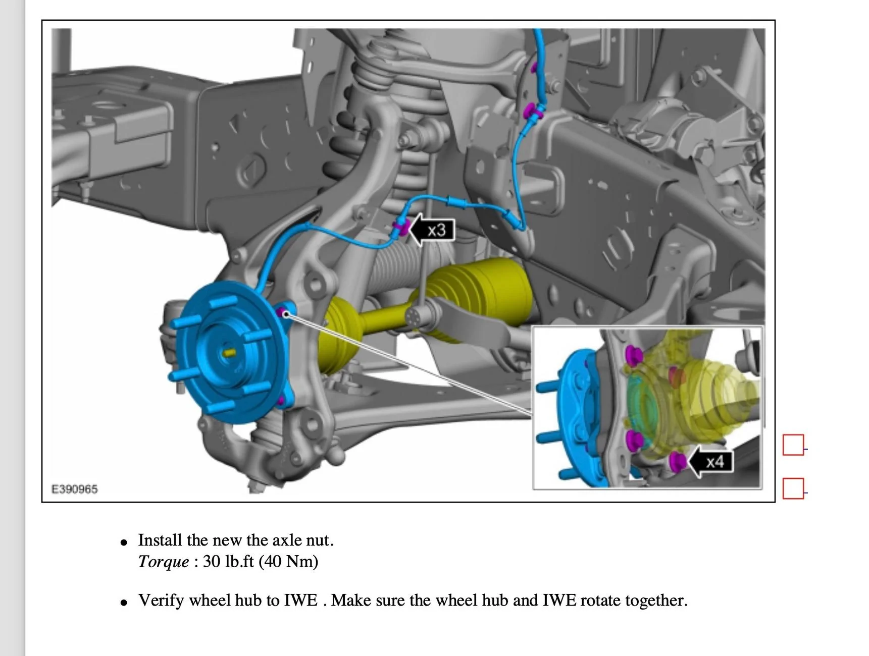

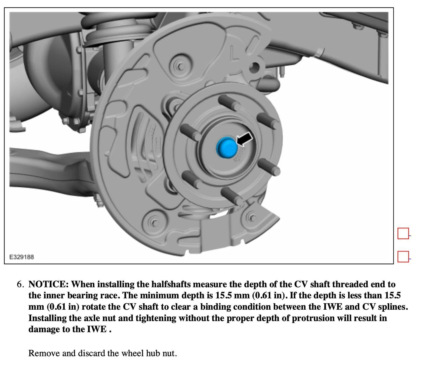

It was pretty straight forward to take apart and put back together. If you have IWEs, the manual did say put the truck in 4H before performing the work. Be sure to watch that axle shaft nut when installing. DO NOT use an impact on that little guy. It only takes 30ft lbs. Also be sure the threaded depth is enough when installing. That little axle shaft is a PITA. Also make sure the speed sensor and IWE cable doesn't get mushed.
Ford F-150 4WD Wheel Bearing and Hub Assembly Torque Spec Axle Nut
Ford F-150 4WD Wheel Bearing and Hub Assembly Torque Spec CV Shaft Not
