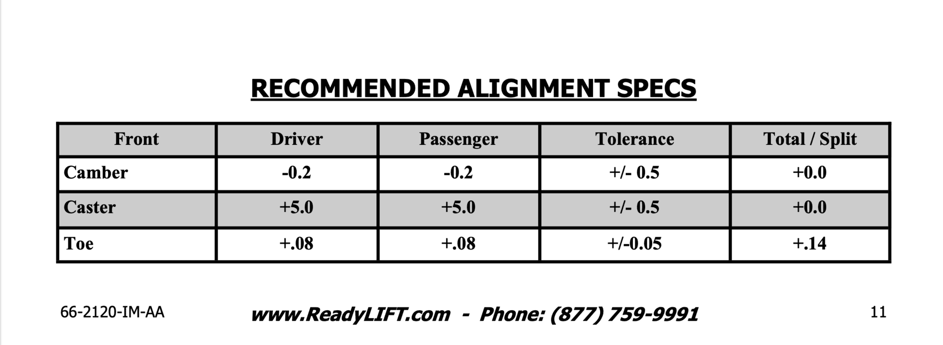

Those that had alignments done to their trucks already, can you post the alignment numbers? I just installed a 2-inch level kit on my truck and wondering if anyone knows what the alignment specs are for the 2021 F150s. Since the 2021s suspension design is very similar to Gen 13 trucks, I wanted to see if there is a difference.

I do not know the specs but i did have to have mine realigned after 2” readylift install.

This is from the 2021 2" Readylift:
Ford F-150 Wheel Alignment Specs for 2021 F-150? 1617570274405
