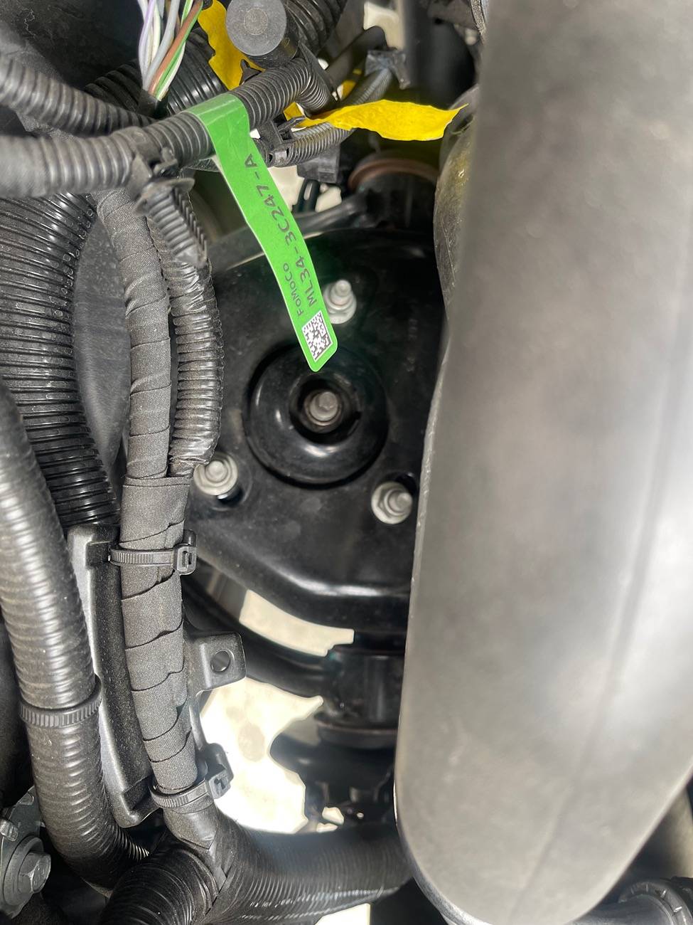

So I installed the Ford Performance leveling kit on my truck, took it to the dealer for an alignment. The service advisor mention they don't do camber. Took it to an independent and he screw’d the caster up. Thoughts on the numbers? I will be install the SpC camber/caster bolts this weekend. Also I am looking at the top hats and see that they might be adjustable?

The ideal camber and caster numbers are debatable, but I would not be happy with the outcome you got. Installing camber bolts is a great idea as it will make aligning your truck easier. Moving the top of the struts around will not change caster or camber on a double wishbone suspension.
I do my own alignments and have my truck set to specs shown below.
