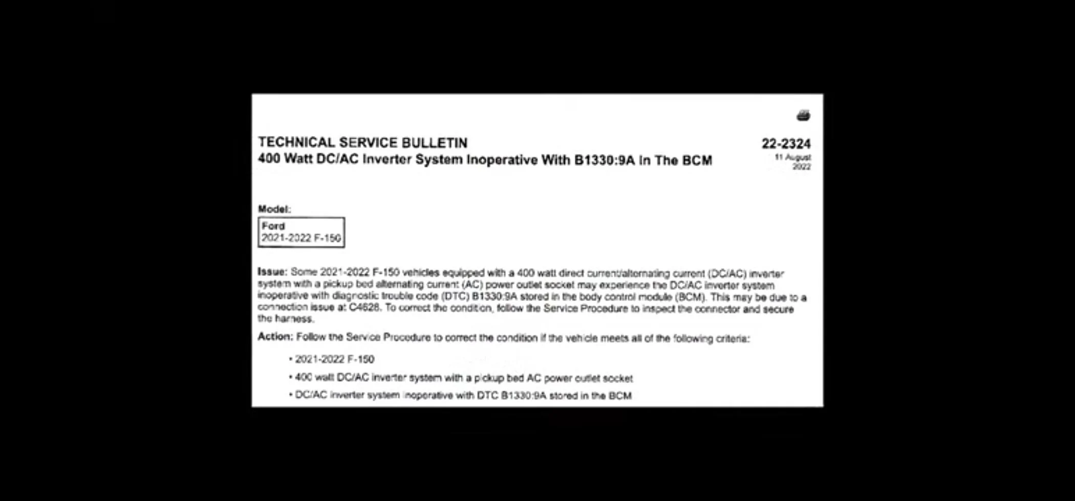

Found this, seems like my truck for sure SUCKS I'm out of warranty.
Ford F-150 400w in cabin outlets Screenshot_20240421_144243_YouTu

When my 400W inverter stopped working, the LEDs on all 3 outlets stopped illuminating, and I had a B1330:9A code that wasn't resolved by TSB 22-2324. In my particular case it looks like something in my inverter shorted out and burned out all the LEDs on my outlets, replacing the inverter, replacing all 3 120V outlets, and running a BMS reset resolved my issue.
Replacing all those parts cost me less than $300 and had I only needed the bed mounted outlet, the repair would have been about $50.

Pretty confident it's the tsb from post 8 but haven't gotten around to it yet.
My outlets all have been completely dead now for a couple months, no longer intermittent.

I finally got around to checking on mine and the problem was the same tsb from post #8. I replaced the outlet in the truck bed and now all outlets have power. It took about 20 minutes max. Thanks for your advice on what to check!
