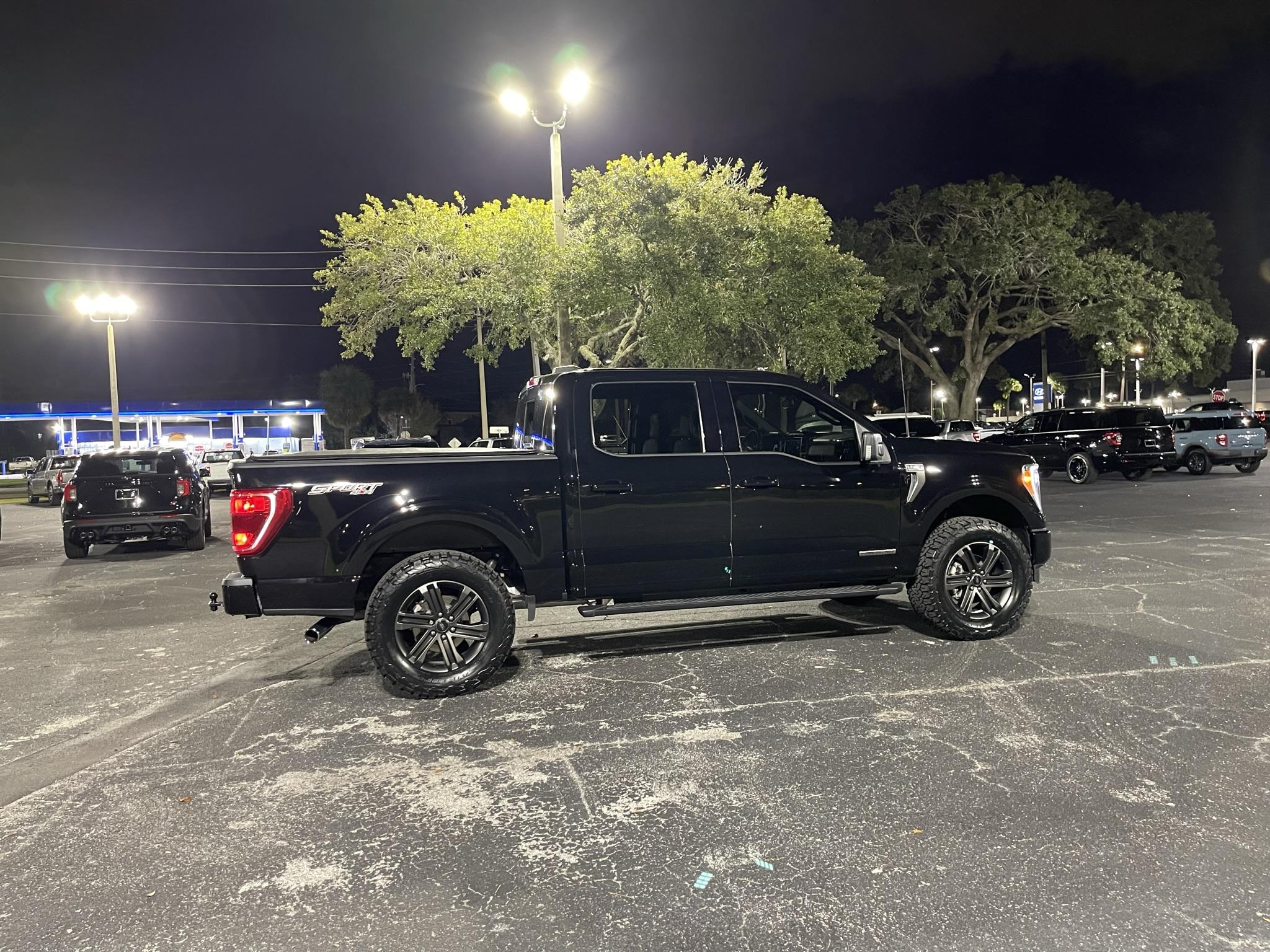

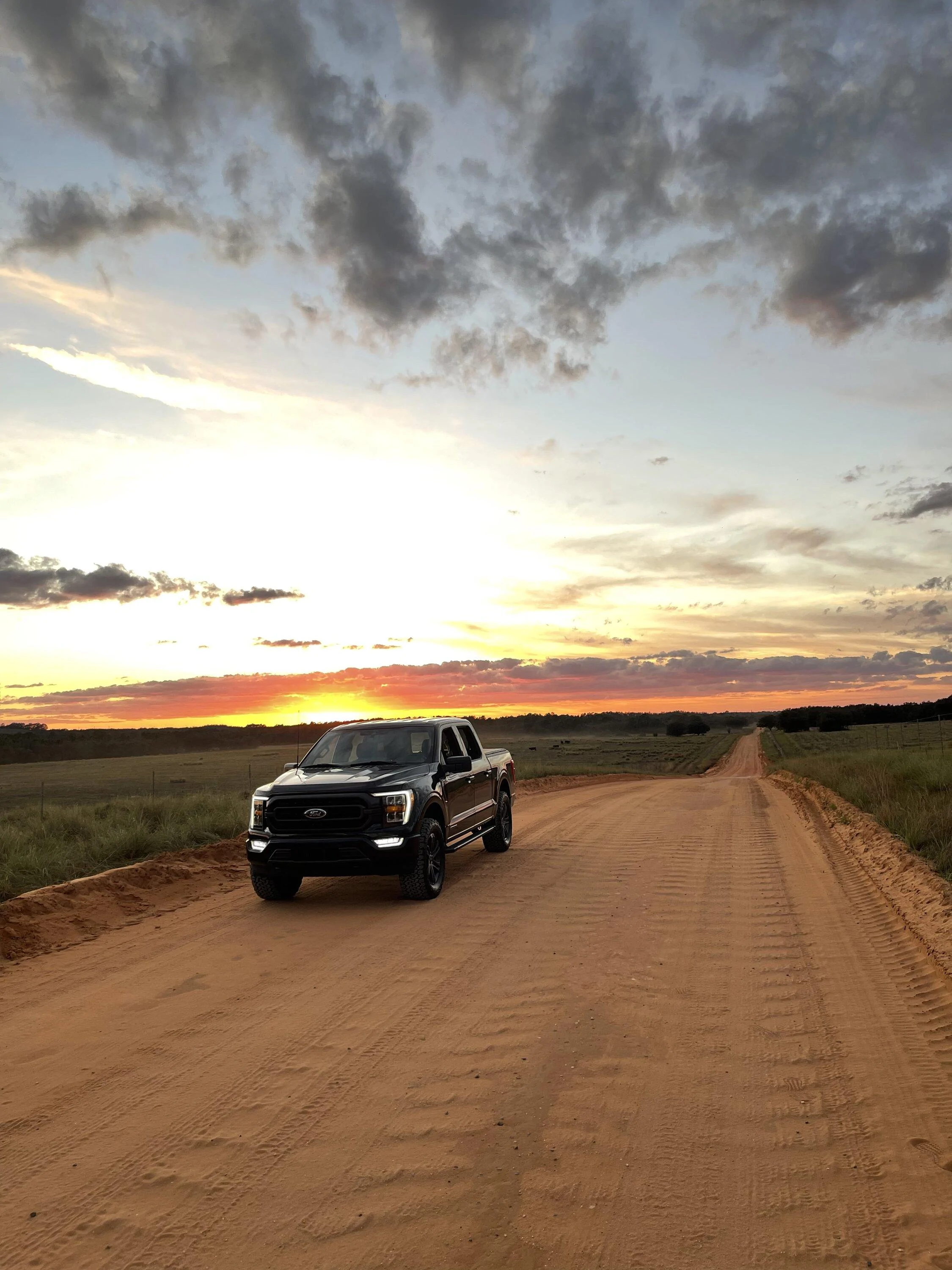

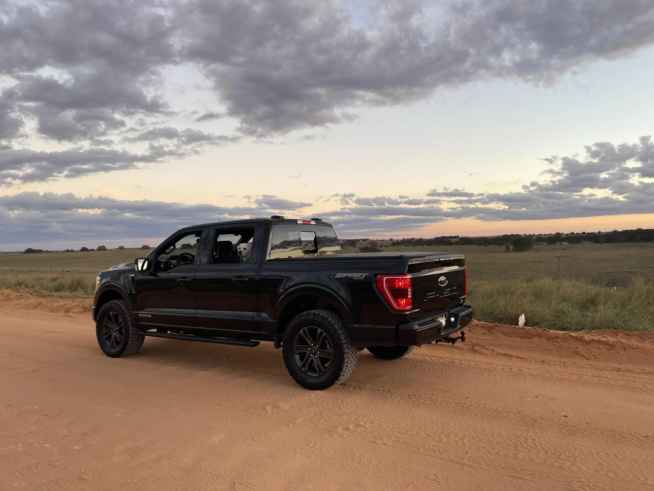

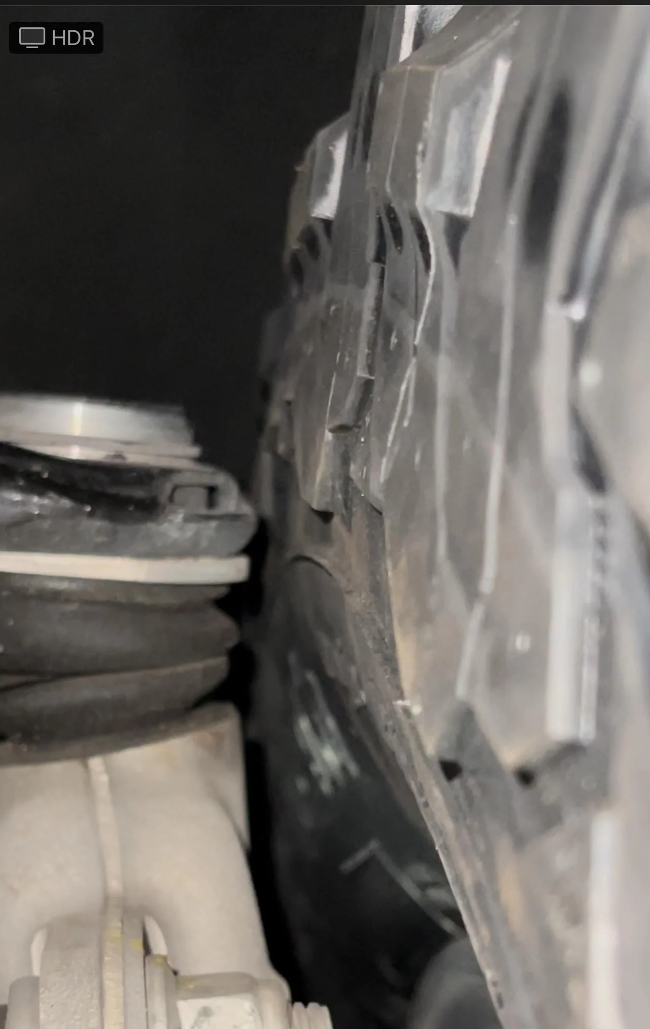

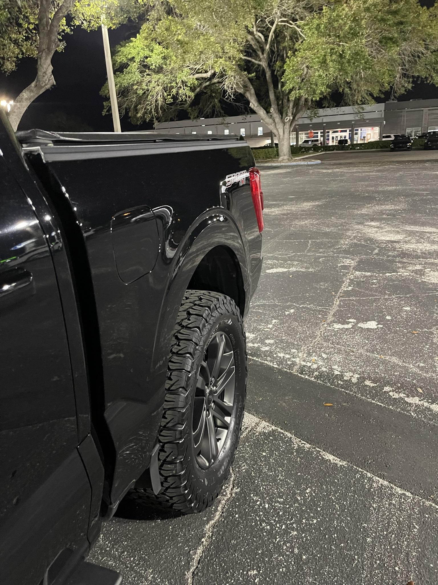

After an absolute roller coaster of trying to figure out what size tires I could fit with a 2” leveling spacer and stock wheels, I finally took the leap of faith and placed the order for these 35” 295 65R 20 bf Goodrich KO2s. I am so glad I didn’t cut off my crash bars, I didn’t need to do anything and there is a lot of clearance. Only place that is close is the space between the sidewall and the upper control arm, see the photo below. Truck could not look better, I am so happy and I’m proud as hell it’s mine ?
Leveling kit is the ReadyLift 2" level kit 66-2120

Looks fantastic, nice pics...
I also wished I had those Sport rims...

Man, beautiful truck!!! I would consider putting some 1/2-3/4" wheel spacers. That side wall distance to the ball joint scares me. Especially if you ever air down for off road. I have a black fx4 delivering this week and thats exactly the set up I want. Thanks for sharing.

It looks badass! So you went with a 12.5 wide or 295?

He said he went with 295. 12.5 won't clear the uca without spacers or different offset wheel.
Yeah I know what he said I’m just making sure that’s what he meant because the picture he put up, The one I replied to shows 35x12.50 R20 if you zoom in you can see it

That is what I see as well.
