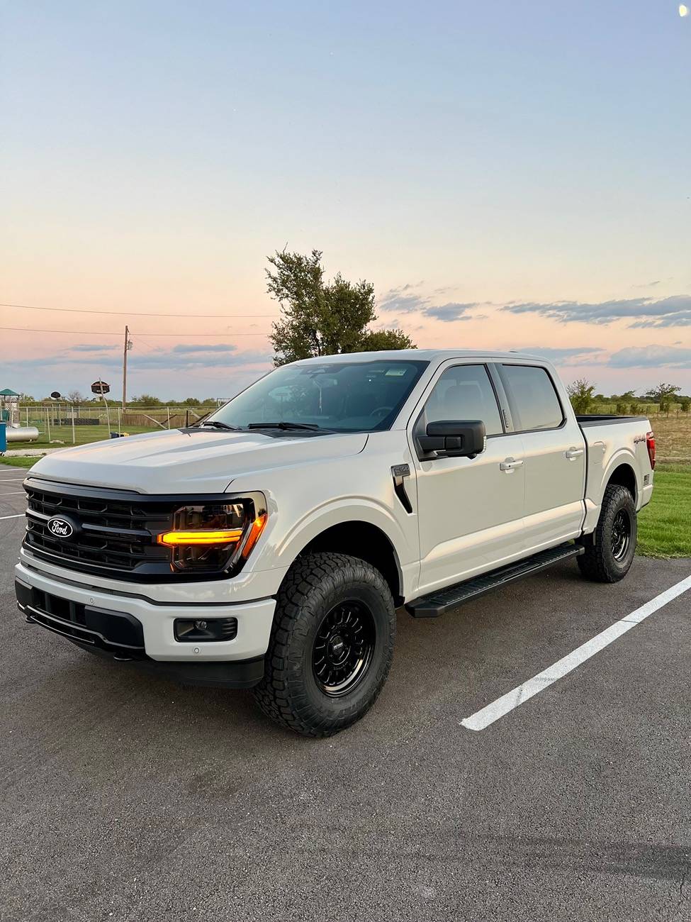

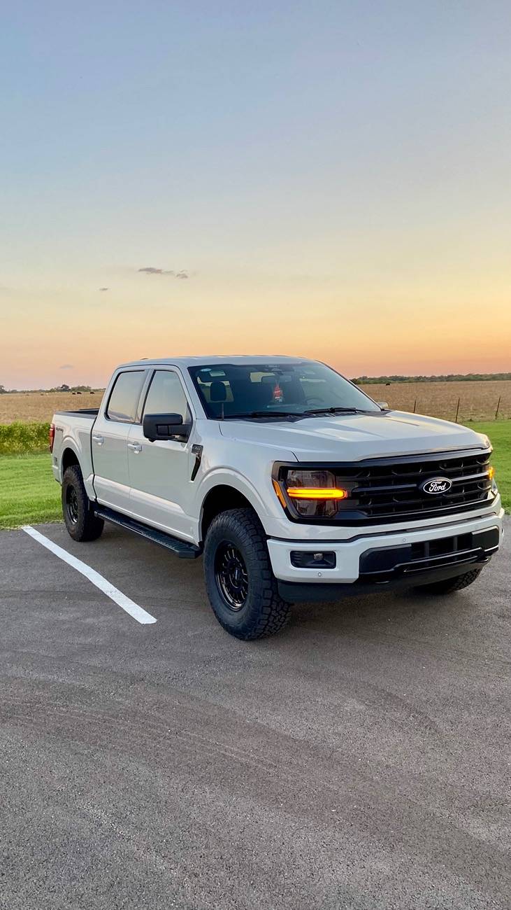

Hello - I recently purchased a new 2024 Ford F150 XLT 4X4 and wanted to fit 35” tires on aftermarket wheels with a leveling kit, without having to worry about clearance issues. So after tons of research, I made it happen and am very happy with the results. While doing my research, I saw tons of mixed reviews, with the majority of people saying that you couldn’t fit 35’s on an aftermarket wheel with a level. So I’m hoping this post will clear some things up and will help some of y’all with your decisions!
Parts/Specs:
35x11.50r17 Toyo Open Country ATIII
Method MR318 17x8.5 25mm offset
MaxTrac 2.5” Leveling Strut Spacers
Rough Country 3” UCAs
Tires:
From what I’ve researched, you’ll want to run a 35x11.50 rather than a 35x12.50 wide tire to help reduce the chance of rubbing when you’re turning the wheels. So, I went with the Toyo Open Country AT3 35x11.50r17 for my build. Something to keep in mind, which is one of the reasons I chose the Toyos, is that each tire generally has a different “Inflated Diameter” than the 35” you’d expect. For example, the Toyos run a bit small, with a 34.5” inflated diameter, whereas something like a Nitto grappler actually run a bit bigger. So, just keep this in mind when you’re choosing the tires for your build, as bigger or smaller variance in the tire size can help you achieve clearance with 35s.
Wheels:
I chose the Method MR318 with a +25mm offset for my build. I’ve seen a lot of evidence showing you can run 35x11.50 tires on a stock +44mm offset wheel on a leveled F150 with no issues. So, I went with the more positive offering for wheels to keep it closer to what I knew would clear, as the further negative you go, the more inclined you are to rubbing issues on the crash bars and valance. So, in my opinion, keep your wheel selection in the positive range unless you are fine with making some modifications for fitment for sure. The +25 offset gave me a flush/ slightly outside stance maybe
Leveling:
You need a 2”+ level in order to give your truck the height in the front needed to fit the bigger tires. I’m sure any leveling kit will do. I opted to add some Rough a country 3” max UCAs to help my angles out, but this didn’t necessary give me any more clearance for my build, so not needed to fit the tires. If you go over 2” lift in the front, sometimes your angles can get a bit steep and so it’s completely personal preference to take this approach.
Year:
2021 and newer F150s have more room to fit bigger tires, so if you have a 21+ and follow the above tips, you should be just fine. If you have a 20 and older, it’s not much of a difference, but definitely favor the smaller 35’s and a more positive offset to help. I have a buddy that just put 35x11.50 Falken AT on his 2020 4x4 F150 on stock wheels, and zero issues with about 2” of space.
Installment:
So after I got all my parts and such picked out, I had a local shop install everything. There were NO ISSUES with rubbing or clearance after installment and NO MODIFICATIONS, TRIMMING, ETC. there was about an inch clearance at the closest point of contact. Now, we went ahead and took a hammer and punched the crash bars (front and back) a little bit to give some more wiggle room. This is NOT NEEDED to clear at all, but I did it just to reduce rubbing if I’m compressed and at full lock, and because doing these minor things cause no harm to the integrity of your truck. For all those worries about a little plastic trimming inside the wells, it’s not going to do any harm, and you will never notice 2” of plastic flap that was trimmed if you ever needed to.
Really hope this helps y’all out and gives you the information you need to make the decision that makes you happy!

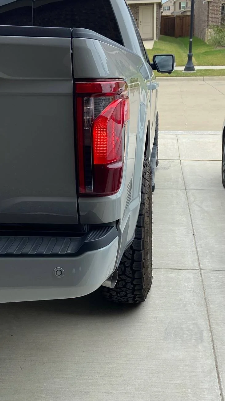

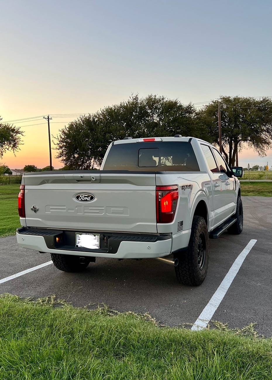

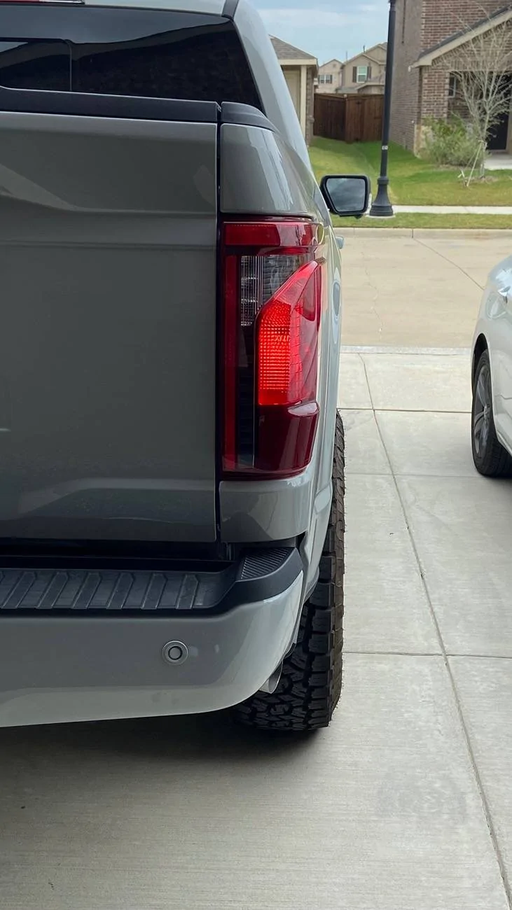

This looks so good. Seems with that 25 offset, the poke isn't too bad. Could we see a side profile of the poke? I want aftermarket wheels, but don;+'t want tons of poke because I drive lots of gravel.
My current Lariat has+20 fuel rebels and I had to add fender flares.
Picking up a 24 Tremor in a couple weeks and exploring my options.

Thank you! This looks perfect. A little bit, but not too much so it's not sand blasting the paint. I'll have mud flaps anyway. This may be the route I'm going to go. +25 offset and same tire size with similar tread

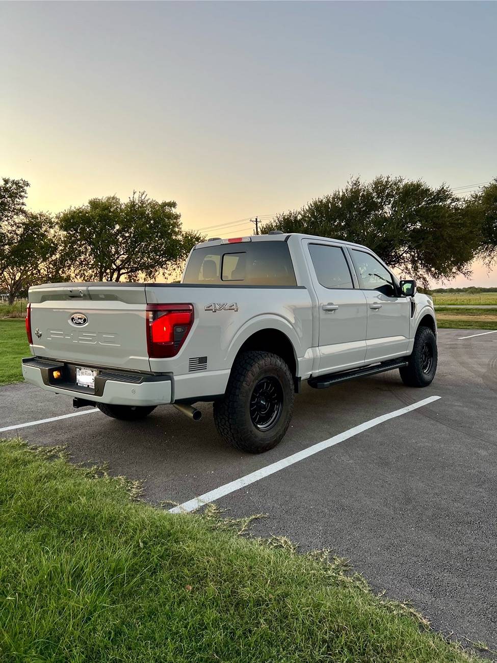

. Hey man, I have the same truck , do you mind telling me your tire and suspension set up?
Not at all.
Eibach Pro R2 coil overs with rear blocks removed. JBA UCAs and Nitto Trail Grapplers 35x11.50. 3/8” spacers in front and the tires just kiss the UCAs at full lock. I don’t think they would touch if I had the stock UCAs.

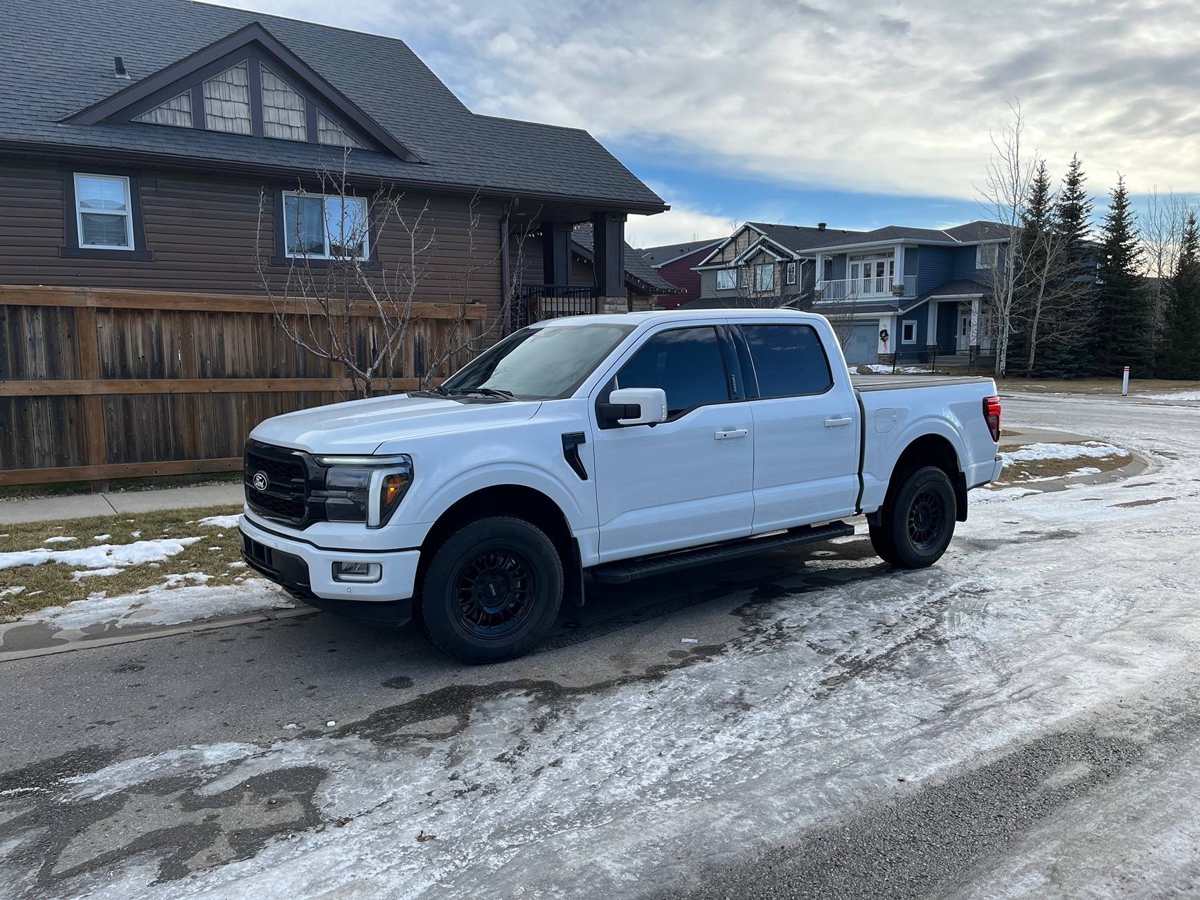

Good looking truck! I use the same wheels for my winter tires, but yours looks better with the beefy tires!

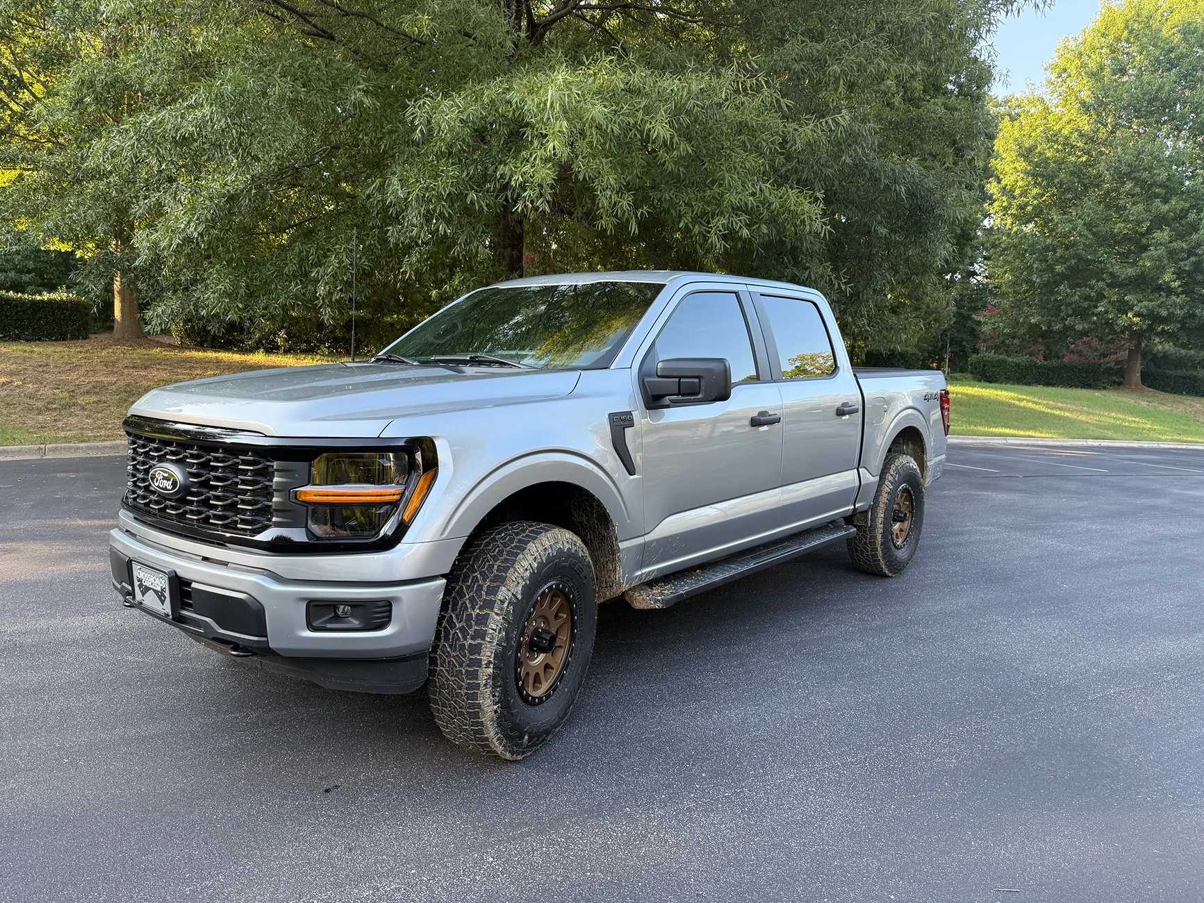

I used this as a guide for my ‘24 STX and I’m super thankful you wrote this up. I went with:
2” Fox 2.0 level kit
Falken Wildpeak AT 35x11.5
Method Race wheels 17x8.5 +25 offset
I have zero rubbing! I did not have to alter or remove my crash bars most importantly.

I love these tires, I had them on my Tacoma and they performed very well off road and in the rain which we get a lot of in NC. I was also very happy about C load, a lot of options were E and many people said they were too rough of a ride.
