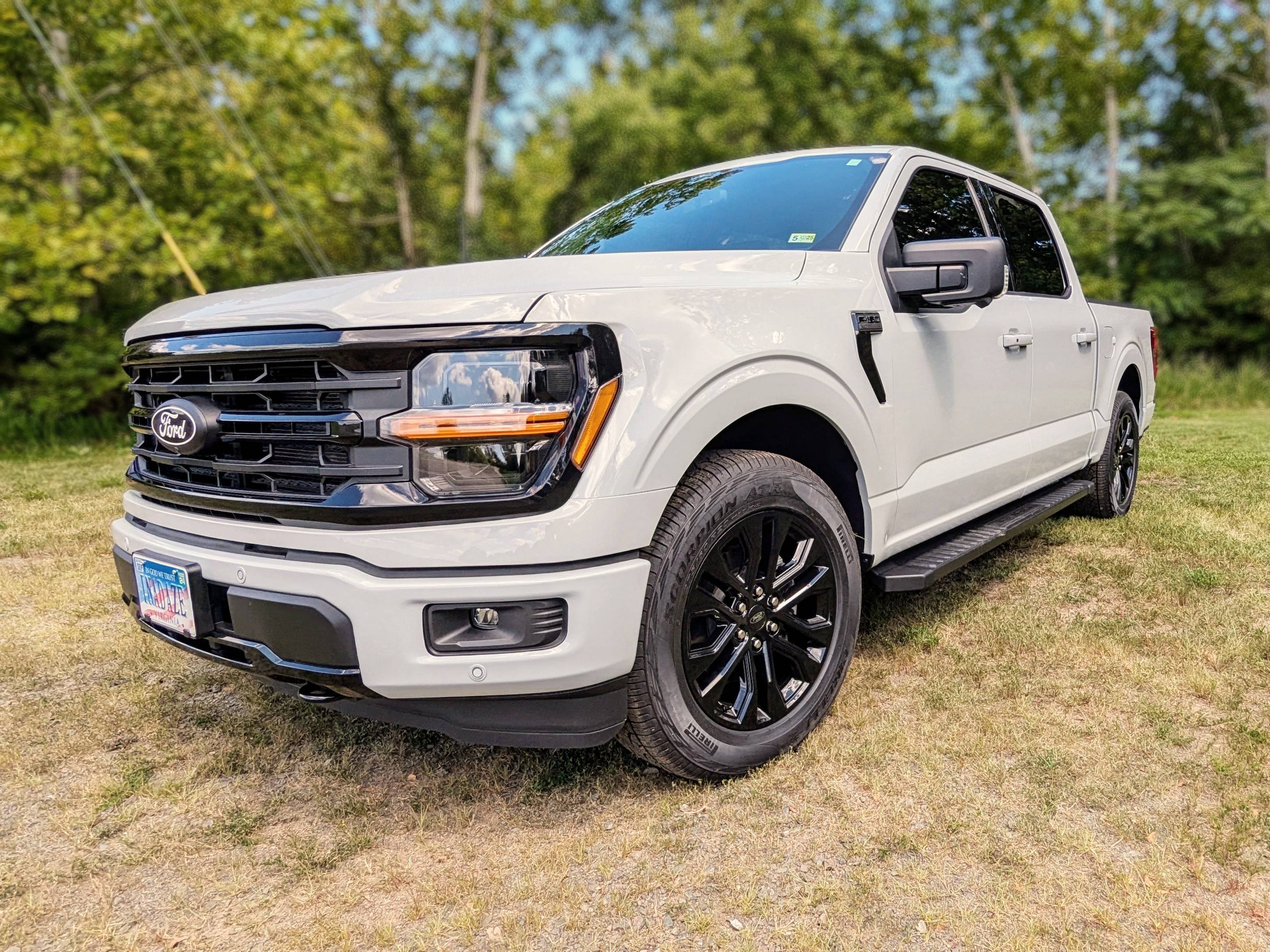

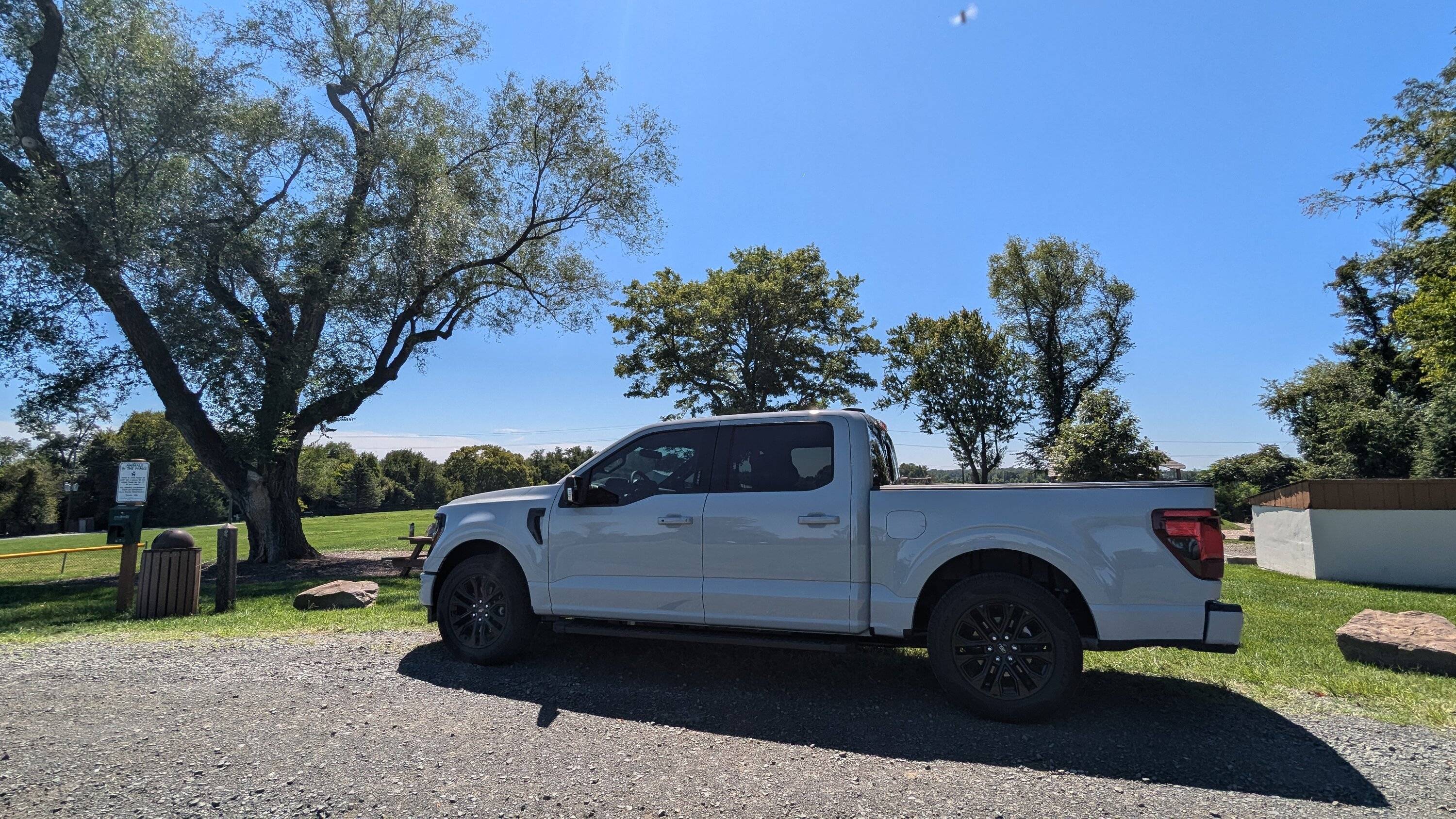

I've been running my '24 XLT Screw 4WD with the Ford Performance Lowering Kit and stock FX4 shocks for a couple months now and recently completed a 600-mile road trip. I noticed the sponginess or floating aspect of the stock FX4 shocks early on but it was just barely noticable during my normal driving around town, short trips, lower speeds, etc. It wasn't until a recent road trip that it became very apparent that the stock FX4 shocks aren't ideal long term. At high speeds on the highway, you definitely feel the floatiness on certain bumps.
I have no plans to off-road the truck nor tow anything which is why I went with the Ford Performance Lowering Kit immediately. I'll probably look at Ride Tech a couple years from now (i.e. paid off truck), but in the meantime I'd like a firmer/sportier ride on all four corners.
Based on my research, there appears to be three obvious options: Bilstein 4600 (4WD or RWD), Bilstein 5100, or Fox 2.0. I've been searching on here, but there isn't much information specifically related to the Ford Performance Lowering Kit and aftermarket shocks. Lots of feedback on levels, lifts, and fully lowered, but not this "slightly lowered" setup.
Does anyone have an real world feedback or suggestions? Obviously, I don't want anything that will lift the stance from where it is now.
Pics for clicks!
