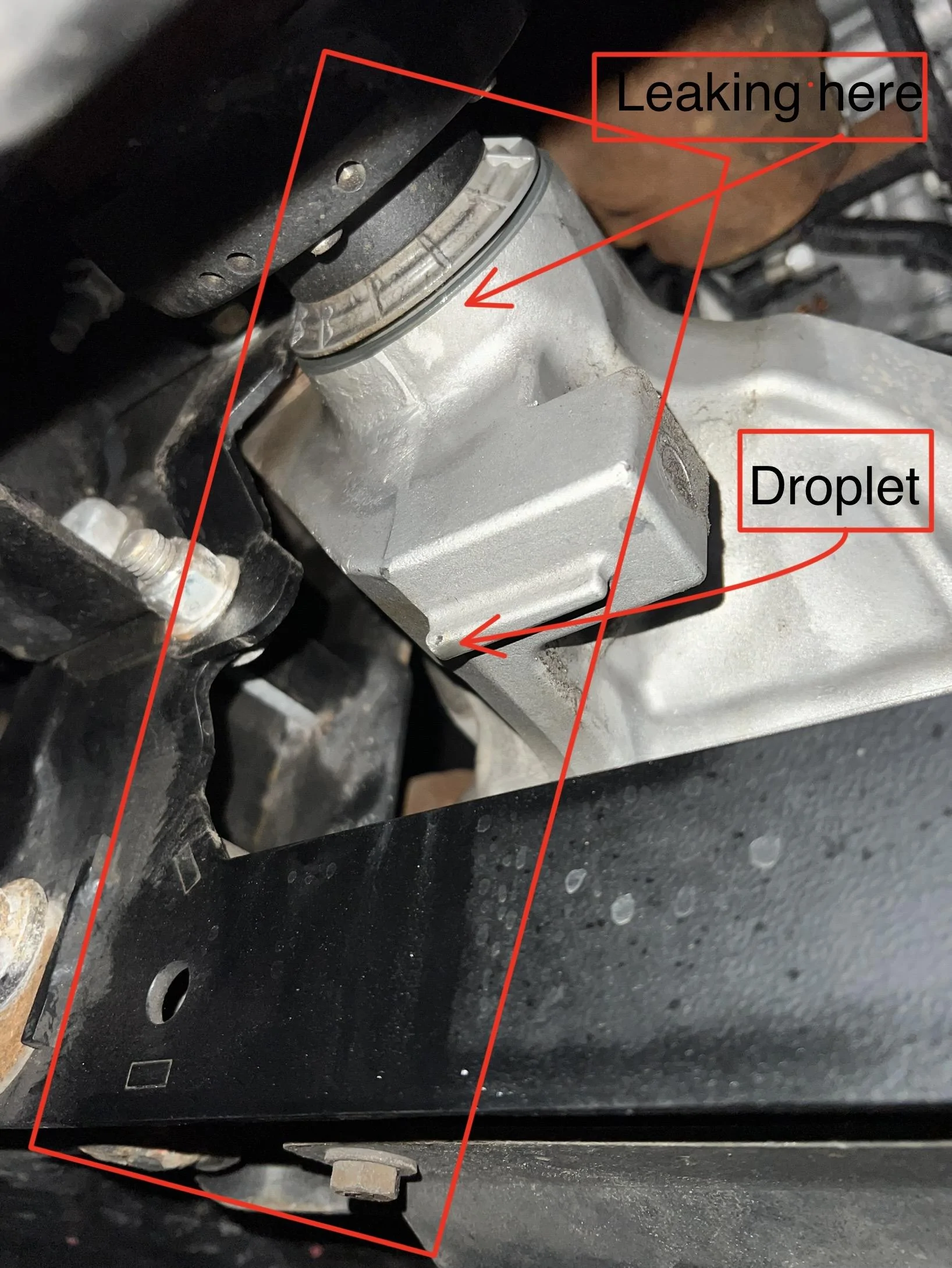

I have a 2021 F150 that just rolled 23k miles and it has a decent leak where the driveshaft goes into the back of the front differential.
Took it to my local Ford Dealership for warranty work and they said “yeah, it is leaking, but not enough that Ford will reimburse us for the work so we won’t repair it unless you want to pay us to repair it”
See attached pictures and quick video.
At what point is it considered a decent leak? It has an active drip after any driving.

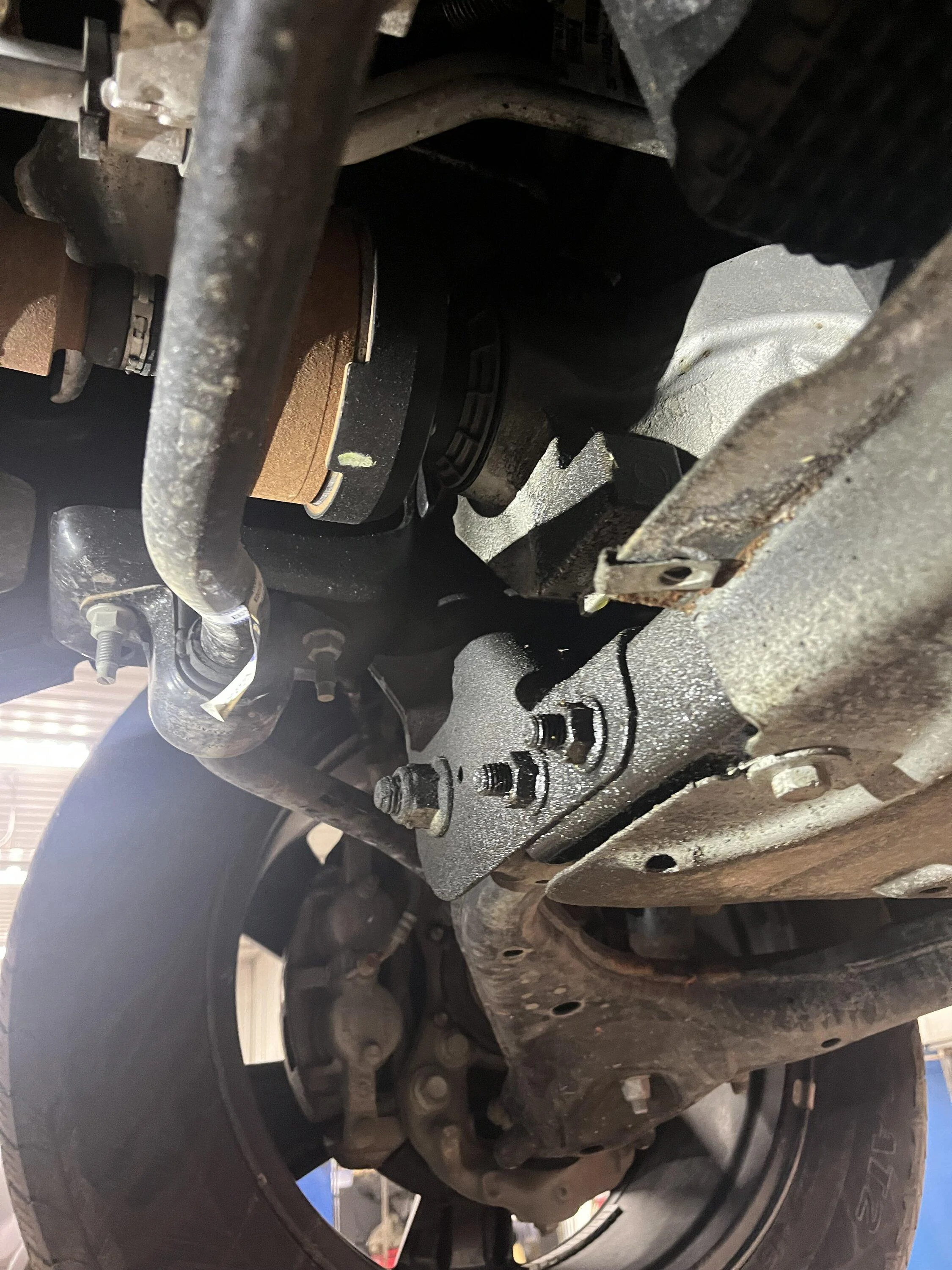

Your leak could be much worse...

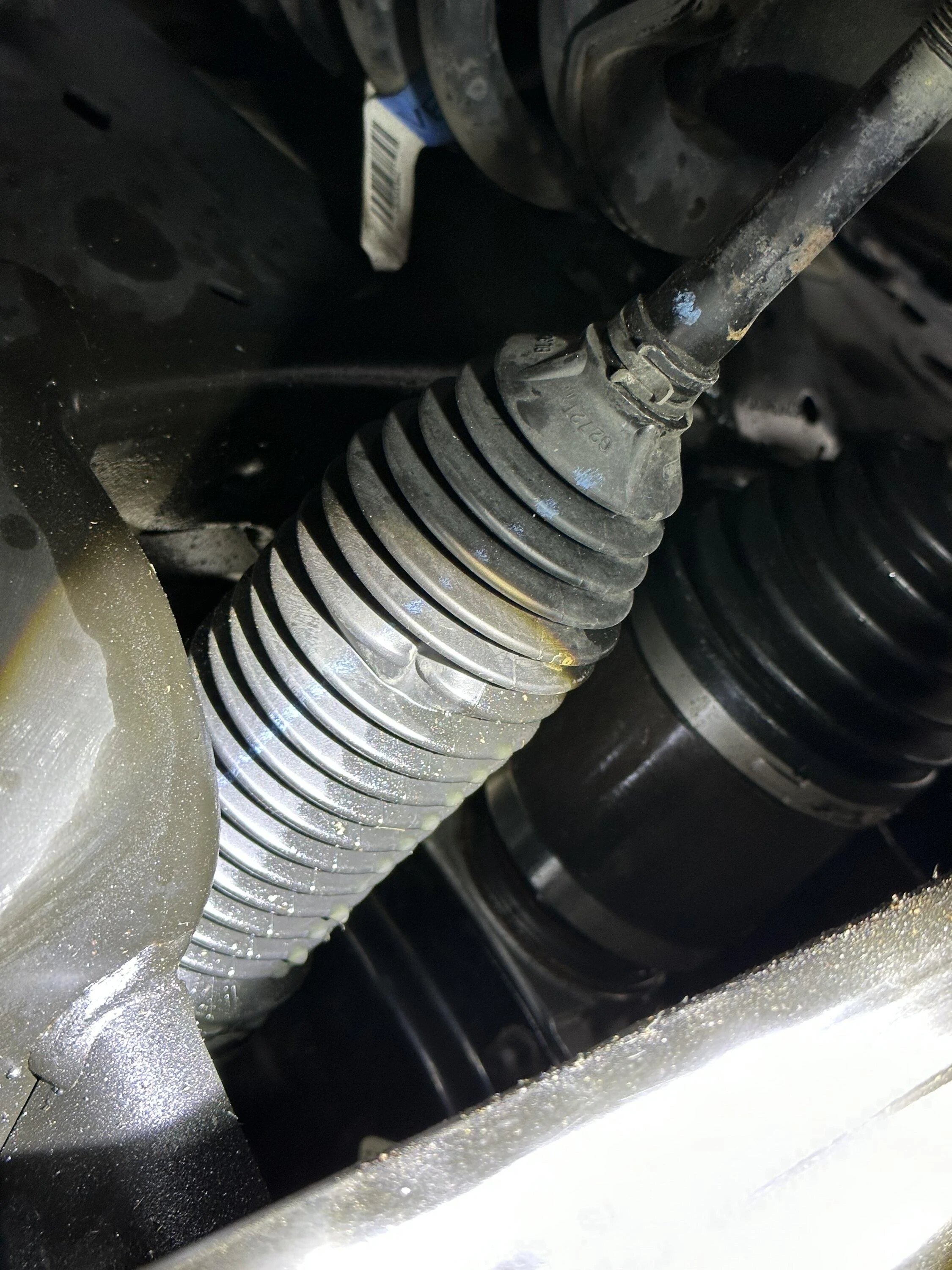

I’m getting mine back this afternoon and supposedly it is fixed. I’ve had the “repair” 3 times now. Last pic that was so bad I thought it was engine oil…it still could be. Service manager not listening. When I get it I’ll be pulling the tire and wheel off and dropping the skid plate and doing a thorough inspect on my own. 3rd time I’ve had it in for this repair.
