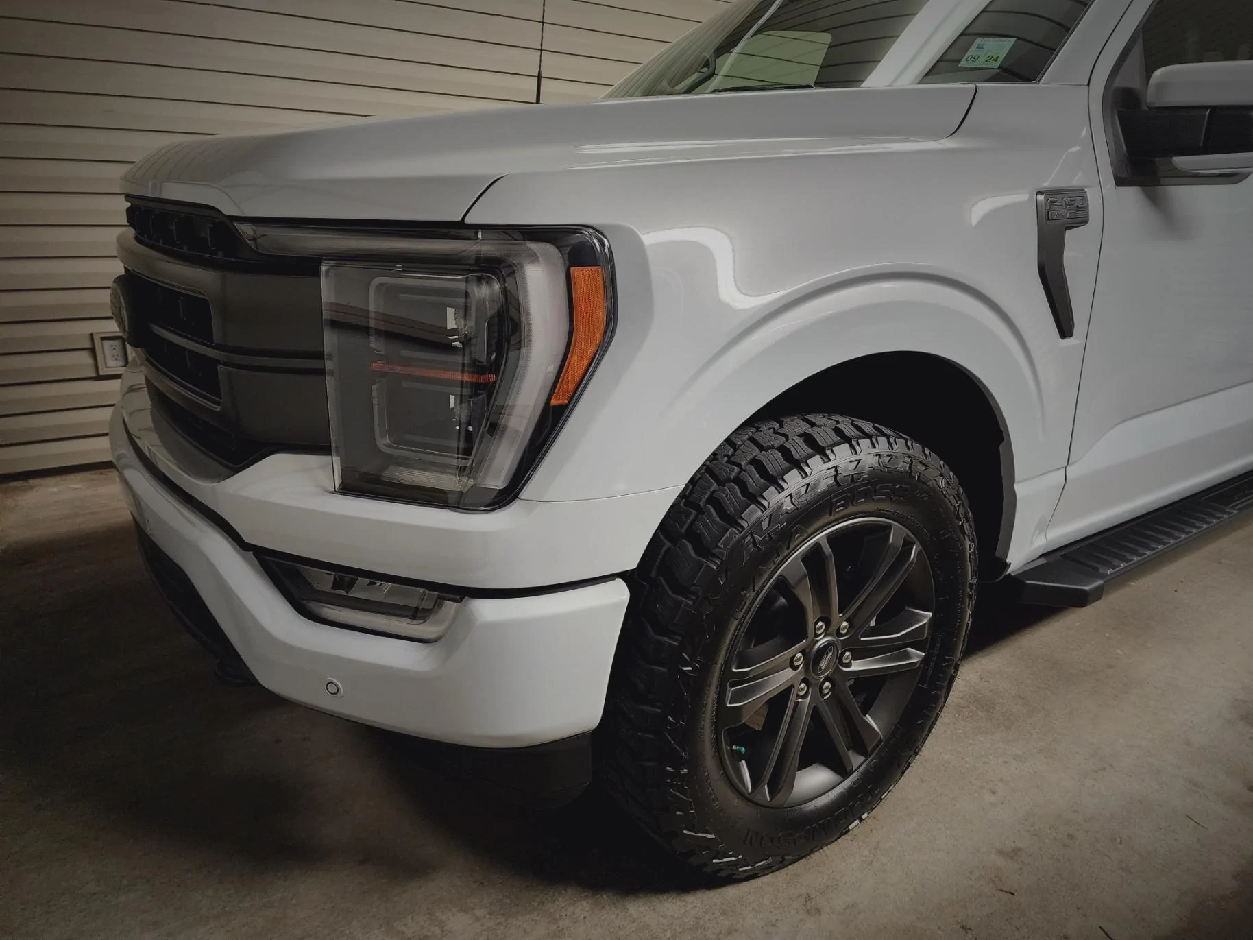

@Stage3Motorsports very interested in giving this truck a slight lift in front. Keeping stock size tires. Maybe 1, 1.5, or 2. Thinking 2 might be too high? Also would I need anything else? Control arms etc..?ty

At that height, no, my normal recommendations on control arms are when going above 2.5" of added front height, or if your someone that does some more serious offroading as the factory UCA will limit suspension travel.

I was looking more on your site and came across the bilstein and eibach replacement struts. These look like what I need. They give me the ability to lift from stock to 2.5. Which I'm thinking 1.5 would be sweet spot for me.
Any advice on which one is better, nicer ride etc? Ty in advance.

At the end of the day they are going to very comparable and leaving at the lower height will keep them from becoming harsh which they can on the tallest setting. I usually say the eibach are a bit better on the street and the Bilstein better Offroad, but not really a wrong choice out of the two.

Thank you very much!
