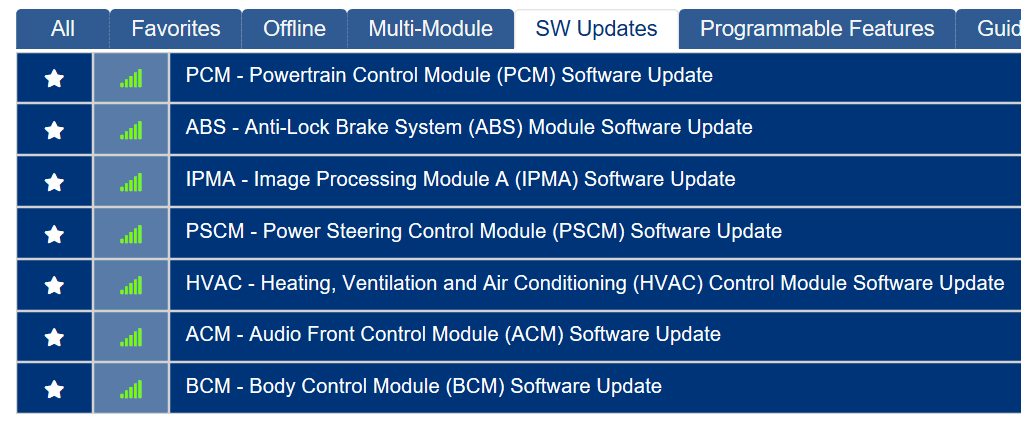

You're up to date on relevant software so follow the above thread for forscan changes. Here's the outstanding updates for your vehicle. For what it's worth you might look into adding the CCM which enables the autosteer of the truck
Ford F-150 '22 Google Maps in Cluster 1713630718989-60
You know if you add the CCM module (cruise radar), you'll get self steering as well as traffic start/stop auto following. A lot of those updates center around the latest bluecruise 1.4 control logic. It's about $450 in parts and 4 hours in time.
Wow! I didn't know that's all it would take to add that. Would I need to replace the steering wheel to add the cruise buttons?
No, you just need the left buttons. Crazy to enable the self steering it just needs the unit, its bracket and a harness.
