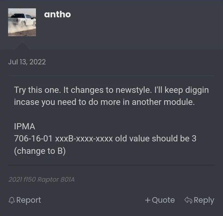

This is specifically what Antho suggested (below)
Keep in mind that I supplied him with my VIN because he was aware that my Park Assist delete truck was somewhat unique in that it arrived with all the visible hardware that wasn't expected for a Park Delete truck.
He cared enough and was generous enough to do the necessary research of my trucks AsBuilt and came to the conclusion that I might only need the one edit.
He was right!
Wow! I make a post and close my eyes for a nap, and wake up to solutions!
Thanks. This may have to be my first Forscan mod.

So is the consensus that if it's a car with Park Assist Delete, not a car that wasn't supposed to come with Park Assist at all, it might be configured with VCAPAI Oldstyle , and needs VCAPAI Newstyle at 706-16-01 xxx* xxxx xx--?

On my '22 tremor with park assist delete I just changed mine from 3 to B and now the front camera activates when an obstacle is detected. This awesome, literally didn't know what I was missing haha.

Just made my first FORScan update to my 22 platinum. 7/25/22 build with parking assist delete. After backing up all the asbuilt data, I made the 706-16-01 change, was 3 and changed to B. Front camera automatically turns on now with front proximity alert.

Good to see that another Park Assist Delete got their camera autolaunch with the tiniest of edits!
