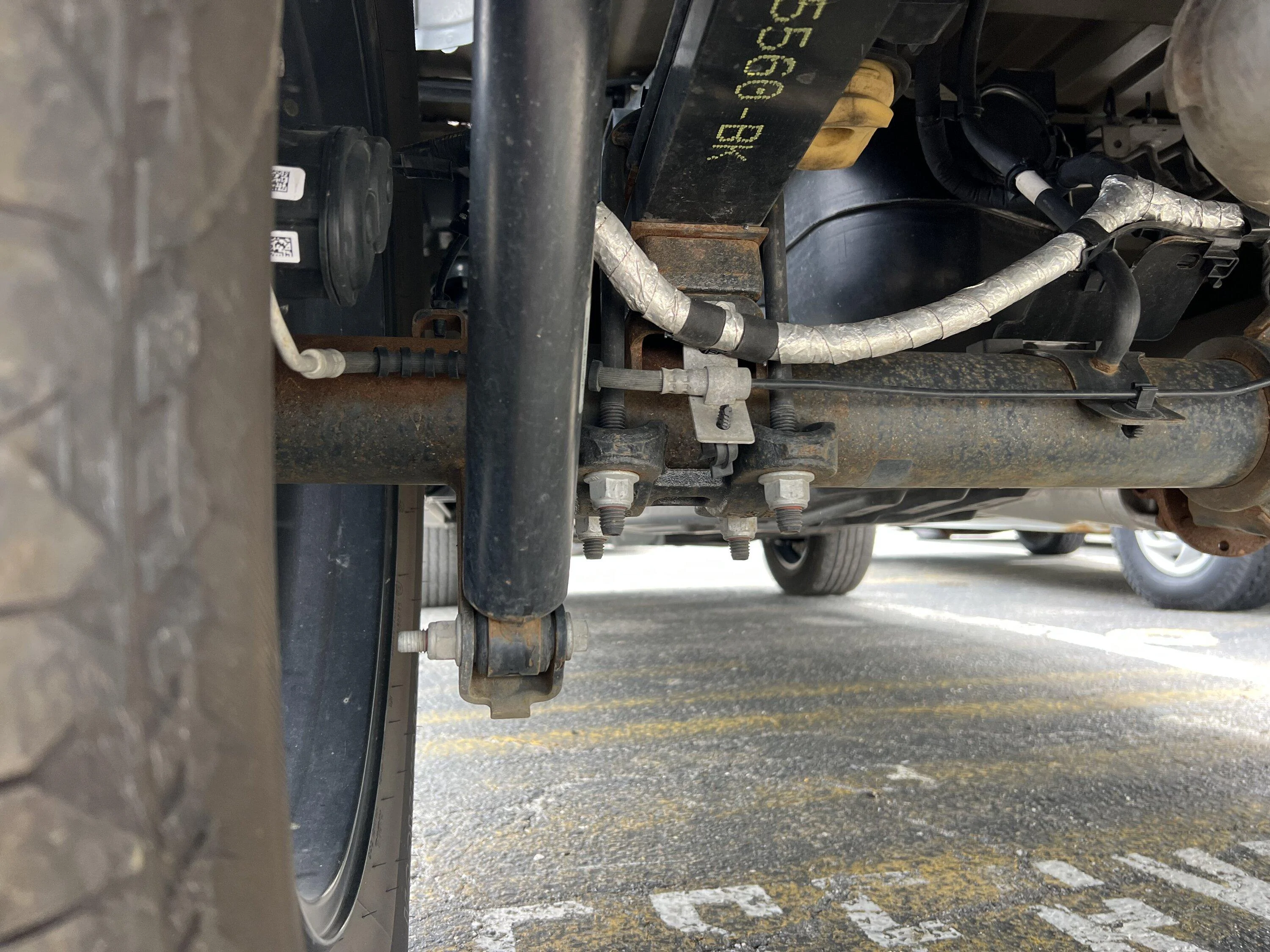

This is my friends 2022 F150 lariat with the 5.5 bed and single piece driveshaft. I just noticed that his axle was shimmed by Ford. His truck was delivered and picked up and has never been back to the dealer. I measured my drive line angles and shimmed just about the same thickness shim to correct 95% of my vibrations.

@NB64 can you be a little more specific with where you shimmed? And with what did you shim the axle? Would it be possible for you to take the picture above and circle where I should be shimming?
Before you shim there is two things you can try first. The first is load up the back of your bed with a bunch of stuff to lower the suspension. Then take a ride to see if that helps. If it does then it’s a clue for the dealer. The next would to buy a cheap digital angle finder and take some measurements. I can send you some videos that I found on the internet that I saved.
