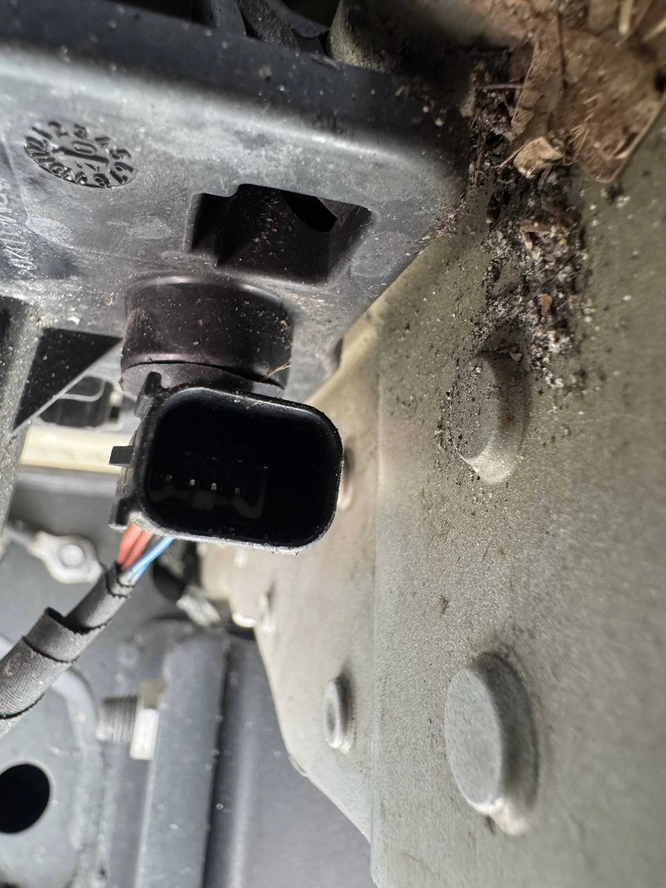

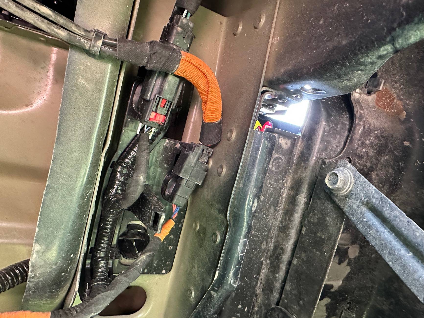

I looked under my bed on the driver’s side and saw a dummy plug and assumed I was good to go with ordering and installing the factory parts for the bed lights. When I went to install the lights I realized the harness for the lights and the plug under the truck were not the same. Then I saw I was missing the plug for the passenger side. Is there anyway to make this work, or should I just cut my losses? I have attached pictures of what I have.

That looks like the plug in for the bed auxiliary 120v outlet. The part with the orange wrapping. The bed light plug comes out of the main harness as shown in the pic. Just look up your current harness on Ford.com and cross it to a new one that adds the bed lighting package.

Found my current harness based on VIN, but not quite sure how to find one that has the bed light package. When looking at related parts, it shows the bed light jumpers, but not really sure if it's relevant or not.

You’ll will have to look through the rl3z13a409 harnesses start with “A” behind the 9 and go down the list until you find your current harness options exactly that adds the bed lighting package. I have a new “J” harness for sale cheap if it turns out to be that one.
