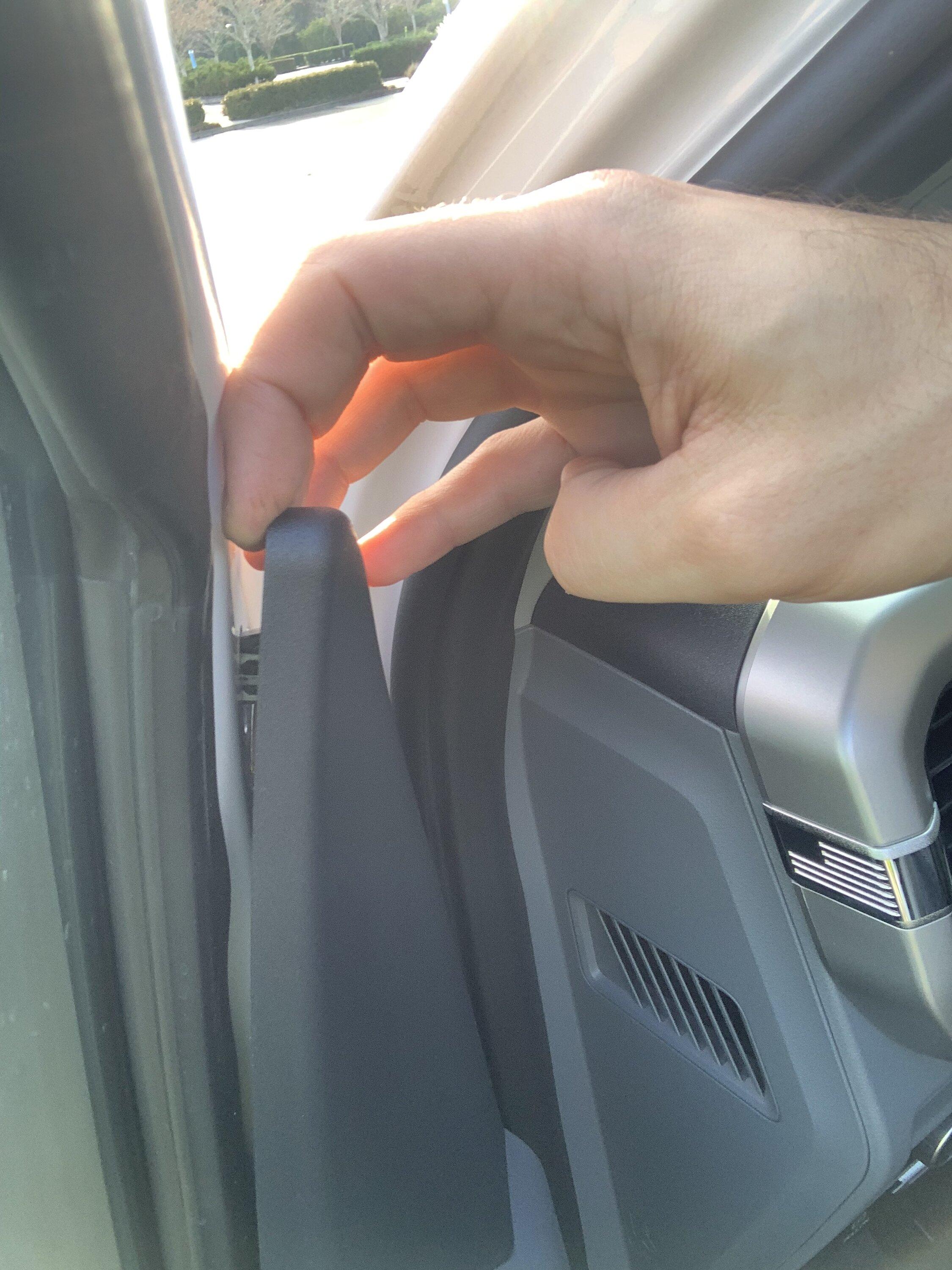

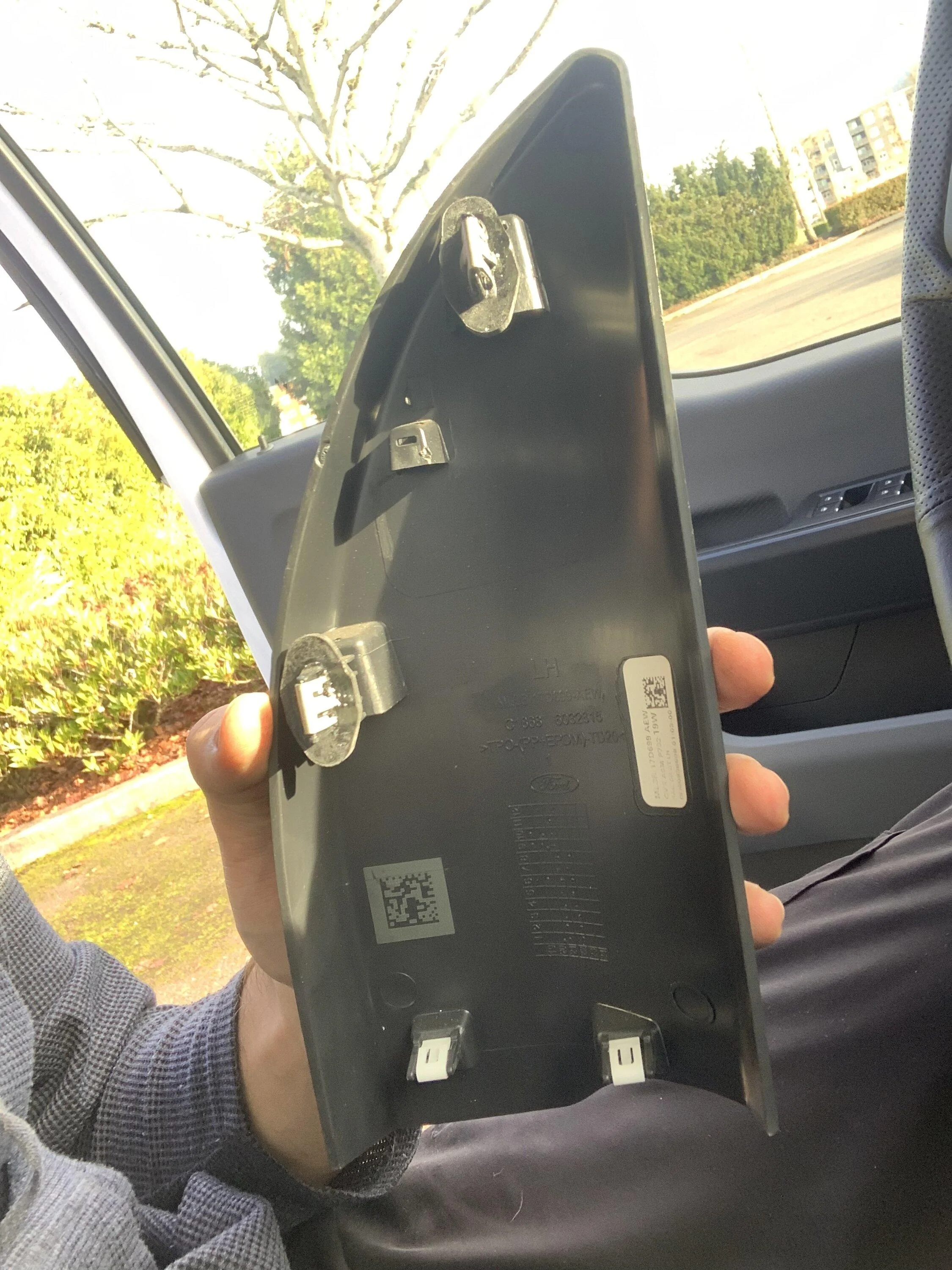

The easiest method for me is to just use my fingers and not any tools that would scratch the plastic. I just grab at the top and pry evenly. The bottom two clips are the ones that can break since they are plastic, but once the top clips are released you can easily get both hands in to hold it at the base to apply even pressure to pop the clips.
I pulled mine off to show you a picture of the back side and where the clip locations are

If you break or lose one of the white clips, they are available at your dealer.
