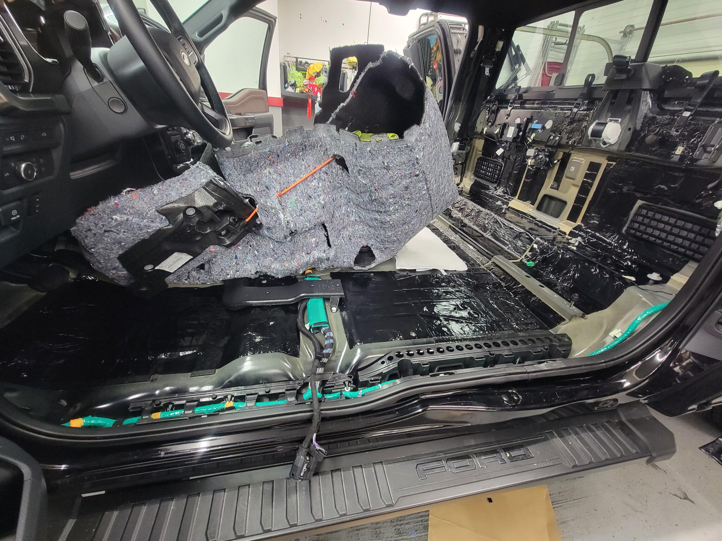

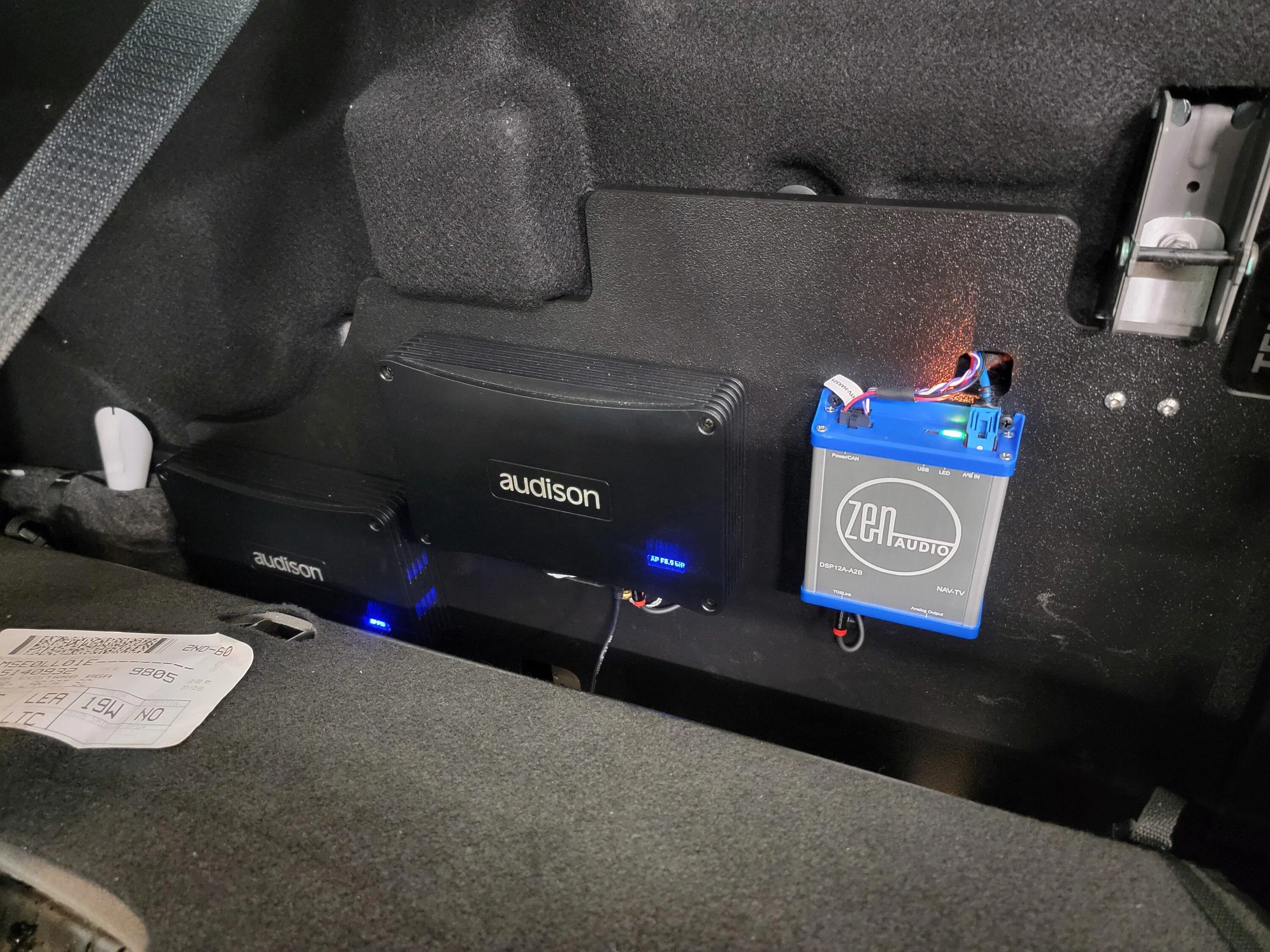

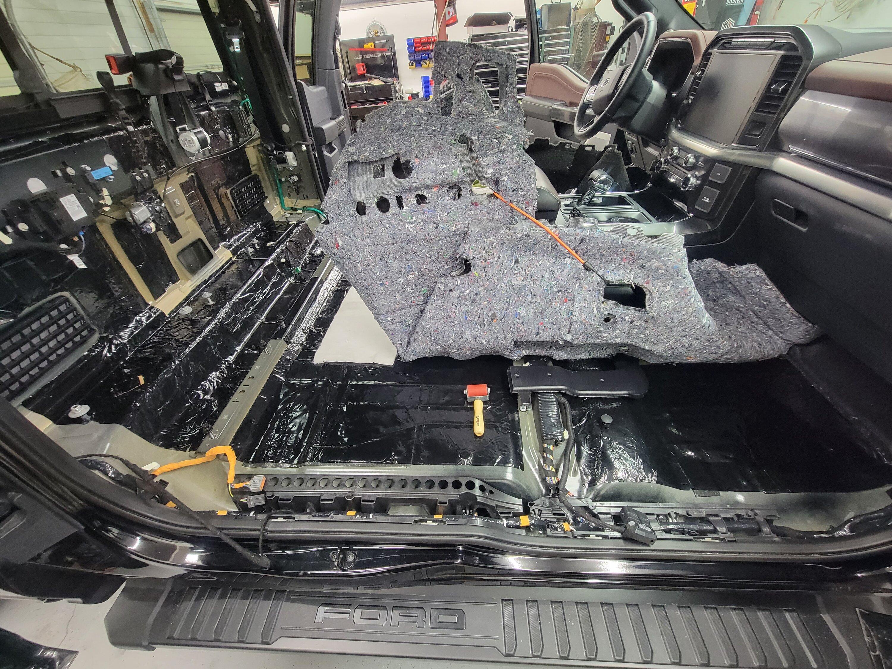

Another Audison install in the books.
2021 F150 super cab
Zen à2b via toslink

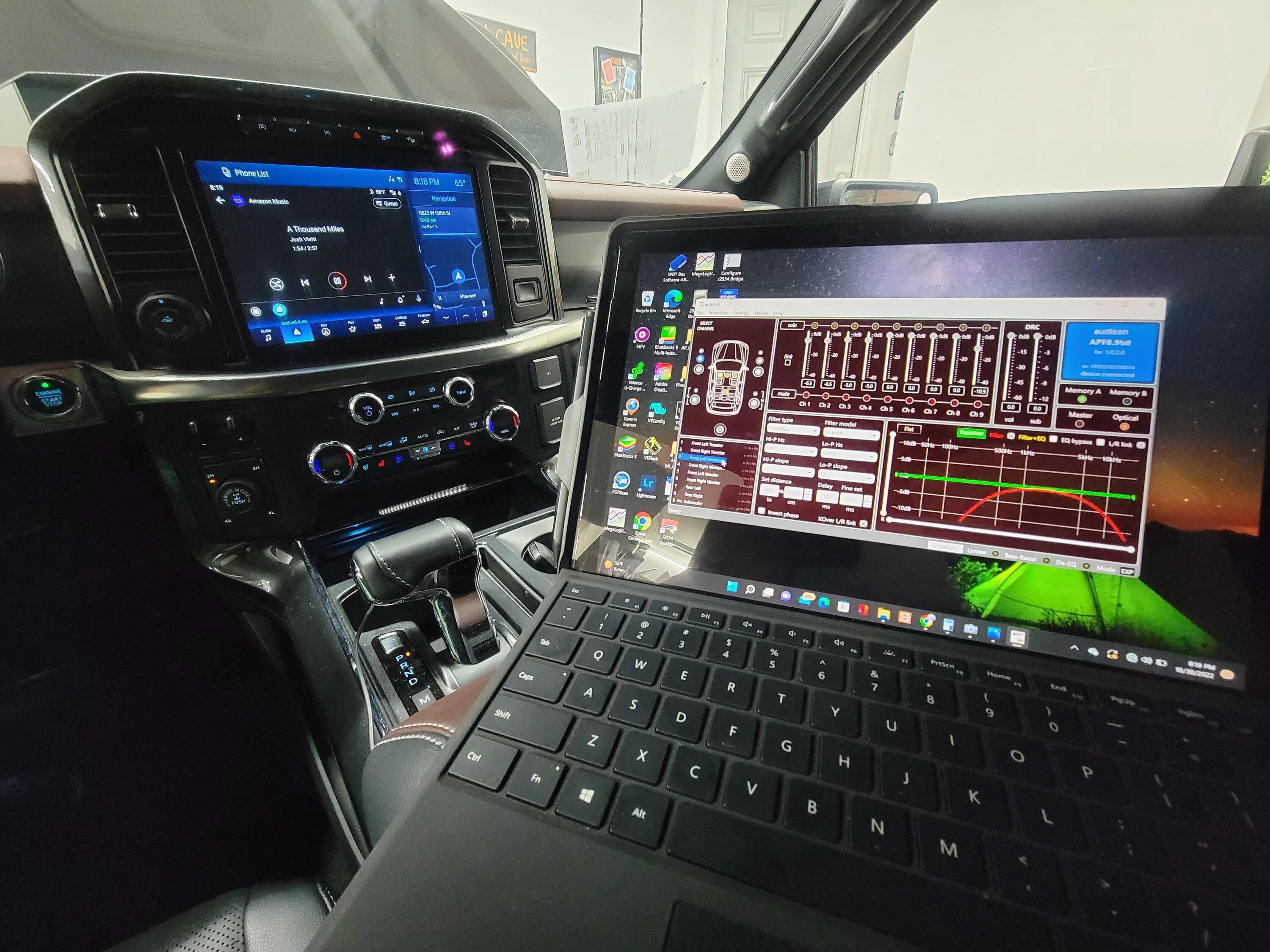

Audison apf 8.9bit (8chan DSP/amp)
Audison apf 1d (@1ohm 1krms)
Audison 8" subs dual 4ohm (2) in a downfire box
Infinity Kappas active 3way front stage 6x9/3"/.75"
Infinity Kappas 6.5" coaxials rear doors
Really surprised how well the (2) 8" subs carry out their duties. It's not a pair of 12s by any means but it's more than enough for anyone within reason.

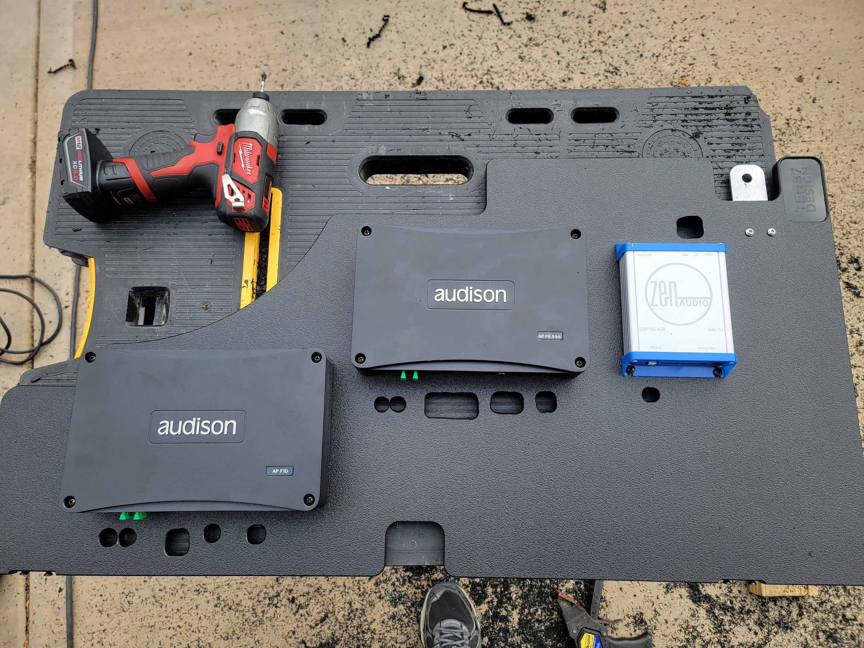

Since no one had done (or taken?) a 21+ scab to SgS or MTI yet, I was on my own to fight that back door blocker. Ordered screw back door blockers and traced out the plastic OEM blockers, cut it out and beveled with a router. Turned out nice.
I'll be mailing a plastic to each of them for future scab customers.
