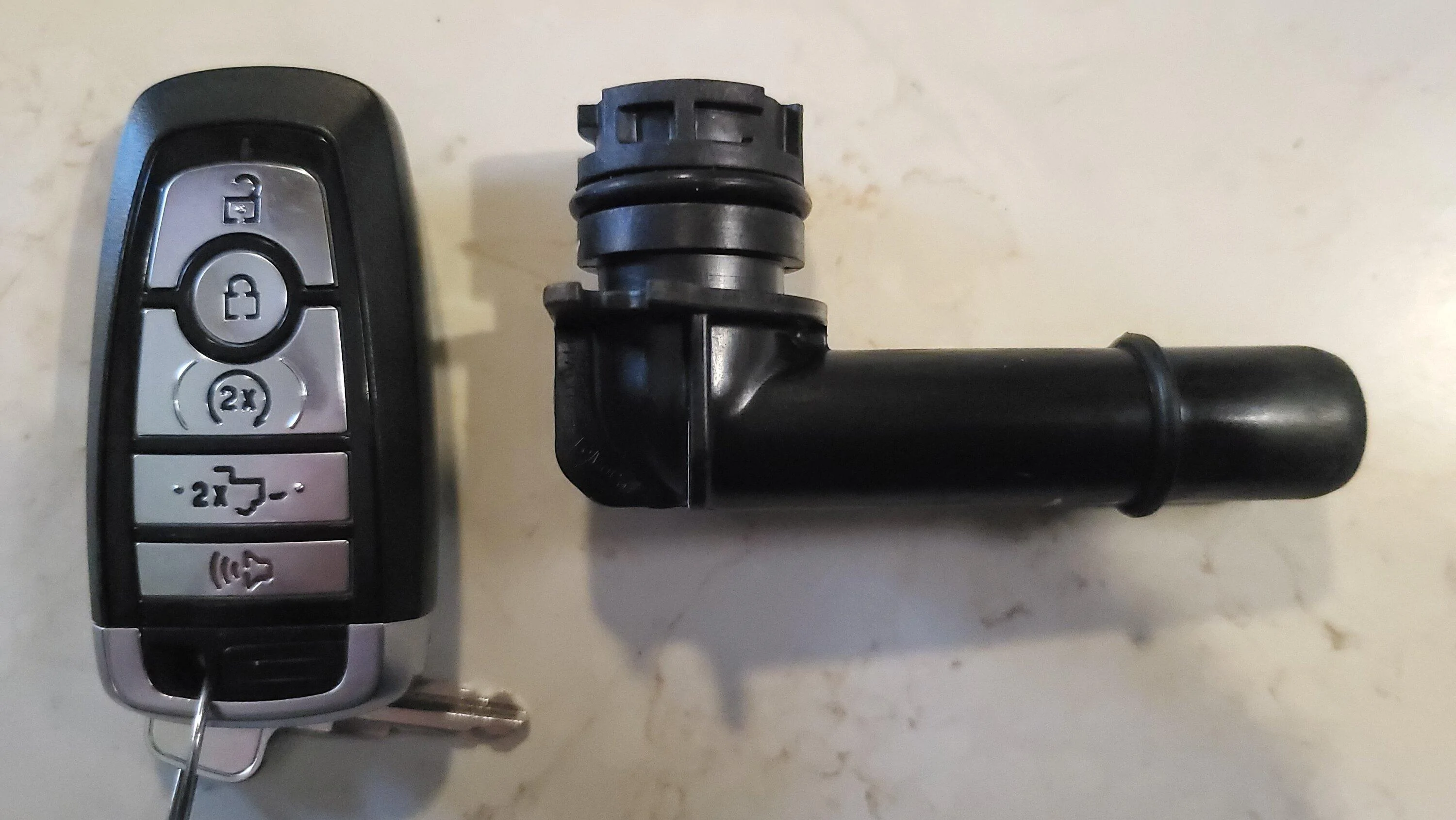

The leaking coolant tubes on the exhaust heat exchanger is not uncommon. I have spares for if/when mine might spring a leak. (Pic)
But I can't imagine how that correlates to a misfire.

Odd.
You were correct, my misfire was not resolved. It is still happening when I am 150-200 miles into a trip. This time the service engineer soon light stayed on. Dealer read misfire on cylinder 1 and set me up an appointment in a few weeks.
