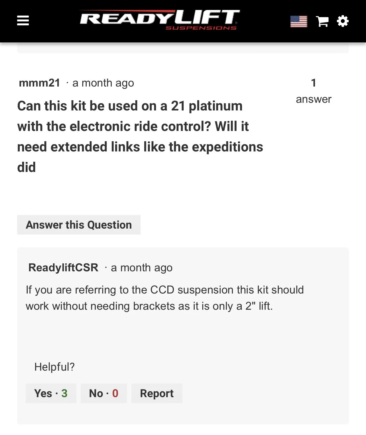

I’m still booked to get my 2” level Monday but checked the site tonight and saw this answer from readylift, further confirming the 2” will work just fine. I’ll be posting a thread with my build next week so look out for that.

Looks really good! I just looked at their website and it still states cannot be used with CCD--Conflicting info even from them!
Leveling kit 66-2120 fits both 2WD/4WD 2021 F-150 pickups in most trim packages and provides a nice level stance while maintaining the factory ride and handling. (The kit is not compatible with F-150 equipped with Continuously Controlled Damping (CCD) adaptive suspension.)
Check the QA at the bottom of the product page. Readylift responded that it works. It’s only 2” so the sensors were not relocated.
