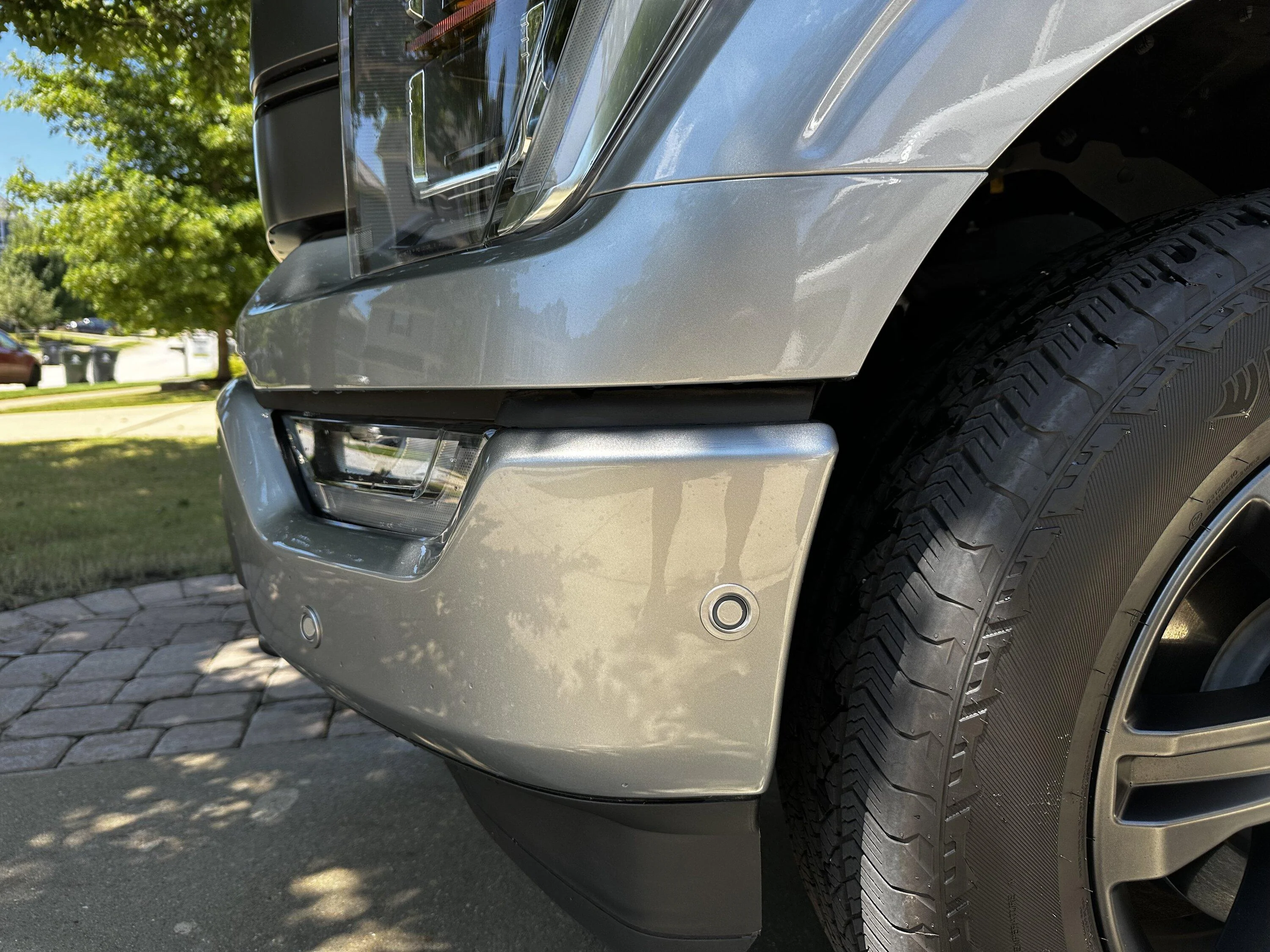

Had to have front bumper repainted, when the body shop put it back on they put it on a little crooked. The passenger side is pushed up and the driver side is hanging down. The guy at the shop wasn't much help and I didnt have time to sit there and screw with it.
It's not terrible, one side needs to go down about a 1/2 and the other needs to go up about 1/2"
I dealt with this once on my 2016 F150, if I recall correctly its as a matter of loosening the main bumper bolts, (having a buddy) pressing up or pressing down on the end of the bumper and then retightening. Is it the same for the 2021?
I believe there are 3 large nuts on the back side of the part of the frame that attaches to the bumper?
Any tricks to make it easier?

So I would have thought it was an east fix too, but climbing under there you only have access to two of the 3 bumper bolts/nuts. The "inboard" nut its completely hidden.

Sounds like a pita. Let me know if you figure it out. I'm wondering if there's a way to make that gap smaller between the bumper and grill. Pretty ugly inch of black space.

Definitely out of position
Wondering if it may have been hit or came in contact with something.
not only high on one side, low on the other, but it is not on the right plane either.
It appears to be drooping and the passenger side is not even close to lining up with the fender wheel opening.
that rubber strip on mine is just barely touching the bumper filler with bumper to filler (w/o strip) about 1” gap.
Don’t get it too close as the bumpers move around a lot on rough roads, so clearance is needed
going back and looking again
Is the bumper twisted?

Still want to tweak this thing a little, any suggestions on how to reach the 3rd bolts?

Easiest way to access all of the front bumper nuts is to remove your grill, can access all of them from the top of the bumper. I am a collision technician for a Ford dealership and remove at least 2 front bumpers a week.
