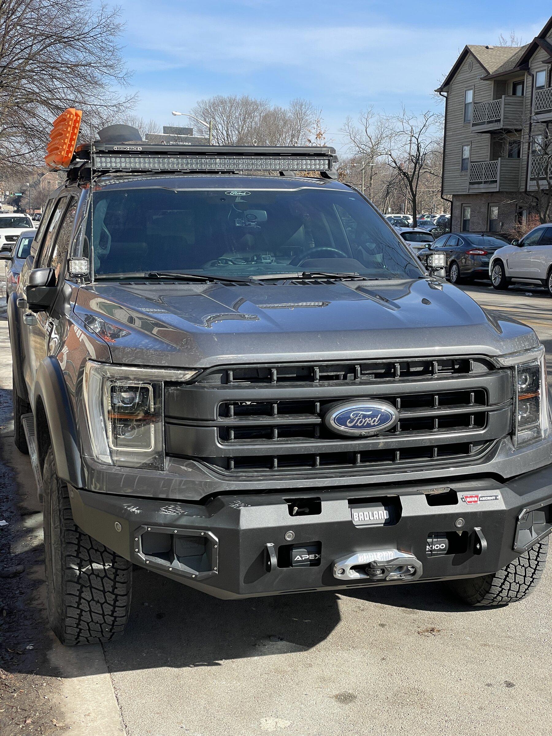

Unless I got confused, I think I saw a YouTube with a guy's f250 Tremor that had a very OEM looking bumper with a winch set up. Anyone know if that can be installed on my 3.5L EB supercrew?
My uncle has that on his F250 Tremor, and you cannot tell that it has a winch unless you get close. The huge issue for EB owners is the intercooler location. The bigger issue for PB owners is that nobody even knows if their intercooler relocation kits will work, but most safely assume that they would not. My solution is a hitch mounted winch, but that runs into the issue that nobody makes a front bumper with a hitch mount.
