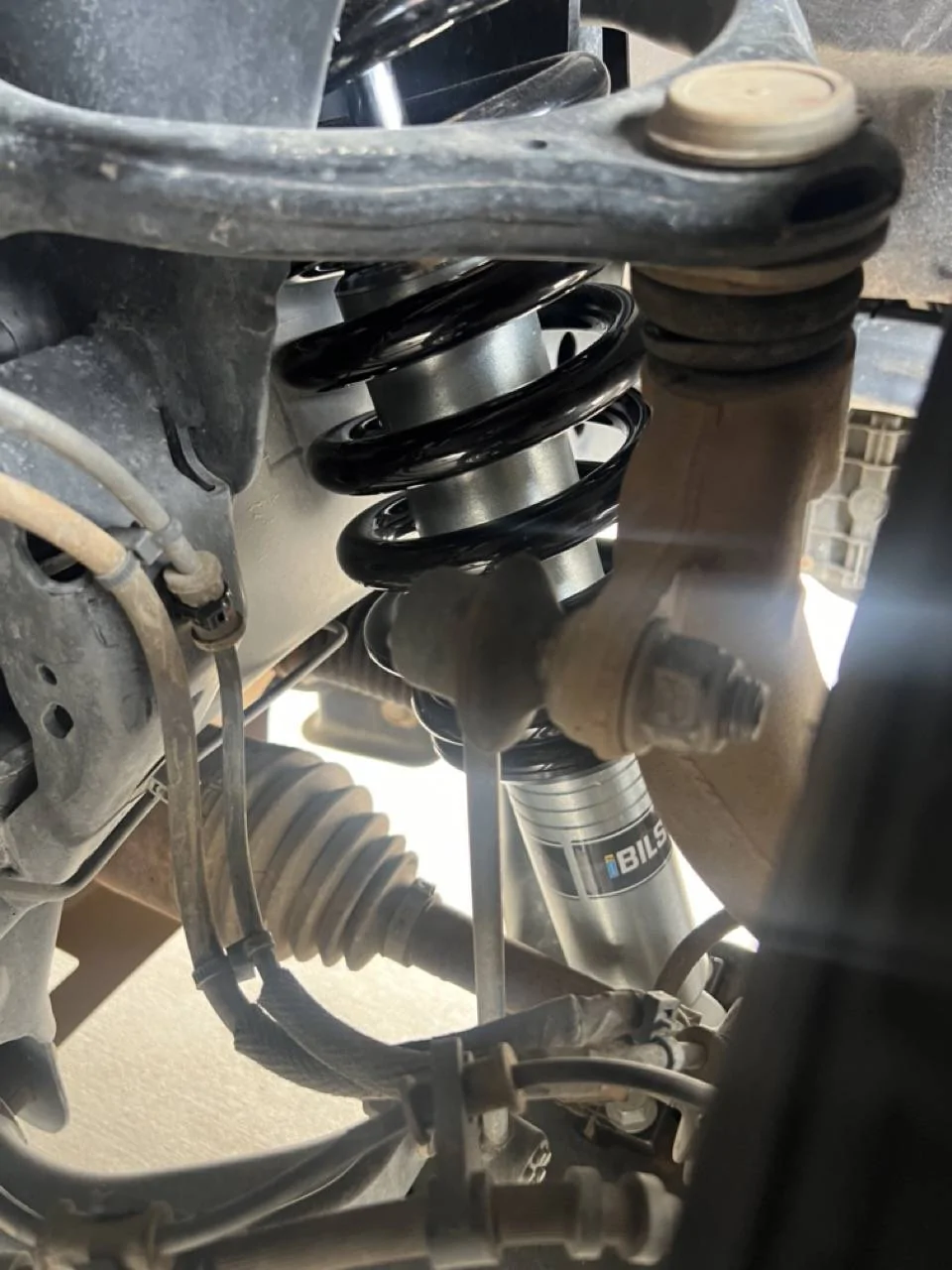

Thanks for responding, the CV doesn't appear to be bad at all from what I see, I wonder if I upgrade my UCA's I can get on the last perch. I'll reach out to Bilstein.

Cv angles look good to me

agreed, looks good, i'd prolly go for the next setting too. when you jack the truck up how much down travel do you have? IFS only has x amount of down travel. lets say 8" to make it easy. stock ride height youre probably at 4" up travel and 4" down travel. Now if we level it with 2" of lift, you are down to 2" of down travel and 6" of up travel. You can see what will happen if we keep pushing the limits of the geometry of the stock arms.
changing ride height does not change the overall arc that the wheel swings in. it just changes the "resting" point. This is why i always laugh at the "well if i level my truck will bigger tires clear" sure, they'll clear until you actually cycle the suspension on your way to starbucks hitting curbs.
