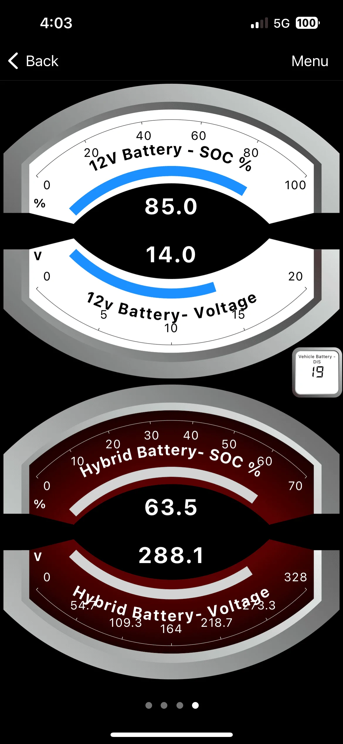

Where do I find the SOC PID again?
I’m sure mine is ideal but just so I can properly follow the conversation.
How do you lose a PID? ???
OBDlink app
Ford/Lincoln/Mercury library
BECM module
"Target/Desired SOC for Battery"
By the way, that label is misleading because it is not reflecting Target or Desired SOC. If it did, it would be a static value, or one other than the current SOC. Instead, it reflects Ford's value for the current SOC, which is close to, but not exactly what the published SOC for an AGM battery.
I say that because I always have an external Bluetooth voltage meter on the battery and it gives a more standard SOC value vs Ford. But the variation is usually less than a couple of tenths of a volt, statically speaking.
OBDlink app
BECM module
I've already stated it in various threads, but the latest battery charging strategy is so much improved that I think it is a matter of time and the whole 12V battery drama will become a shadow of what it's been since the release of the Gen14 trucks.
Or put it another way, only trucks with above normal parasitic drain, or trucks that sit idle for lengthy stretches will suffer the low voltage blues. Which will be such a breath of fresh air around here.
I'm curious if this software patch wasn't at least some of the delay on the 2024 F150 release? One part of Ford putting the pressure on another part of Ford to FIX some of the things that were getting kicked down the road for way too long.
It’s such a foundational improvement in real life confidence and reliability. Absolutely fantastic!
Edit: Thanks for the PID!
Battery Pack State of Charge (SOC) refers to the HVB then?
"Hybrid Battery State of Charge" is what OBDlink labeled the PID for the HV battery. Same module, by the way. At least in the version I have.
I think the 2023's have a whole new PID library and I don't know if the labeling is the same.

On 2023 I'm using:
Body Control Module -> Vehicle Battery State of Charge Estimated...
Same here, with OBD Fusion on a Veepeak BT+.
