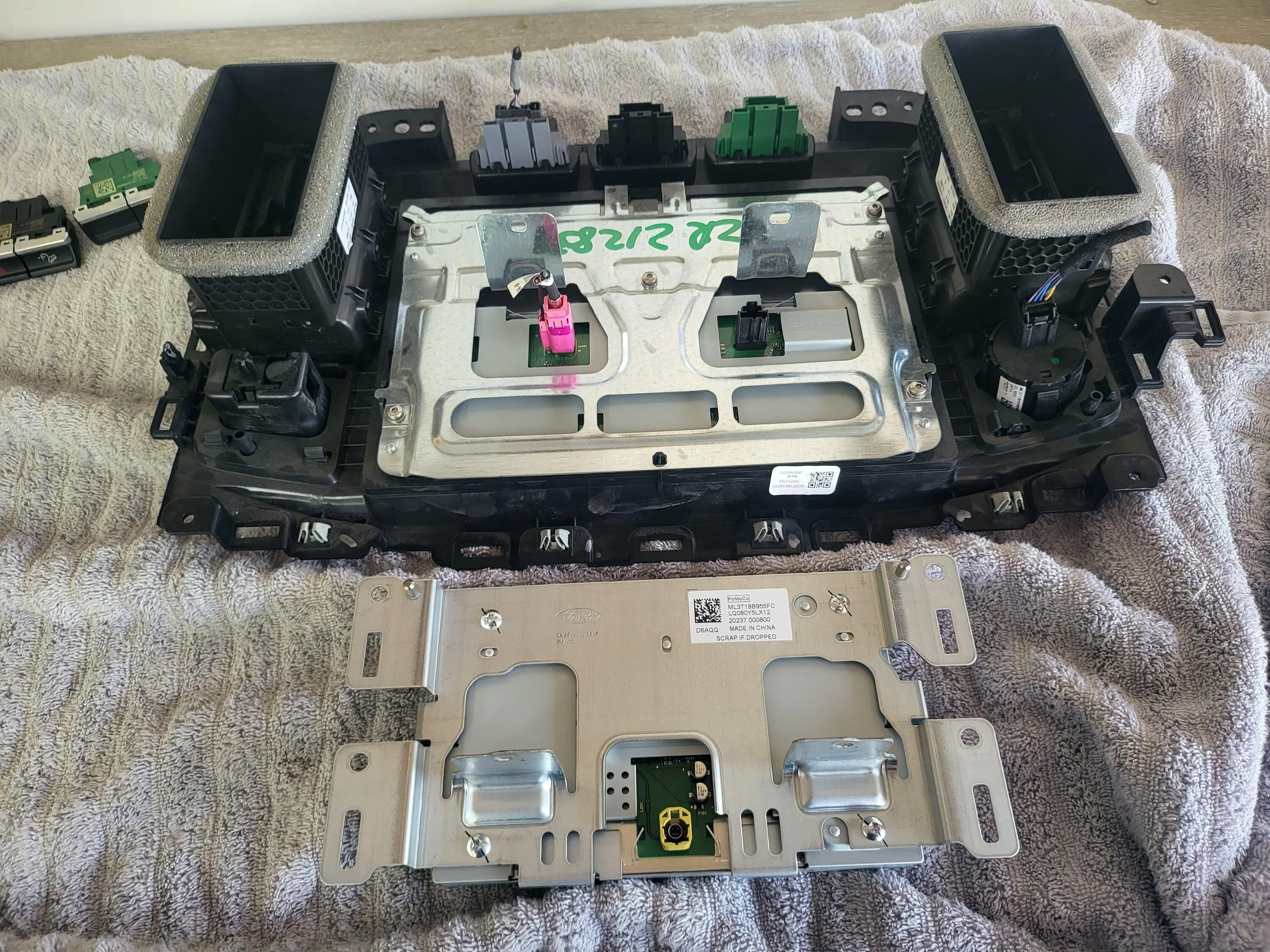

Good afternoon. I read a bunch of comment saying that an swapping APIMs to the 12 inch unit was not necessary with the 12 inch conversion. I've got the new screen in but it will not turn on, I can't help but think it's the two wires on the side of the new nav/apim connector that have no spot to plug into the 8 inch apim. Does anyone have any insight on this or information on how they did their conversion with the 8inch apim?

I'm digging deep, I think I'm figuring it out. I have pictures documenting it all. Any chance you have any info on the forscan changes required?

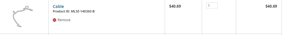

The 12" screen requires an extra power connector.
This video helps:
WPT-982

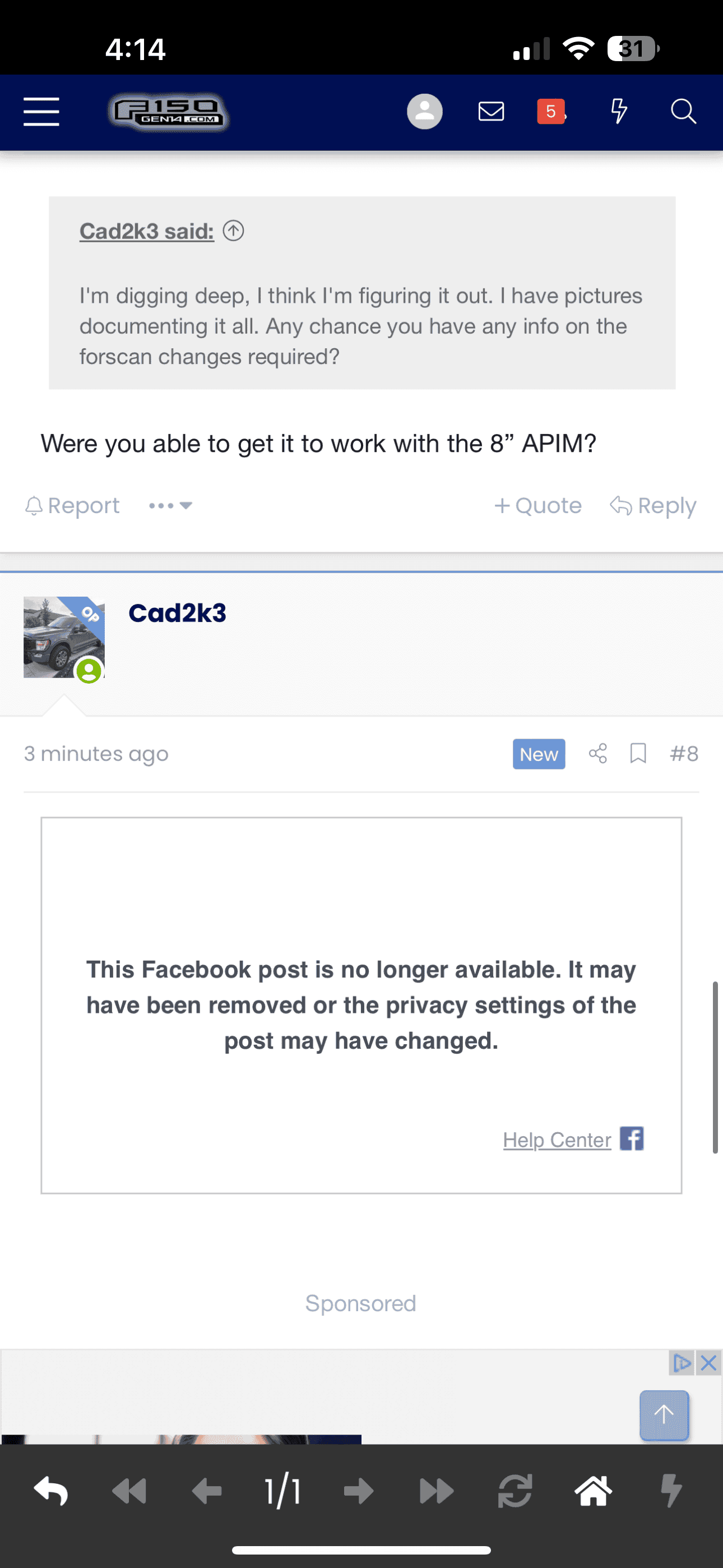

Were you able to get it to work with the 8” APIM?
