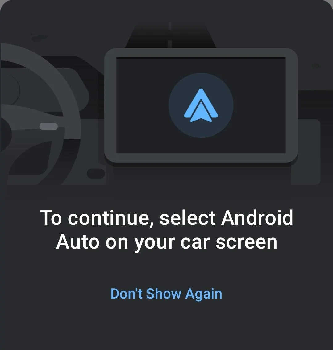

Curious to see if anyone else is having this issue. Phone says to choose Android Auto on the screen, but there is no choice that I'm aware of. Normally after 10-15 seconds Android Auto would just appear next to Nav after the the WiFi connection between the phone and truck was established. Worked fine wirelessly before the phone update. Wired Android Auto still works fine.

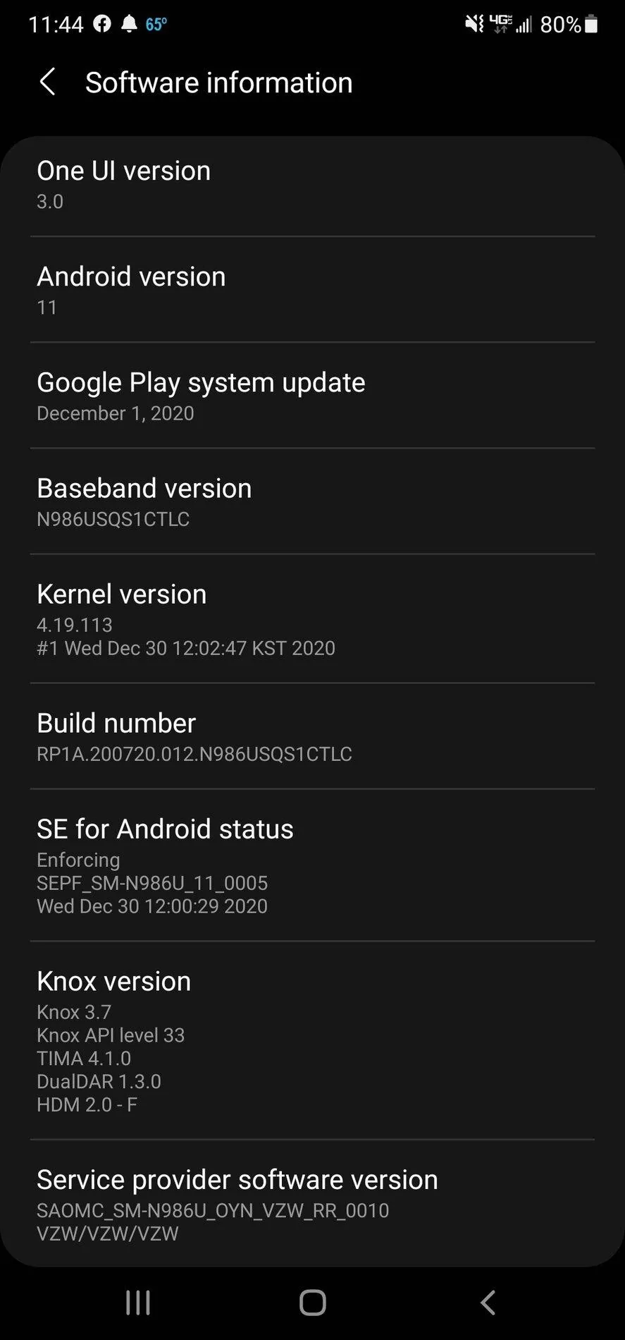

My phone just updated to that UI and version this morning. There probably is a correlation, because wireless AA worked well for me up until the update this morning.
Wonder if something changed with Android that Ford needs to account for?

I get this when my phone connects to my truck wirelessly, but the Android Auto button doesn't show up at the bottom of the screen.
