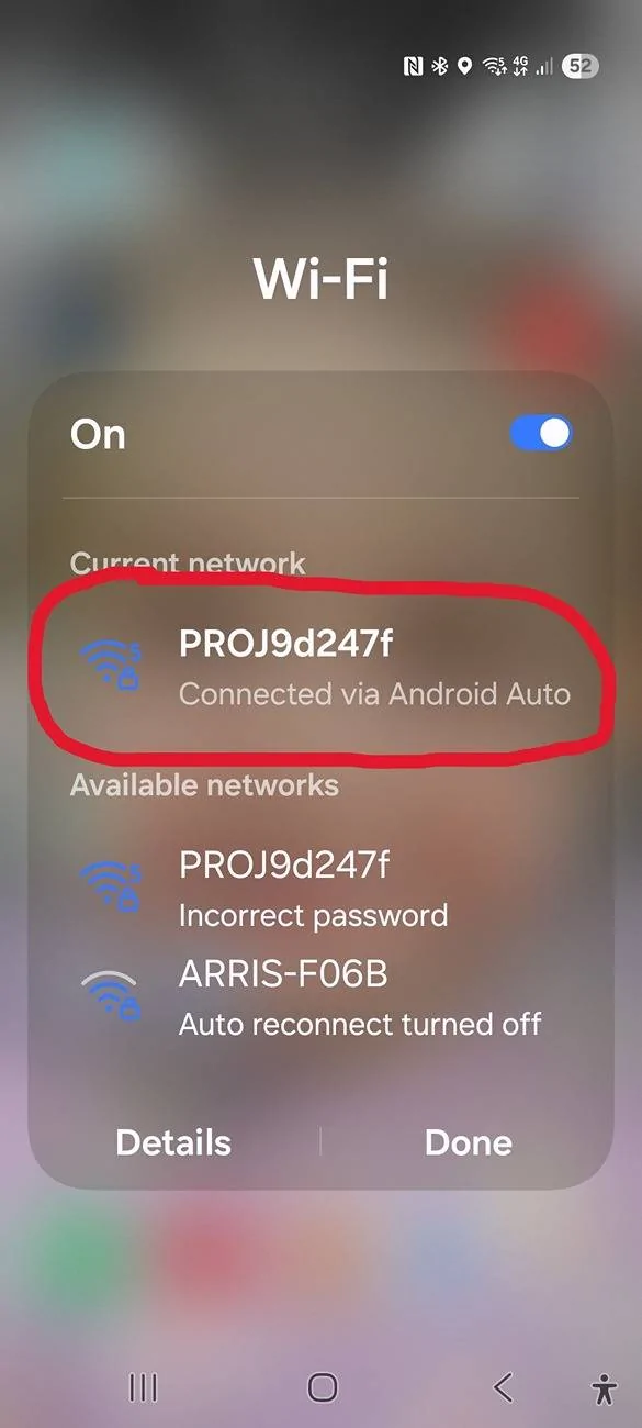

1. The phone is connected to the truck's wifi. Not sure if it matters, but it is connected.
Ford F-150 Phone won't connect to Android Auto via Wireless after Android 15/One UI 7 Update Connected to truck wireless

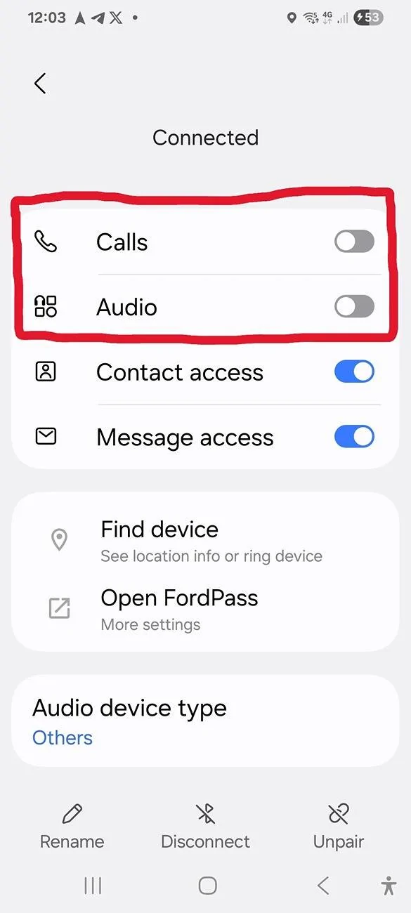

2. Turns out that the problem is the two BT settings Calls and Audio. This continuous connecting/disconnecting happens when the two are ON, or "connected for calls and audio". When they are off, as in this picture, it will hold a wireless Android Auto connection.
Ford F-150 Phone won't connect to Android Auto via Wireless after Android 15/One UI 7 Update BT Calls & Audio
3. The problem is - when these two are OFF, I see on the SYNC screen when a call is coming and I can even answer the call by pressing on the SYNC screen, however I won't hear the phone ringing through AA nor will I hear the caller. Weird.

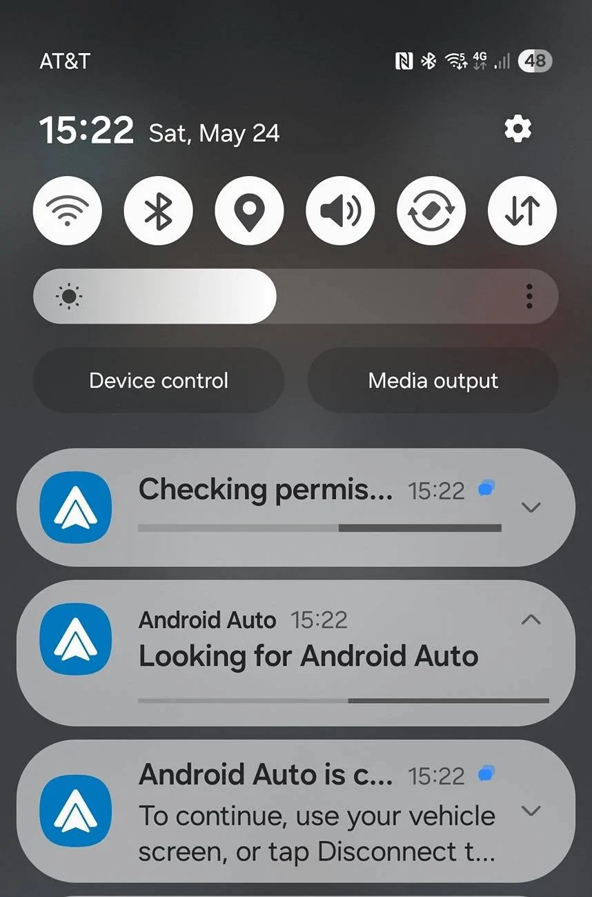

4. Even while connected, the phone keeps searching for Android Auto:
Ford F-150 Phone won't connect to Android Auto via Wireless after Android 15/One UI 7 Update Android Auto Connected While looking for Android Auto

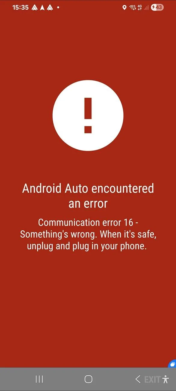

6. I can disable Wireless Mirroring in SYNC and connect via USB cable, it connects and works without a problem, but it's a PITA. It also throws this error message - again, not sure why because it is connected and working:
Ford F-150 Phone won't connect to Android Auto via Wireless after Android 15/One UI 7 Update Android Auto Emcountered an Error

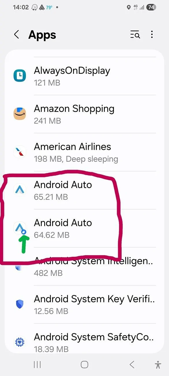

This issue may have been resolved, meaning - I believe I found the cause.
Turns out that I have two instances of Android Auto app installed on the phone, which probably happened during the phone update. One of them has a little blue thingy on it, as you can see in the screenshot below, not sure what this blue thing is, but both instances are the same version. It looks like that while the phone connects to SYNC through one of the AA Apps, the second instance is trying (and succeeding) to connect, disconnecting the previous occurrence, then they switch "turns", hence the constant connect/disconnect.
You cannot uninstall AA from the phone in late Android versions, only Disable it. I was worried that it would "Enable" itself after a while, or after a phone re-boot, but several phone restarts kept the "Blue version" Disabled and the phone connected wirelessly to SYNC and remained connected, so hopefully it will remain like this.
One interesting thing is - while Disabling the blue one kept the other one Enabled and active, disabling Permissions only in one app affected the other.
