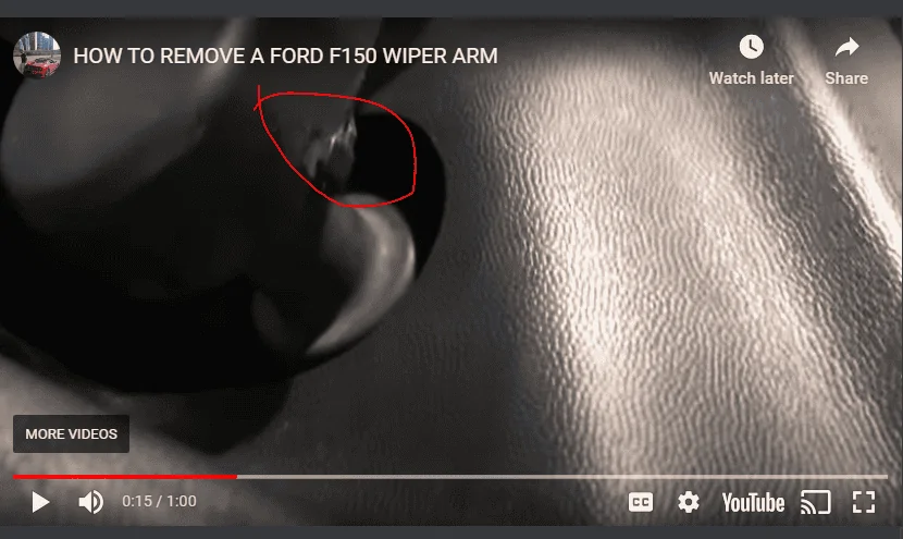

My 21 PB had the same problem after getting the recall done. I just remove it and rotated a little to correct the travel range so it doesn't hit my A pillar. Just make sure you seat it all the way back on the shaft. Make sure it clips back on. There is a YT video on this.
