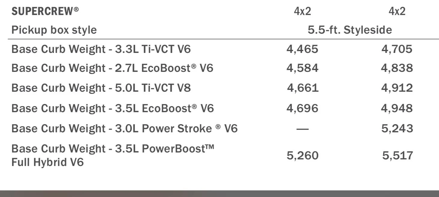

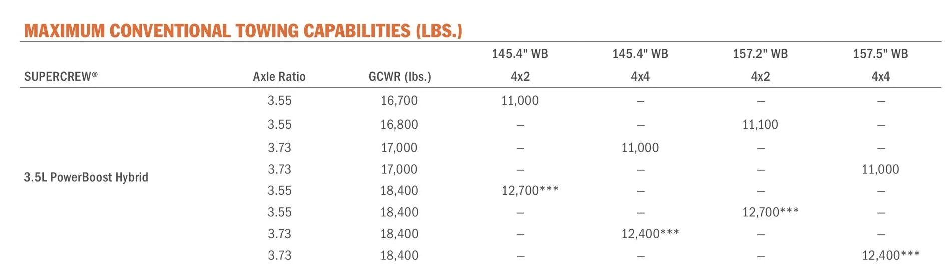

I’m thinking the GCWR is 18,400. If I am reading this chart right. I have max tow.
Ford F-150 Will a PowerBoost w/ Max Tow tow 9,810 lb. telehandler? 36DFEA6A-B839-478A-A051-22A1FA952425
Looks like the curb weight is 5,517.
You're absolutely correct @hevnbnd, my mistake.
18400-5517-12100=783 left over i assume you have to deduct for what's on the truck?
I hope i got that math wrong again as it looks similarly challenging to 'legally' towing. I don't even see how Ford themselves could configure a PB per their guidelines to tow the max 12400.

Yeah I don't think Ford knows either. If you notice that chart of the GCWR it shows 4x2 on both columns even though I suspect since the 4x4 column weighs more it is meant to be 4x4...
If i am understanding correctly I would also need to subtract the weight of my trailer from the 18,400 GCWR. My trailer comes in around 4,500 pounds. If that is correct then I would be looking at
18,400 (GCWR) - 5,517 (Curb) - 4,500 (Trailer) = 8,383 left for the load on my trailer...

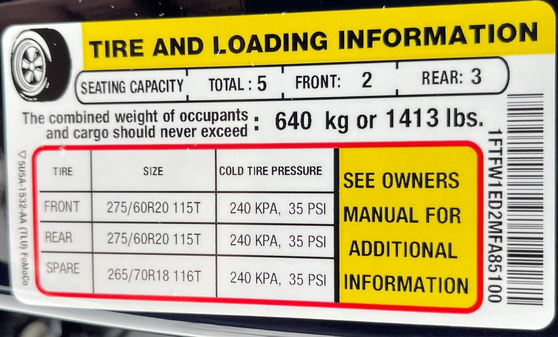

Ford now gives you 300 pounds (150 each for a driver and passenger) in its 2021 payload and tow calculations. So you don’t have to subtract for the driver and if you’re both skinny for the first passenger either... good news though for those of us who were subtracting ourselves before.
hevnbnd
Brian
Dec 15, 2020
38
38
Arkansas
2021 F150 King Ranch
Where did you get this information?
