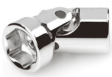

Curious what "tool" you guys used to install the rear passenger side bolt? Something like this?

Perfect, thank you, I have them both!

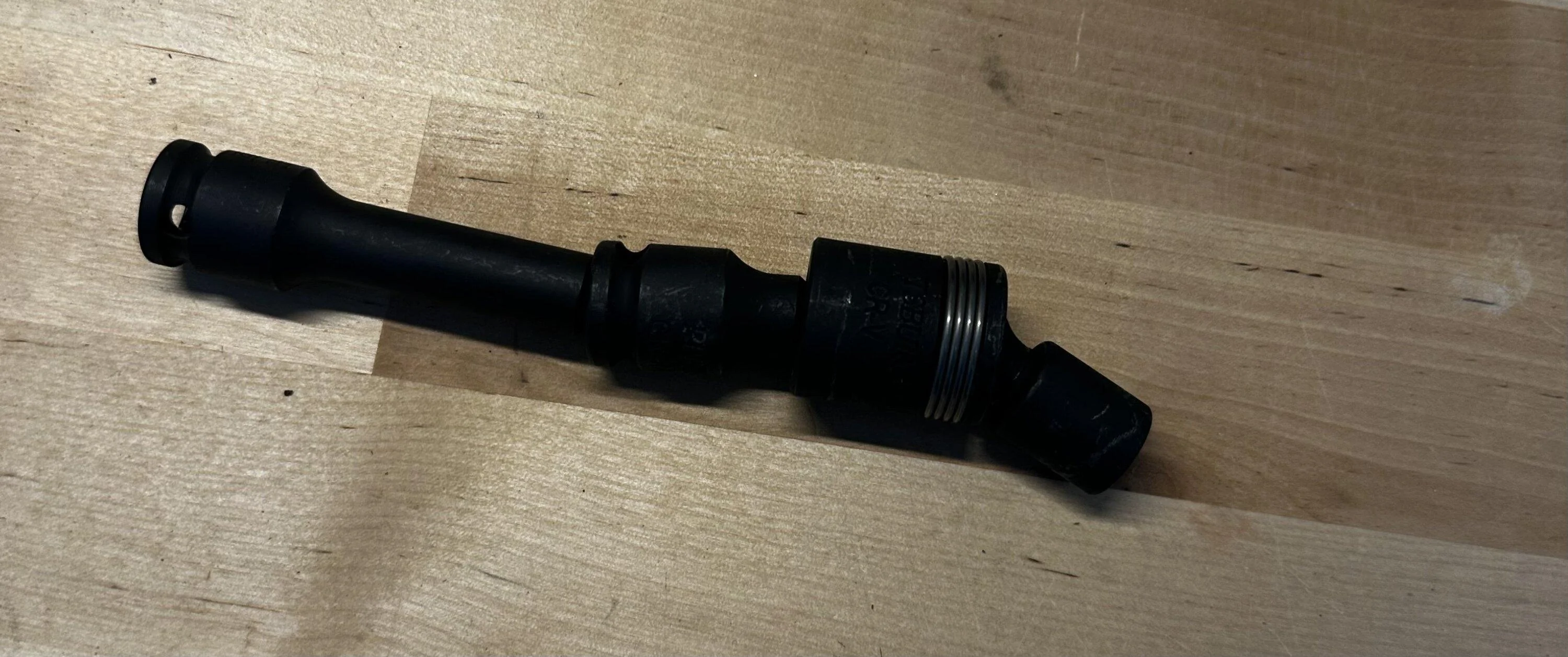

Tried this and more. Ended up with a swivel like you have plus two wobble head extensions
