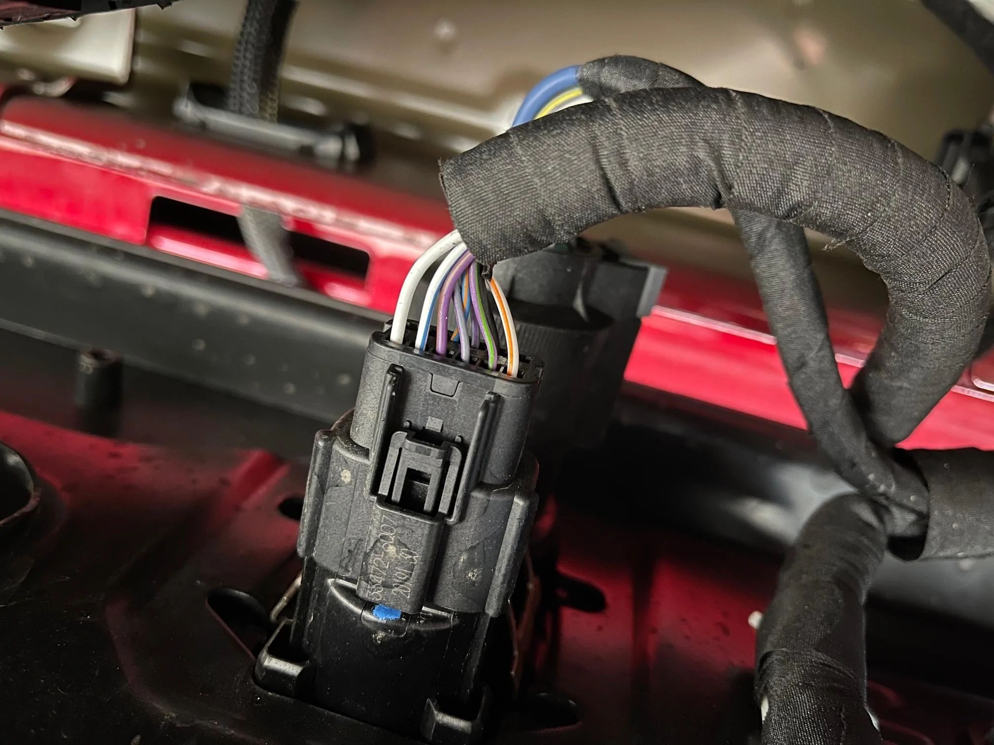

The 12 pin connector on my truck bumper has female pins in all 12 holes, so not sure that helps.
I don't have any cables that connect to that connector yet, as 2022's don't ship with YAW sensor any more, and I haven't order the Trailer TPMS or Cam.
Here is a pic of the back side of that connector (from under my truck). There are 9 wires. The 3 non-existant wires are the same 3 (position 7, 11, 12) that are defined as not used on the Super Duty's.
The net is the 2022 F150 has the 12 pin fully wired. 2 are for the YAW (I believe pin 3 and 4), then 12V power (for TPMS and Cam, pin 1), then 2 for TPMS signal (pin 2 and 3), the 1 for TPMS Gnd (pin 6), 1 for Cam Gnd (pin 8), 1 for Video (pin 9), 1 for Shield (pin 10, for Video)
I'm basing the pin assignments off this PDF someone posted in the SD forums. Again, I don't have cables or anything to try it with.
But GChurch in another post did the whole thing on his 2021 and documented with pics and vids.

BLofin is dead on, I should have included info he shared in my post. if you have a 2021 build f150 you 99% don’t have the correct wire harness needed. If you have a 2022 build (like BLofin) you MIGHT have the right wire harness that supports trailer camera + TPMS. But you need to stick your head under the hitch and take a picture of the harness that plugs in to the smart trailer connector (yaw sensor). If you only see 2 wires going Into the connector instead of the 9 (6 bottom 3 top) like BLofin picture above you will 100% need to swap your harness like I did. Good news is it’s easy, and if you aren’t mechanically inclined you can pay somebody else to do it for you.
From what we can tell it doesn’t matter what build options you chose/have. You’re either lucky or not.
