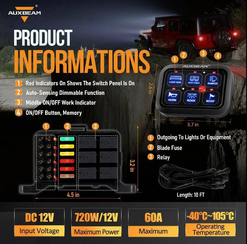

Yeah one is 20amps and below that so ok I'll add the relays, they don't tell you that in the videos-thanks
No! Do not add external relays if using this Auxbeam panel.
You don't need external relays -- that's the entire point of using one of these panels versus a bunch of standard ON/OFF switches and relays (e.g, a 5-blade 12V relay Bosch style relay).
We put these Auxbeams (8-gang) in all our SXS's for all the lights, radios, fans, winch relays, and other gadgets.
The Auxbeam panels have integrated relays - one for each button. With that, each button is rated for up to a specific amount of amperage (see image below).
When you install and run devices:
1. Use the higher rated positions for your devices that pull more amps (e.g, light bar) and the lower rated circuits for things that don't pull as much (e.g., LEDs, radio, etc.).
2. The panel is rated for a total of 60 amps. That means you can run as many of the devices you have connected at the same time as long as the total draw of everything being on/used at the same time doesn't exceed 60A.*
* - On point #2: Don't confuse what each circuit is rated for with how much amperage the devices connected to them are drawing. If your light bar is on #1 and it draws 12 amps, another light is on #2 and it pulls 10 amps, and your radio is on #3 and it's only pulling 5 amps, then running all three at the same time is only drawing 27 amps, not 70 amps.
To determine amperage draw, use a multimeter. Make sure it's set/configured to measure amperage AND you use it properly (inline between the + terminal and the device being power, not across polarity like you do checking voltage).
