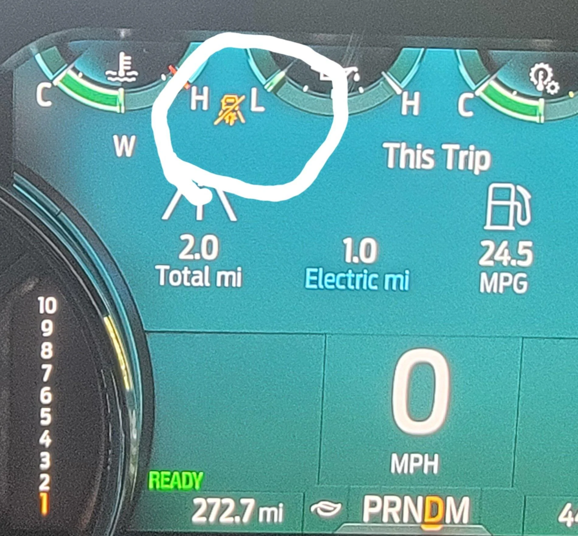

This popped up and I can't find reference to it... yellow between the H & L. Any help??

Page 347 of owner's manual... finally found it. Seems I set something up that I didn't plan on. Stupid fingers! "Pre-collision Assist"

I would imagine if the line is through it that it's turned off.

@Posneut thank you for this question and the answer. I had this same symbol pop up on my dash while idling on battery with the AC on. Couldn't find that anywhere in the manual.
Weird that mine popped on while I was just sitting in a parking lot but so far it hasn't appeared again. I don't think I was changing anything in the dash, but I had been sitting waiting on the wife for a bit (Without my phone :( ) so I was going through the settings. Must have hit something unintentionally.

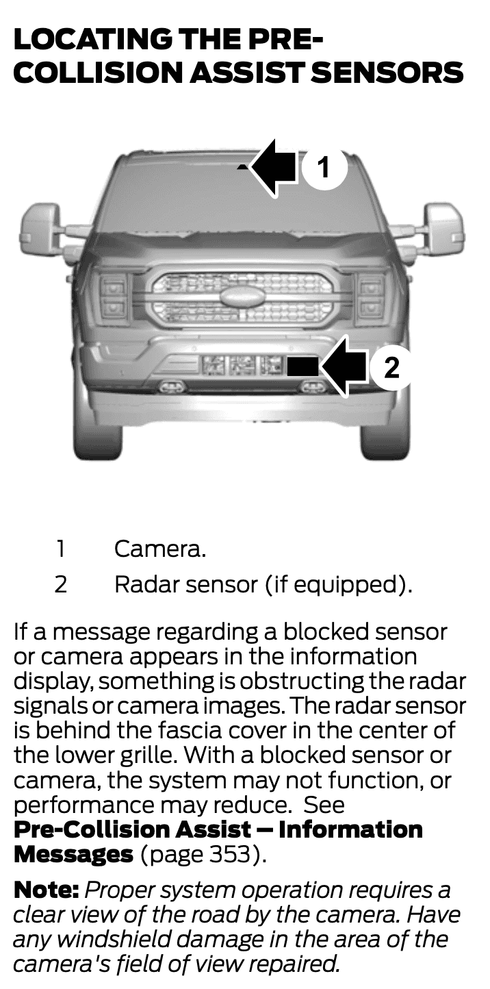

My instruments look a little different, but the underlying systems must be the same. I've seen that little helmeted guy swinging two swords … usually a dirty windshield or mud on the front bumper. It doesn't seem to mind snow packed on the front bumper, but the camera needs a clean, clear view (sun glare is enough to blind it.)
Along with mirrors, turn signals, headlights and taillights, these are the two spots to clean during refueling on a road trip:

Ok, so I just went out to my son's truck and turned the Automatic Emergency Braking System on and off several times and that light came on and went off accordingly so I now KNOW what it is and that is it.
