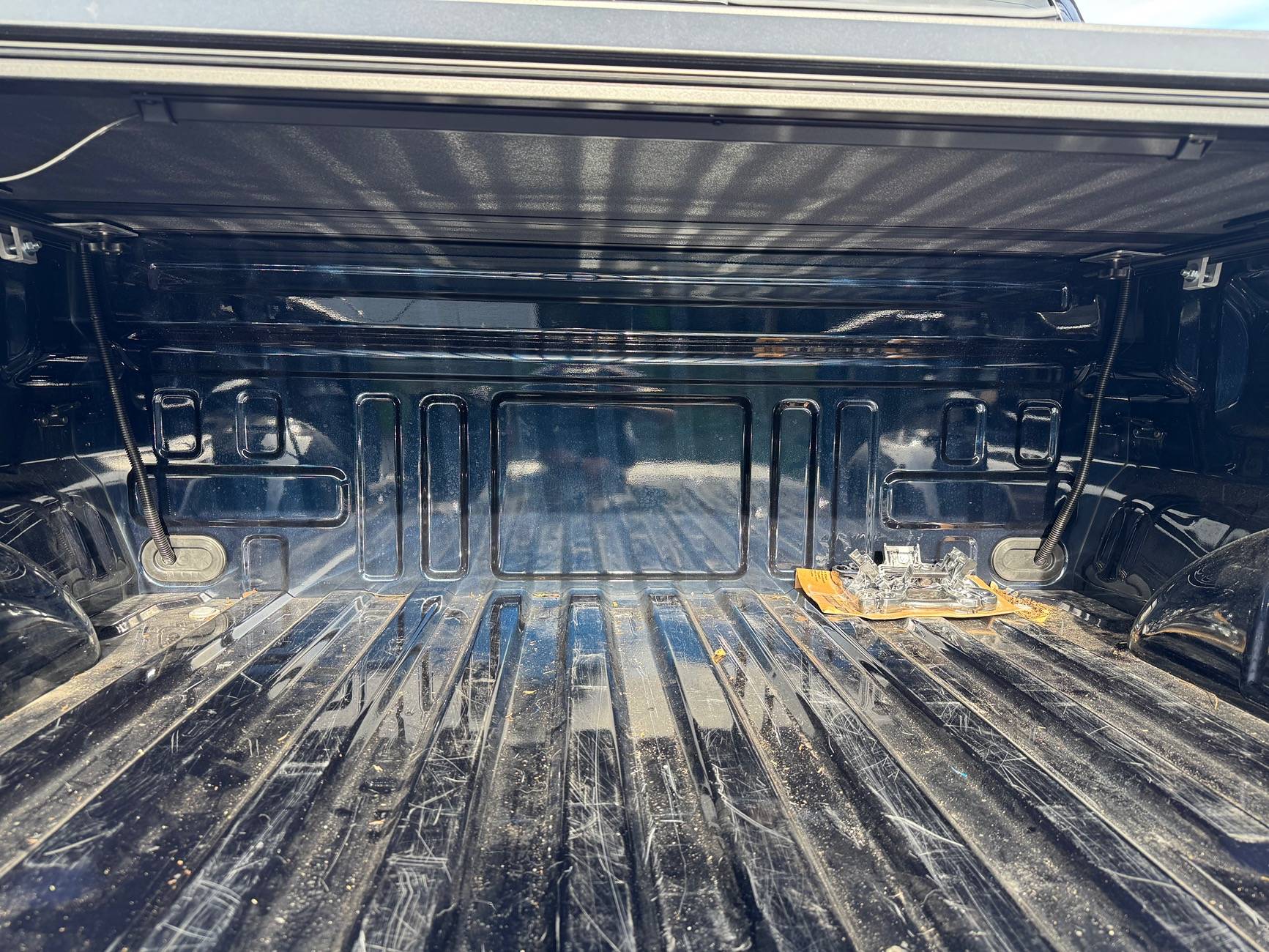

Not sure what these hoses on either side of the bed are for. Its a OEM Ford tonneau cover on top.

They look like bed cover drain hoses. They may direct water that collects on the side rails to drain under bed.
