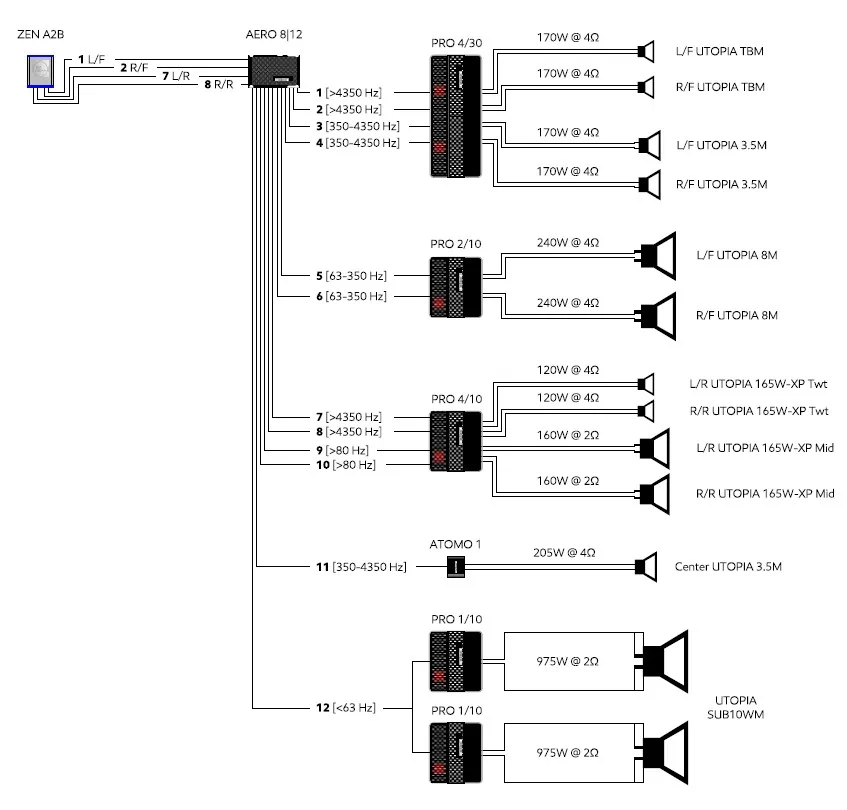

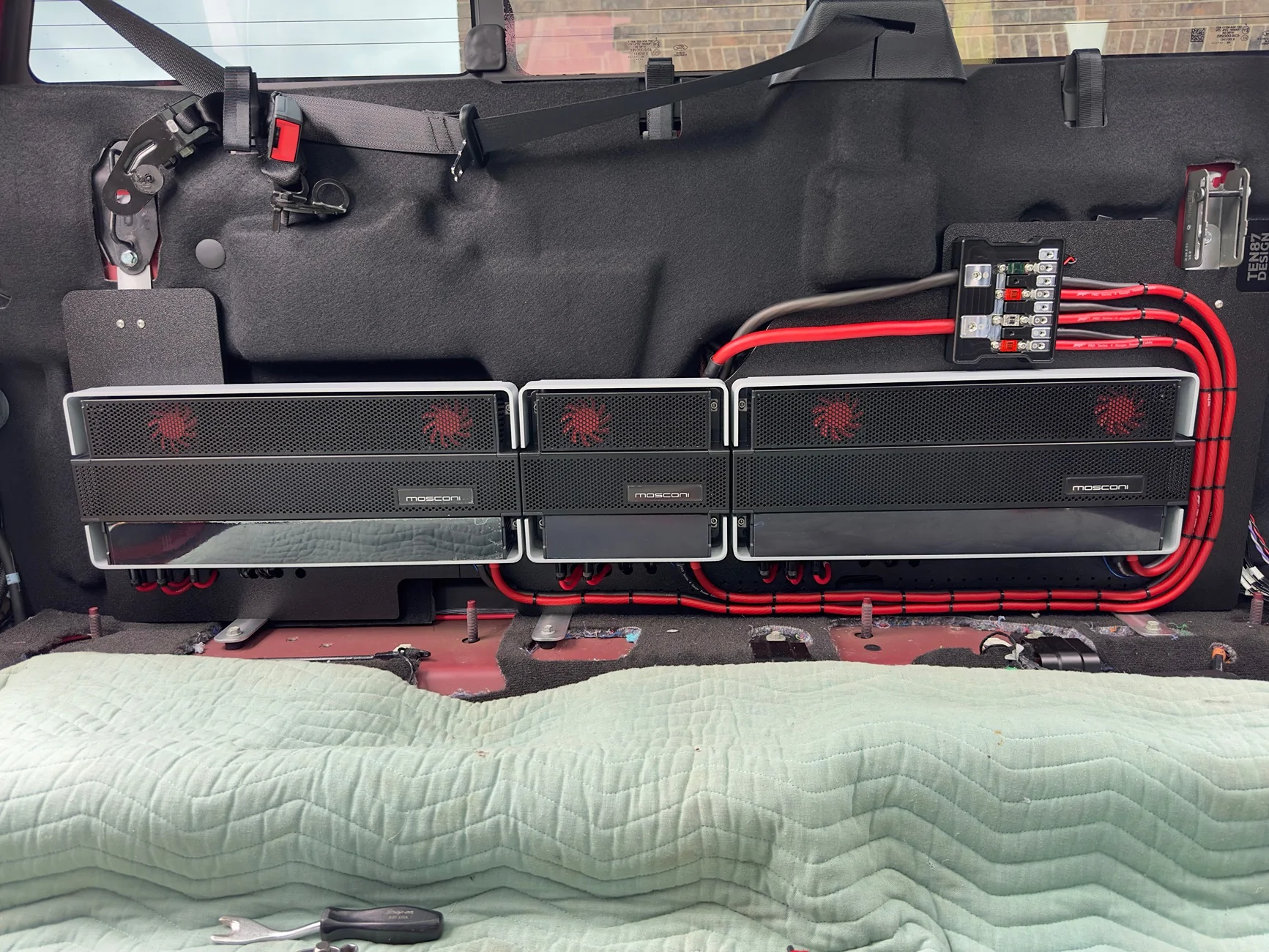

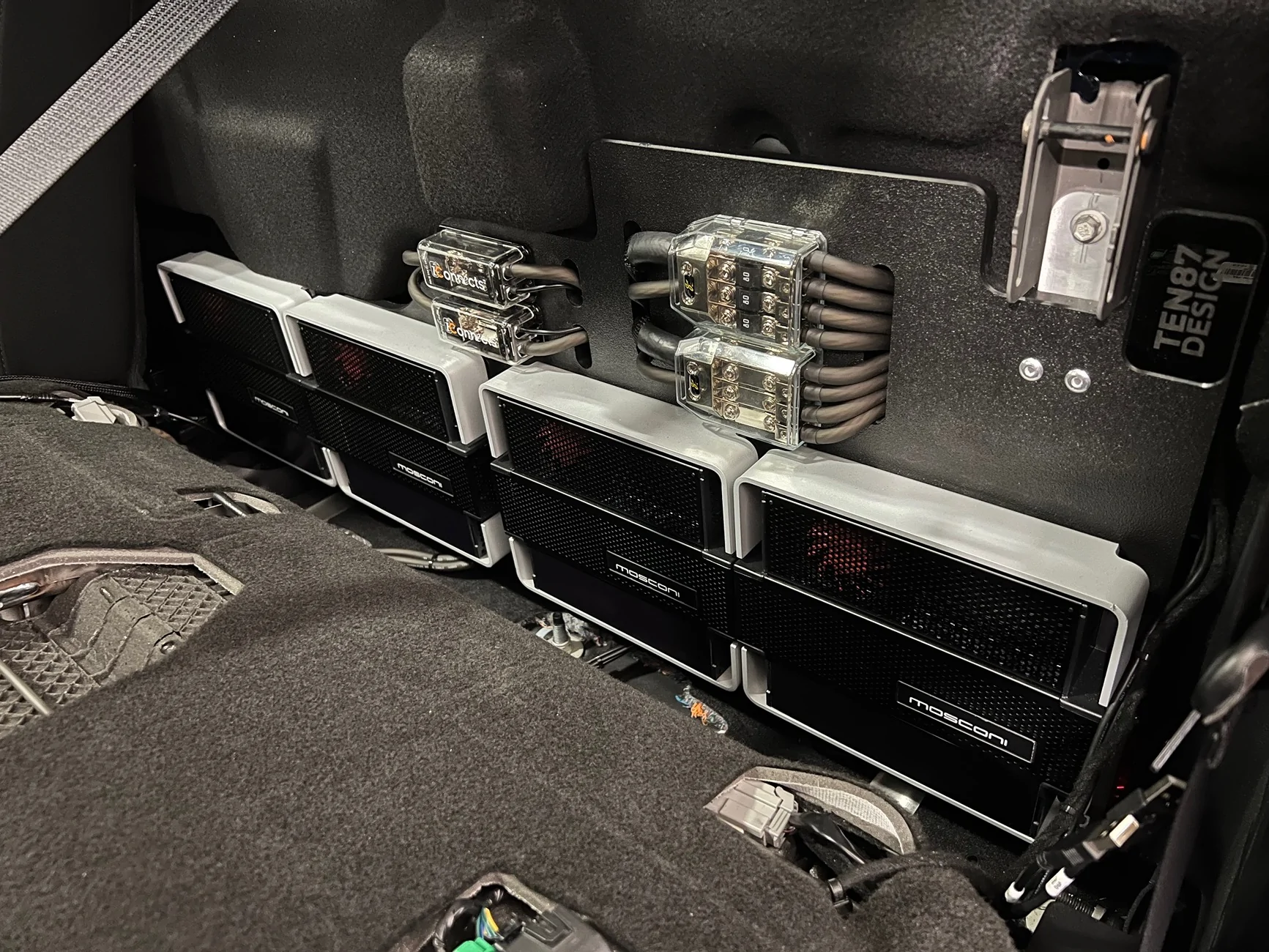

Both pictures are the same truck?
Which amp for what speakers?
Yes it's the same truck. It's an R so it has more space to work with under the rear seat. The Mosconi Pro 4/30 is mounted on the floor under the rear seat behind the subwoofer box. It drives the Focal Utopia 3.5 mids and TBM tweeters mounted in custom A-pillars. Mounted on the rack behind the seat is a Pro 2/10 that drives the Utopia 8s in the front doors, a Pro 4/10 that drives the Utopia 6.5s and tweeters in the rear doors, and 2x Pro 1/10s each wired in parallel to drive one Utopia 10 sub. Not pictured on the back of the rack is an Atomo 1 driving the 3.5 center channel. The headrest and roof speakers are disconnected. All work done by Sounds Good Stereo in their shop outside of Nashville.
