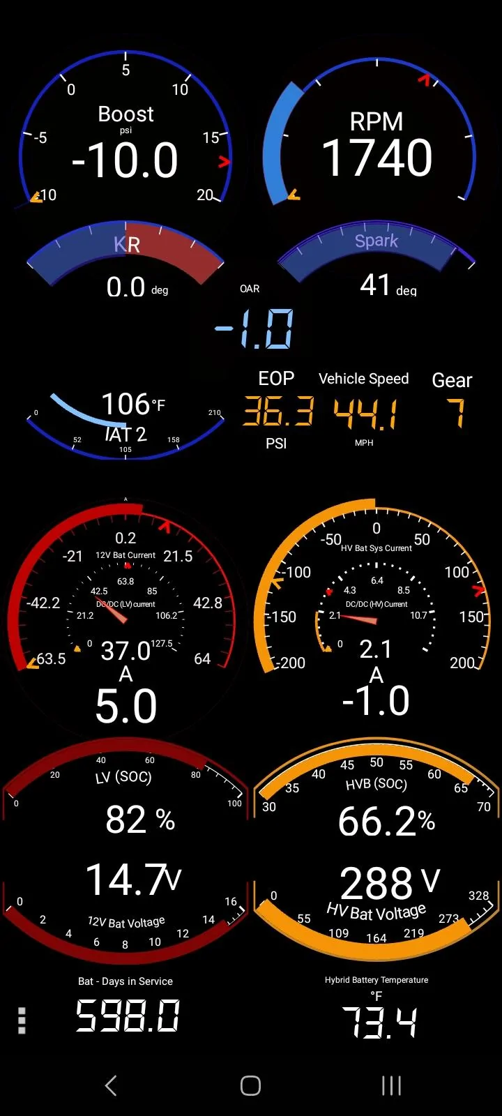

Thanks for the flattering words, and I do believe there's considerable overlap in what I'd monitor if I had the coyote VS the 3.5 Ecoboost.
Obviously you don't have to be concerned with boost though. ?
I imagine the PID mapping to gauges will not match though, so importing someone else's dashboard will likely require you to manually select the PID you point each gauge to.
Here's what I monitor:
Top half are all ICE gauges
Lower half are electric.
Red electric is low voltage
Orange electric is high voltage
